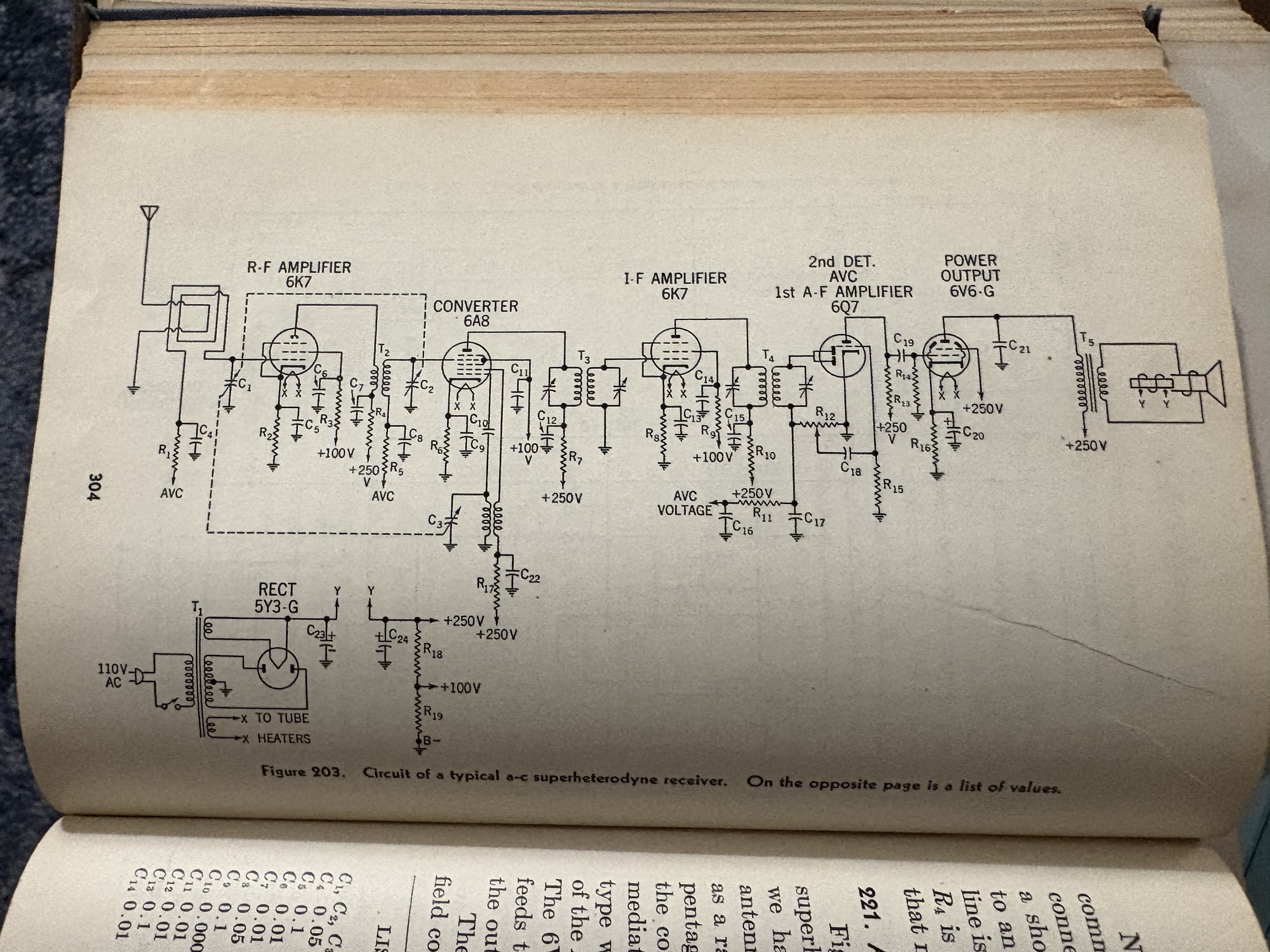

I’ve consulted a couple of the books which I got from Jim Koehler, Elements of Radio Servicing (Marcus and Levy, 1947) and Elements of Radio, Second Edition (Marcus and Horton, 1948). It looks to me that my Philco 46-480 has the AVC bus connected to the screen grid, the output of the preceding IF transformer connecting to the control grid, and the suppressor grid grounded. It seems a close design to this textbook example of a 1st IF section, except that this example only connects the screen grid to a fixed 100V rather than to an AVC bus.
And, just as I discovered and corrected on my own schematic, the control and suppressor grids are no connected together.

Wasn't that the Suppressor grid that we were talking about, that got connected with the AVC?
Anywho, the initial question was, could the Control Grid be connected to Suppressor Grid?
To me the answer is, no it shouldn't.
RE: Philco 46-480 Electronic Restoration - jrblasde - 03-14-2025
I agree, the two should not be connected. Due to poor image quality of the original Philco schematic, it was unclear if the design intended to connect the two. Had I thought about it more deeply, I would have realized that they shouldn’t be connected. But, at the time, I suppose I was more focused on trying to interpret the original schematic so that I could reproduce it.

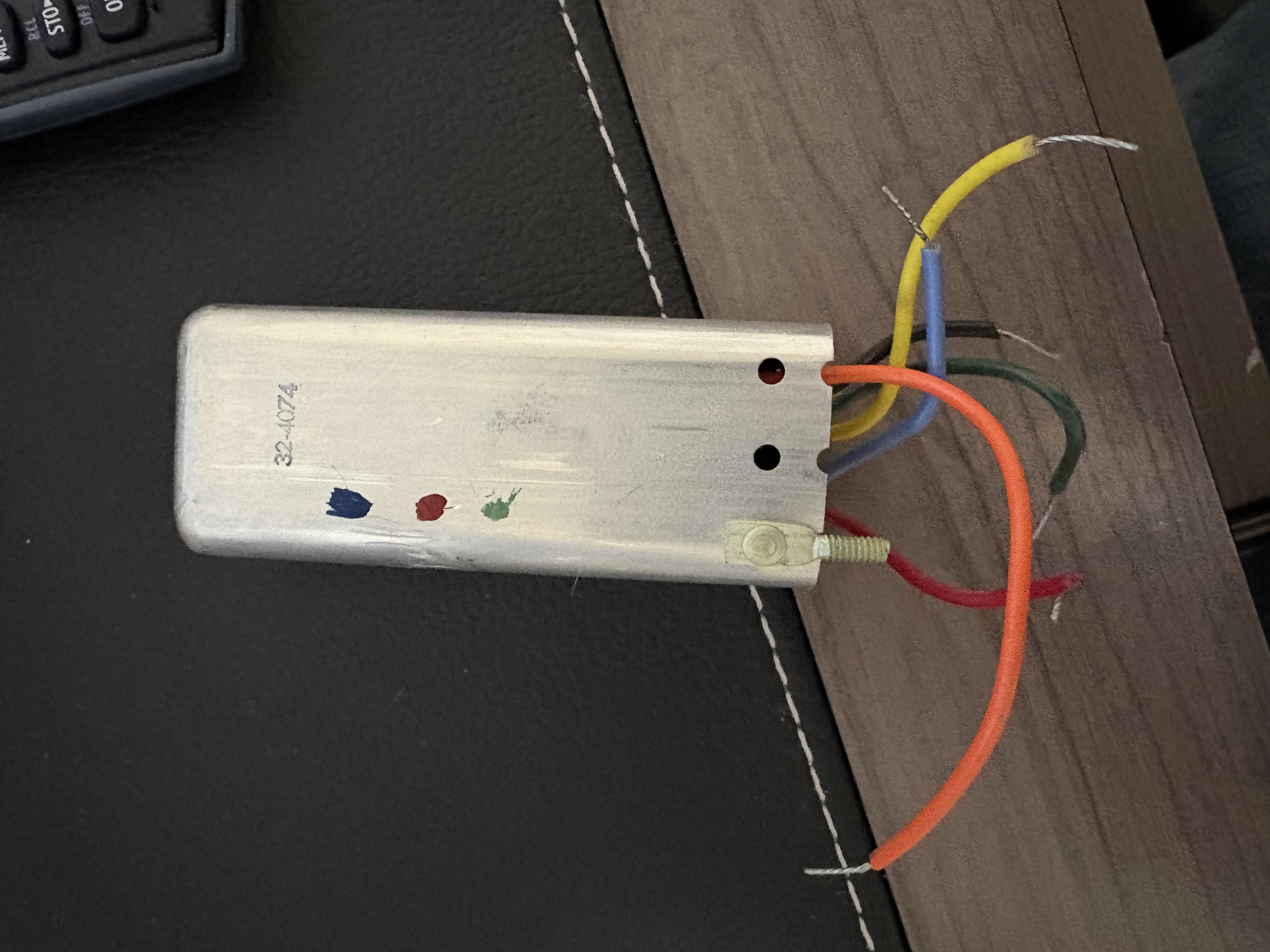

I am almost finished with this restoration. All which remains is the power transformer. I cleaned it up some time ago, but never did purchase the sleeves to cover the cracked insulation of the high side wires. I had tested it using normal heat shrink (rated for 600V), but the high side is 640V nominal. Yesterday morning I ordered some 11 AWG fiberglass spaghetti style sleeving, rated up to 7kV, from Antique Electronic Supply. It should arrive on Wednesday. I had two choices--either 20 AWG sleeving or 11 AWG. I have some of the 20 AWG on hand, but it's too small. Even if I were to strip the original insulation off of the wires, I think they are 18 AWG. My thought is to leave the insulation intact, and cover it with the 11 AWG sleeve. Should fit just fine.
Here's my progress from the last week. I finished the push-button assembly, I wired in the 32-4074 IF transformer I had received from Mark Oppat, and completed the audio output section. I replaced the brittle wires on the cord for the speaker, and installed a new AC cable with a polarized plug. I reworked the power supply to include a 1A fuse on the hot side, moved the on/off switch to the hot side, and moved the X1Y1 line filtering capacitors downstream of the switch so that they are de-energized when the radio is powered off. This is all depicted in the Rev 1 version of my schematic.
