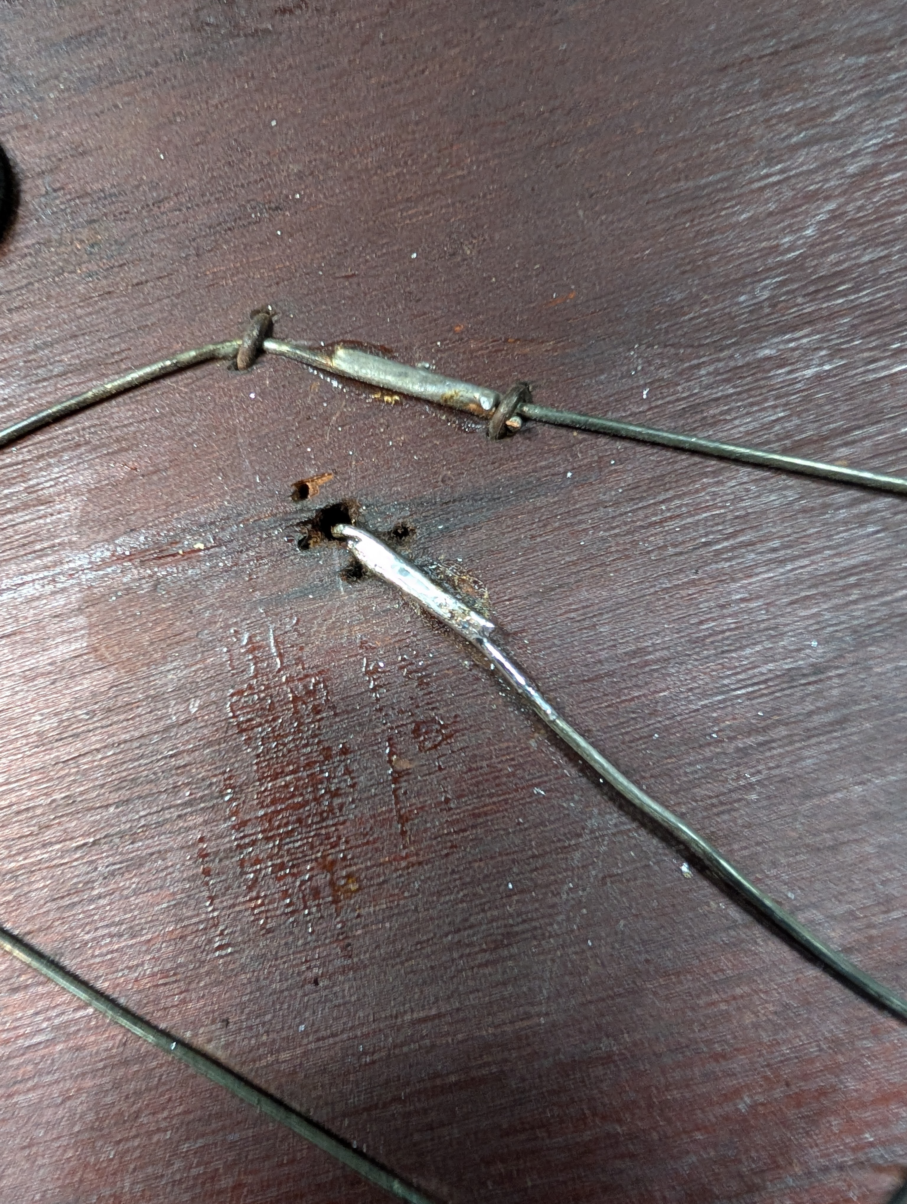

Started soldering the "PCB" back together.
It could be simple or it could be as complicated as one makes it, and I am not in the habit of choosing easy roads to success. I am a man from Russia after all.
So. I obviously do not want smear the board with rosin residue; plus the rosin is corrosive ...wait, am I writing poetry here or what?
I need to rhyme it with "explosive."
Anywho, so I do this:

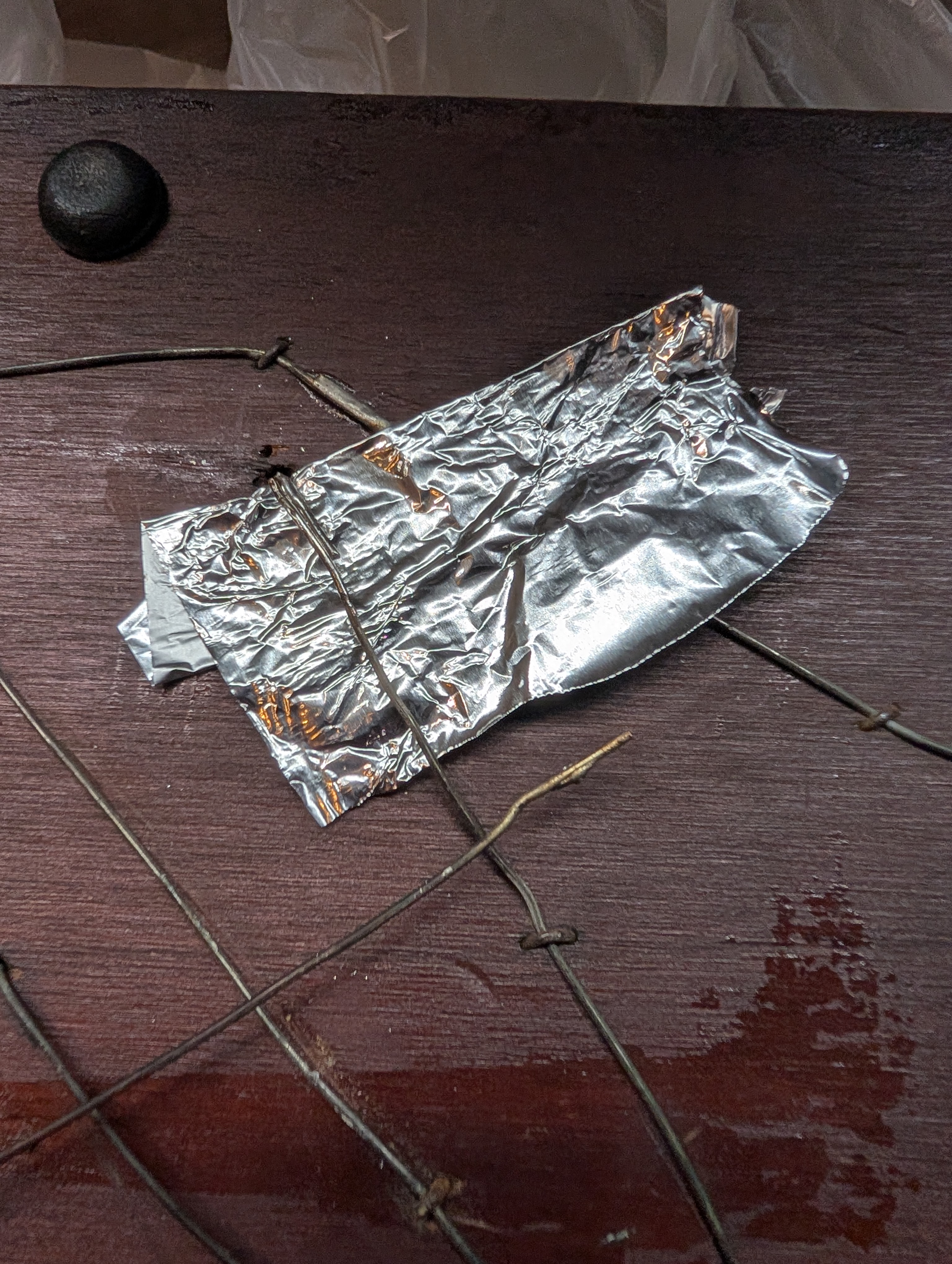

I take some aluminum foil and put it under the wires to be soldered.
Oh....and I have to hold the wires together, which is a tall order, considering using my bare hands means burnt fingertips.
I use a bamboo skewer or a piece of wood to press down on one wire (the other is in place). Prior to it I have to scrape the wires as they are really oxidized and do not take the solder well even with rosin core.

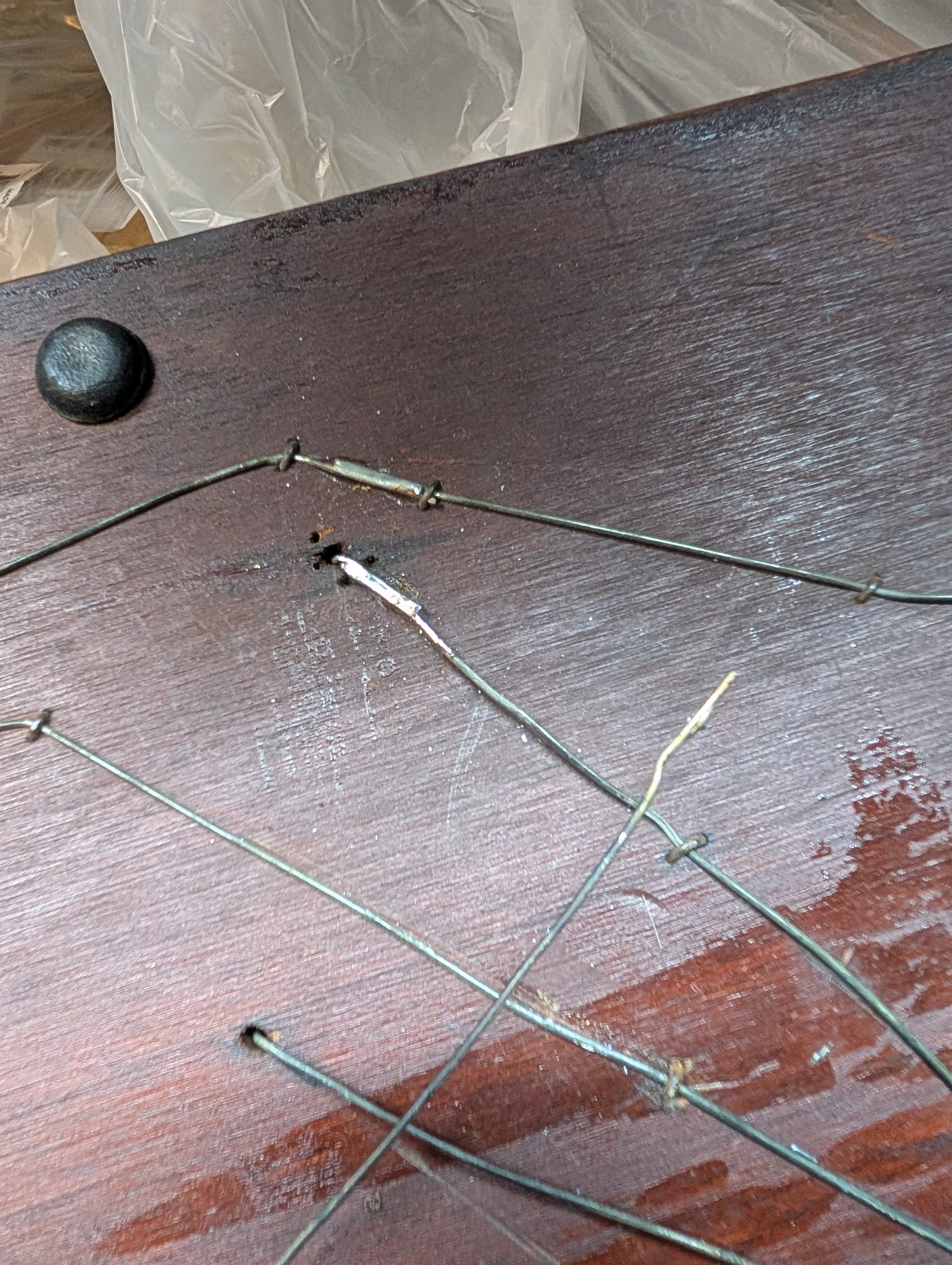

The result is like this:

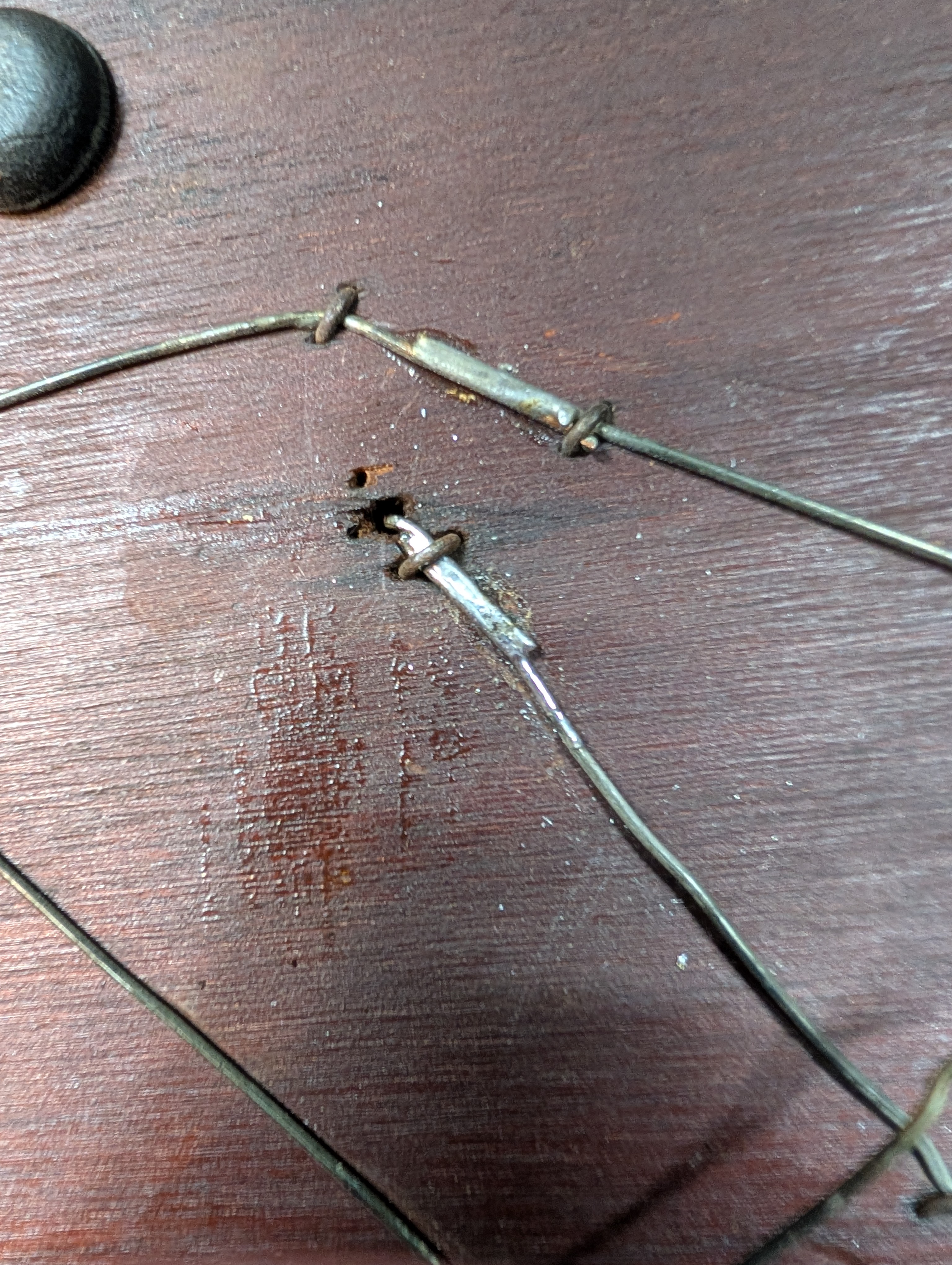

And then the original stape goes in.
Above the new solder is the old one. It will do.
