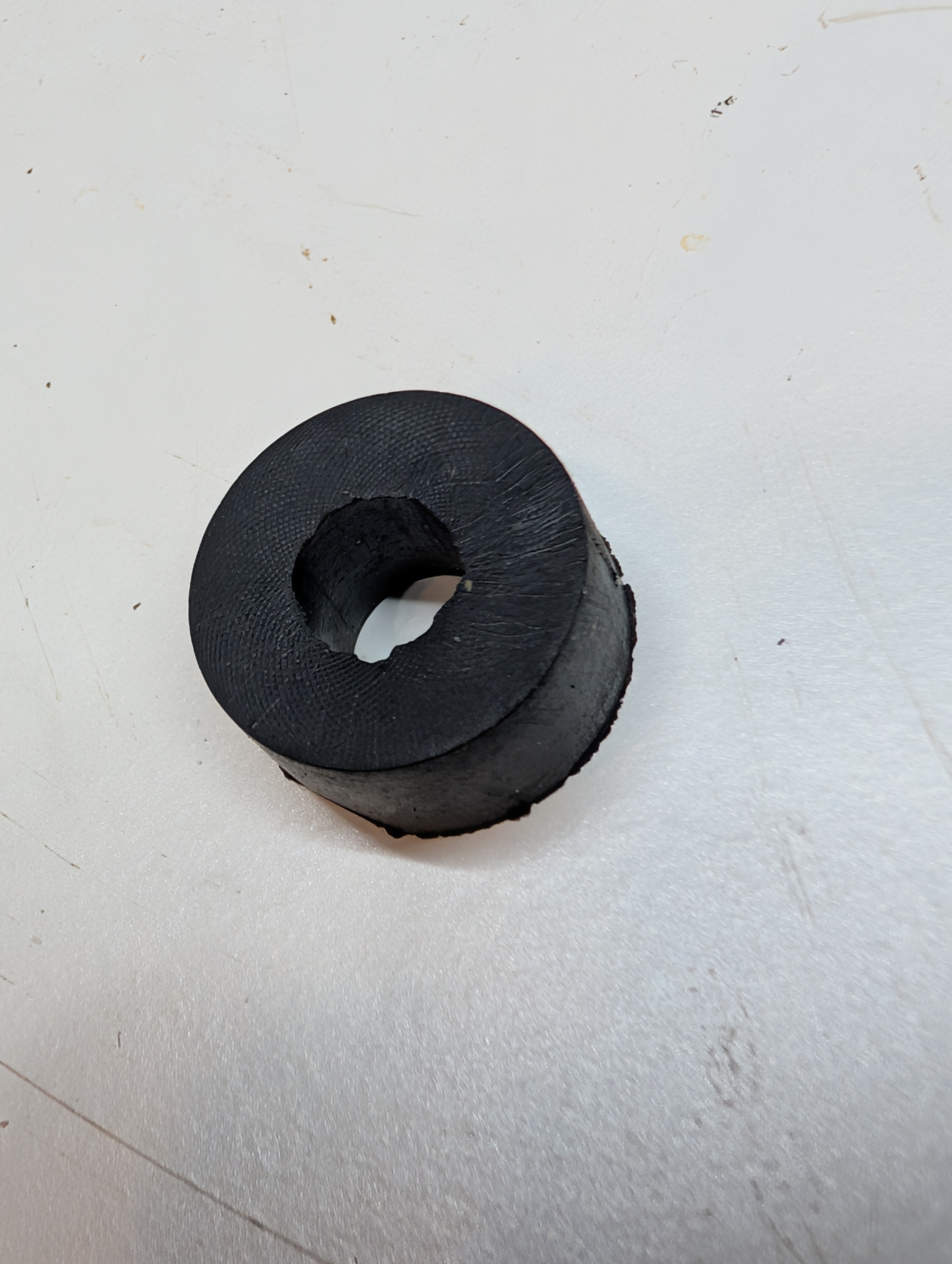

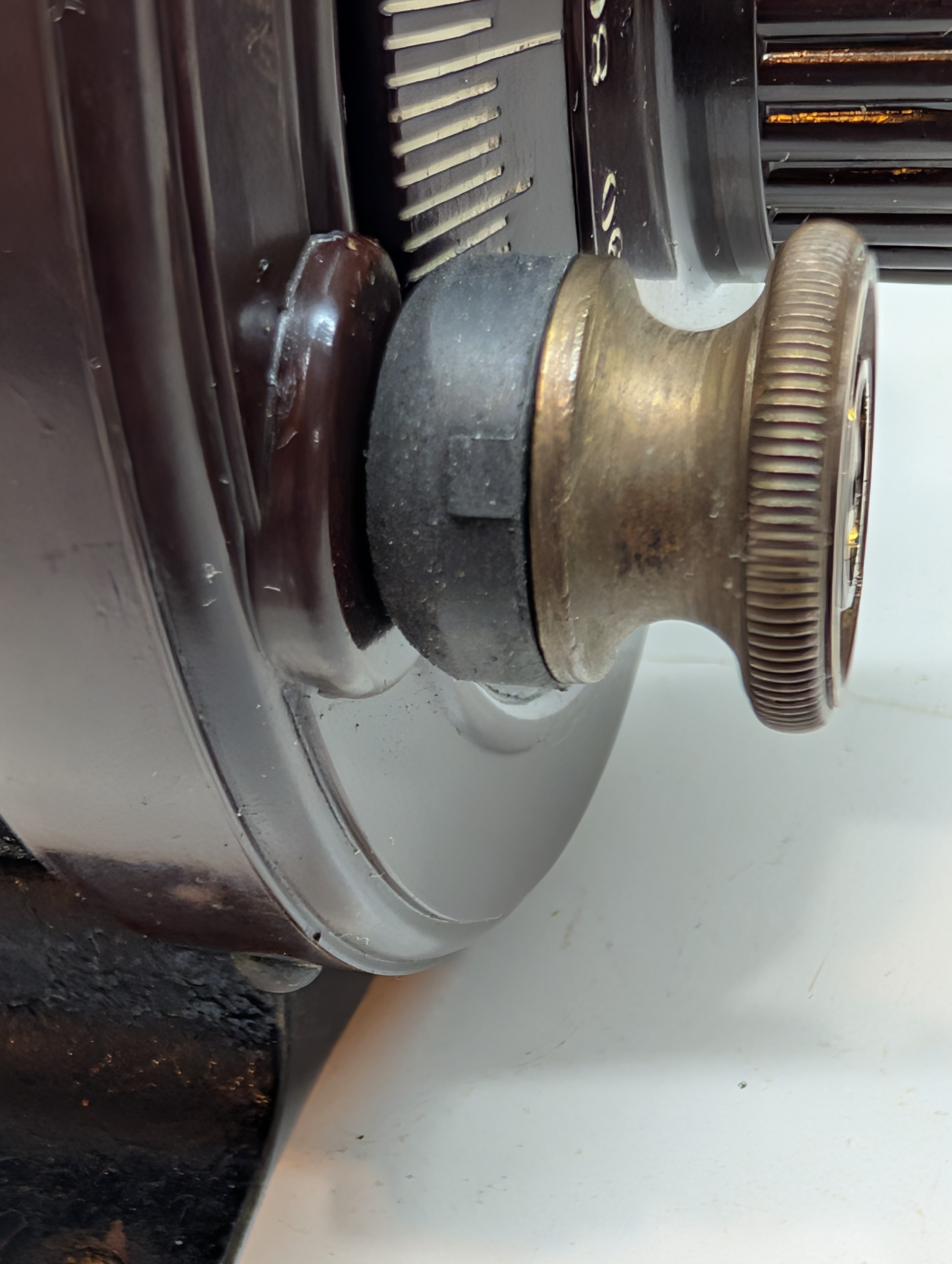

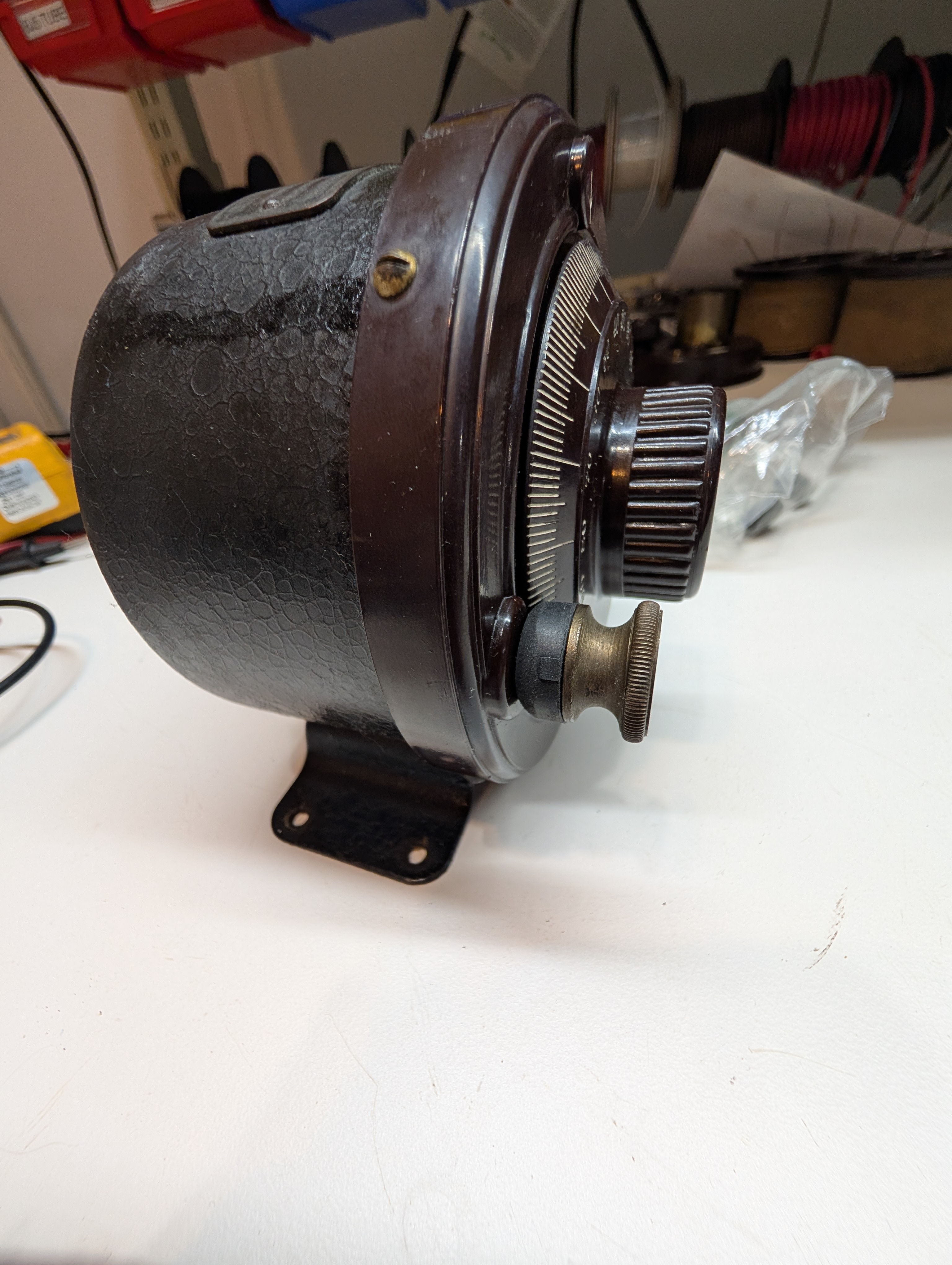

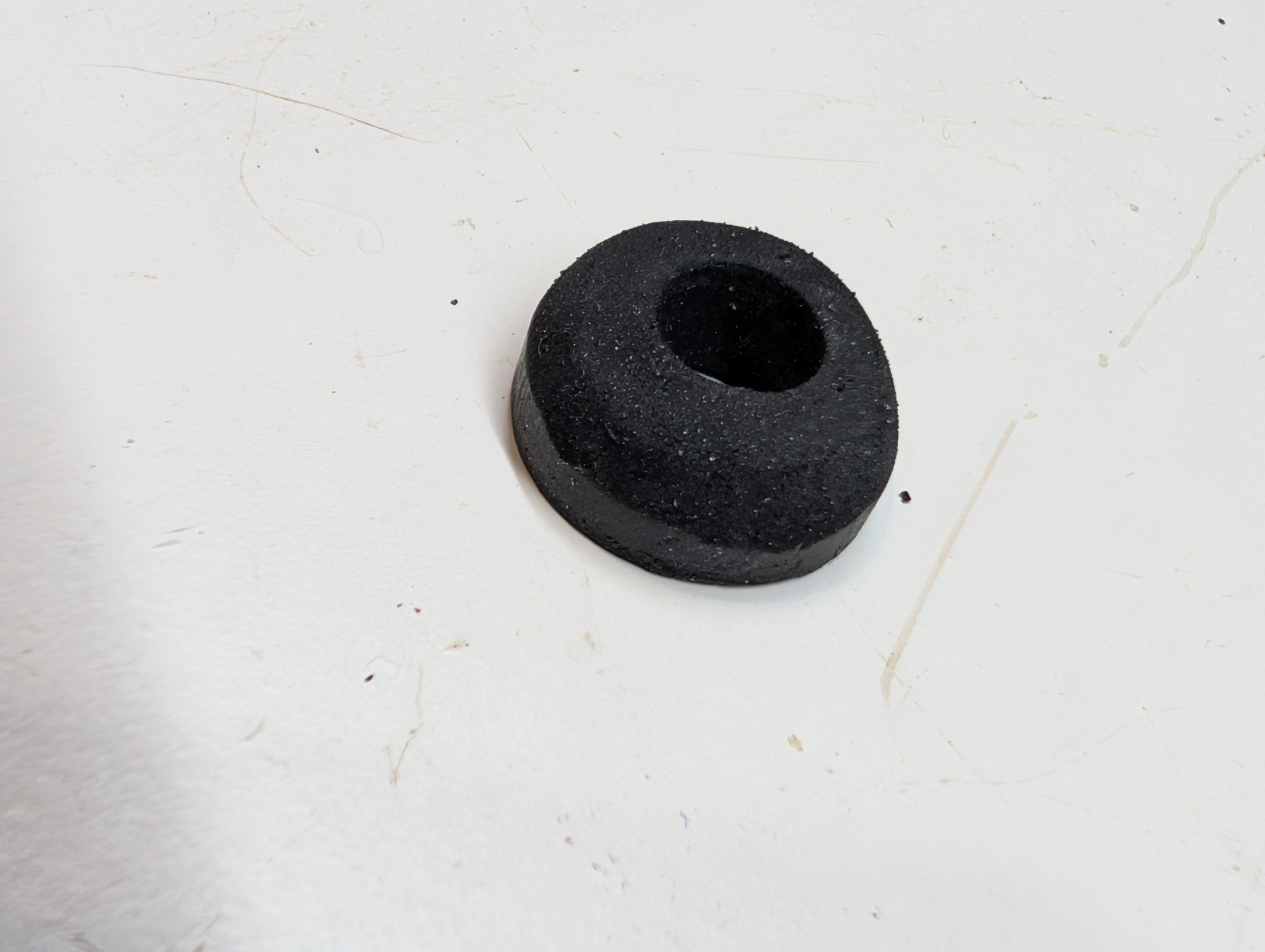

O this is the way I made the tires for the tuning caps.
I had no luck finding something that looks like what it should look like and works.
I also am not sure if the tire should engage when the knob is pushed in, in order to the dial to be able to rotate freely otherwise for fast tuning, or stay engaged all the time.
All grommets that look similar and could be cur in hald to resemble the original are either too thick, or too thin, or have the inner hole diameter too large.
I liteerally spent hours on the web.
Here's what I came up with eventually.
I bought rubber bushings ID=7mm OD=16mm  Height =8mm, made by PATIKIL, sold on Amazon. This is the only size that is close enough.
The original tire (dried up) is ID 8mm OD 16mm Height 5mm.
So then I took the bushings to a grinding wheel and just took 1mm off first. Then used sandpaper to round the edges.
This proved too much. When the screw holding the knob was tightened, the bushing pressed onto the dial so much the latter could barely be turned.
So I took another 1.5mm, again, took some of the walls at an angle to make a cone, and then smoother the edges with sandpaper.
Works fine. One is engaged all tthe time but rotates almost freely; the other two need to be lightly pressed upon, and this is my understanding this is how it should be in order to be able to fast-tune.
This is the bushing
This is the machined bushing.
This is the knob and the tire assembled.
And the whole thing
RE: Starting on Ron's AK10-A - MrFixr55 - 03-05-2026
Looking really nice! The verniers engage only when pushed in; they were used on all the other early A-K radios including the Model 20, 30 and 40 series and possibly later. I think that the friction material was cork, but your fix certainly will work!

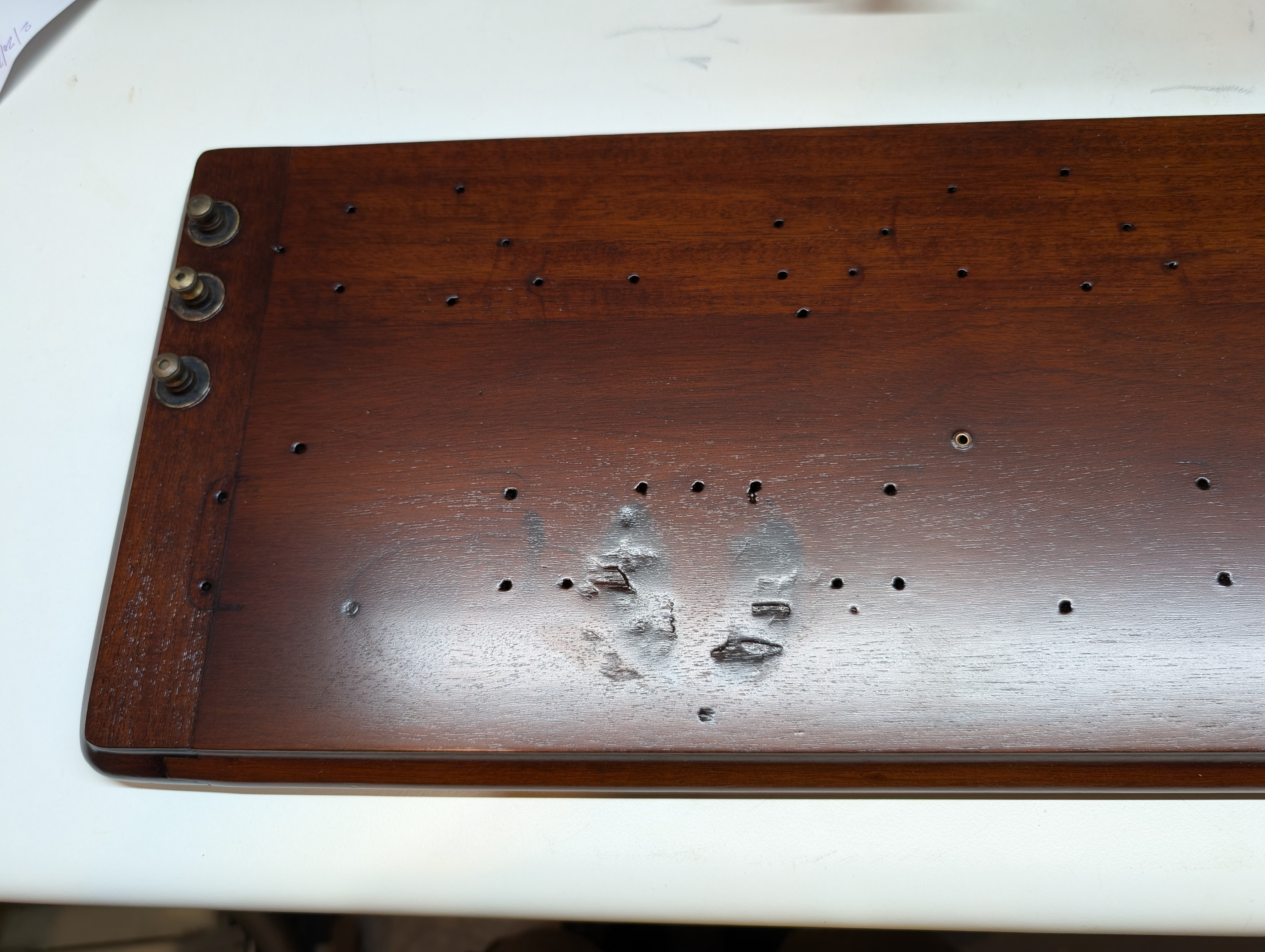

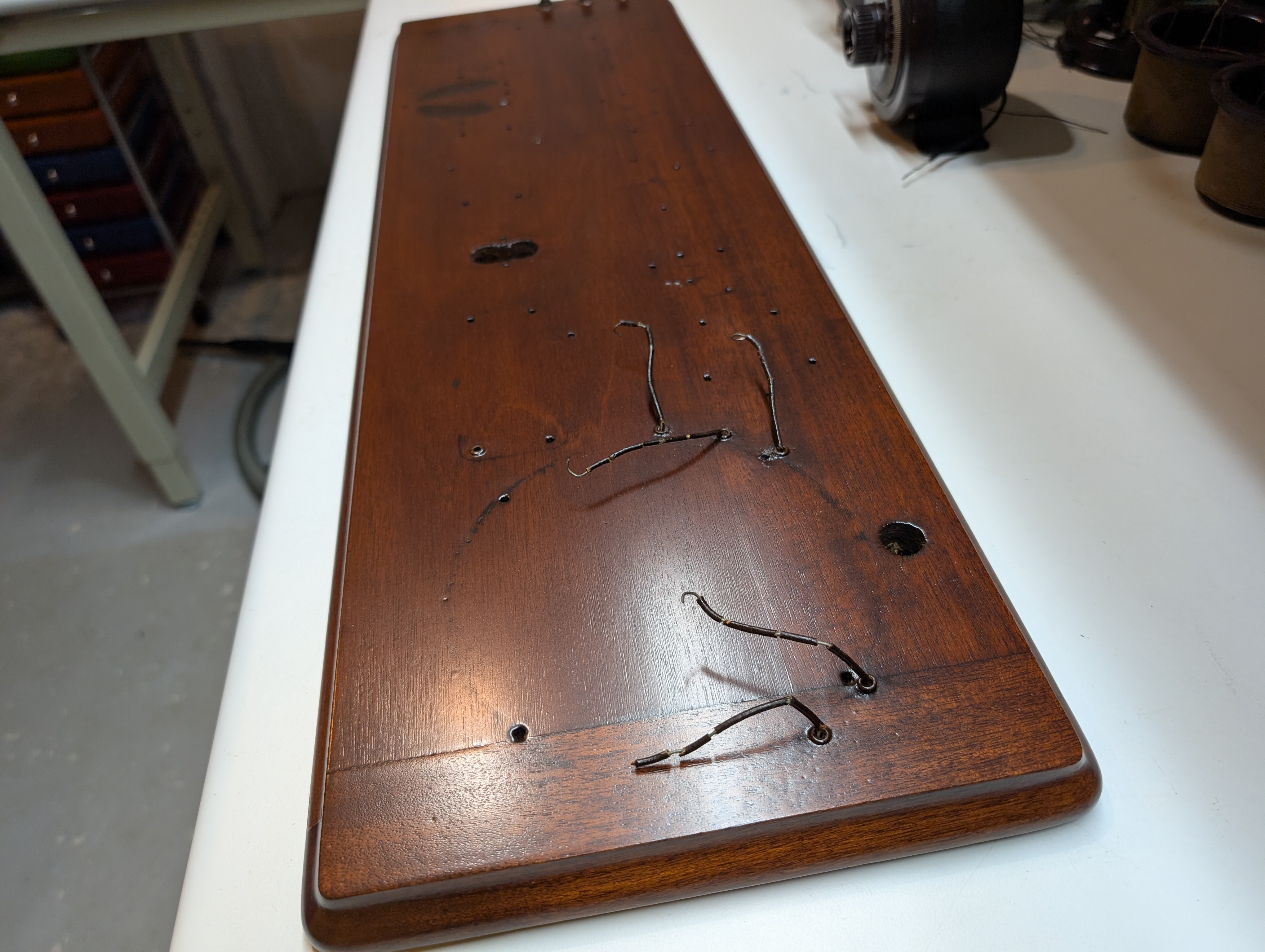

So, yesterday I picked up the refinished board. Here it is.
Semi-gloss finished.
The burnmarks have been there before. Probably factory defect. Will be covered by the parts under which they were found.
Tomorrow will start putting parts back.
RE: Starting on Ron's AK10-A - Arran - 03-20-2026
Mike;
I hope they didn't waste too much time in trying to get the burn marks out. Even wood bleach has a tough time on those.
RE: Starting on Ron's AK10-A - morzh - 03-20-2026
They didn't. I specifically told them not to, as this is concealed under the potentiometer.
