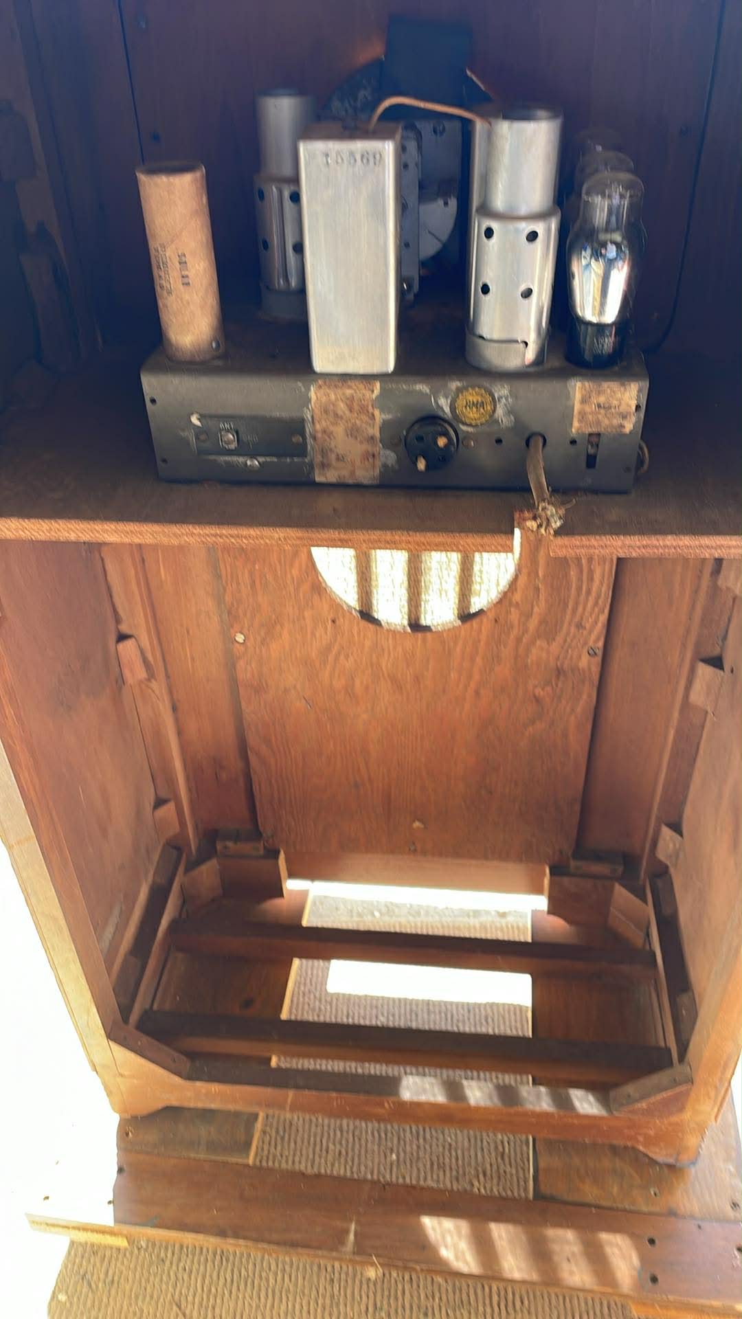

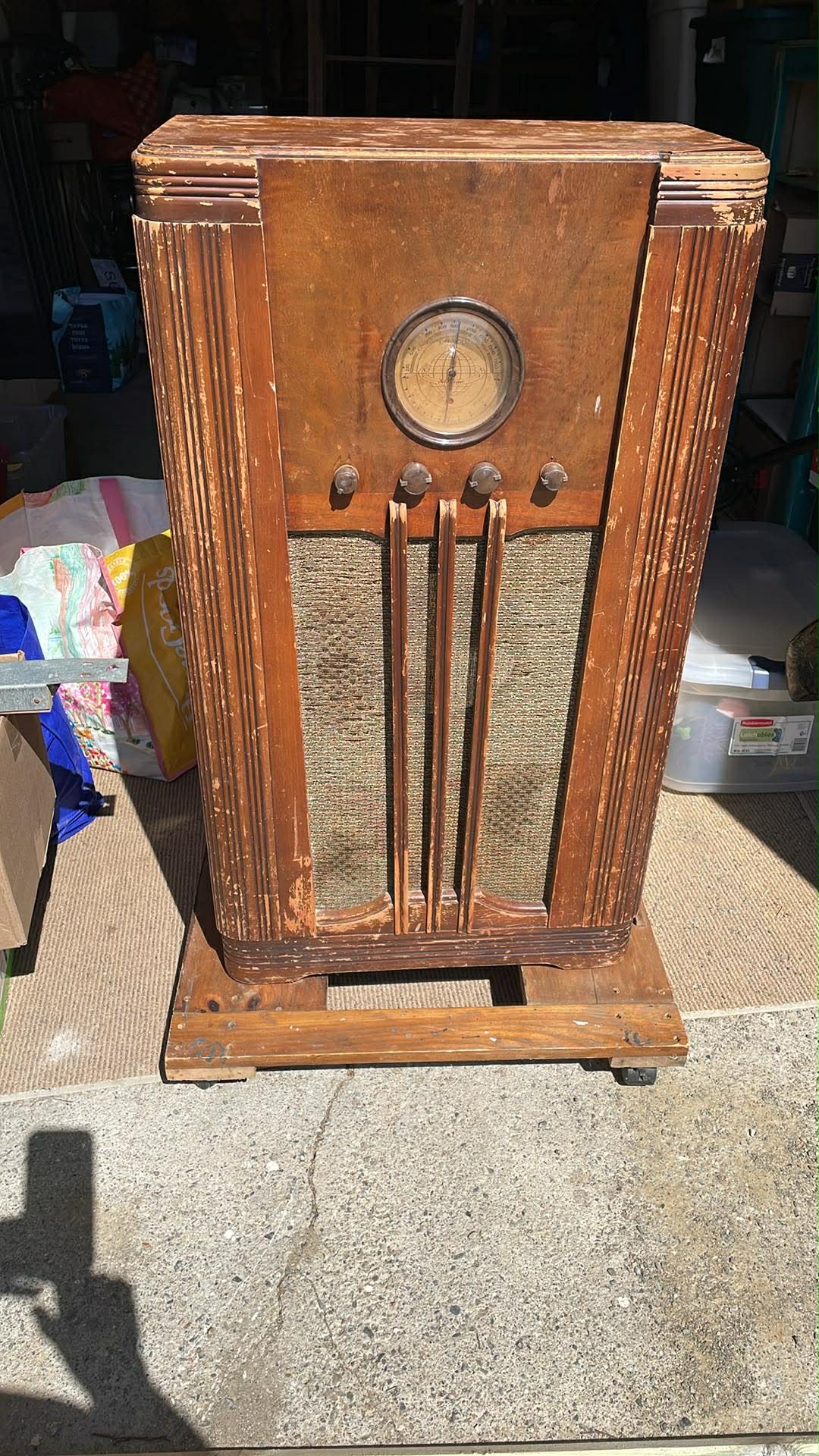

I'm hopefully going to look at a different radio (from the one in the title) later today (one of these) but the seller also has most of a Silvertone 4577 that he wants to part with as well.  It's a console model, and from what I can tell, the 4577 is one of those battery-operated jobs that seem like so much fun to power these days.  It is missing the speaker, so it's basically just the cabinet, the finish of which is a little rough, and only the chassis.
I have no great desire to get this Silvertone, and as I said, I understand the battery-operated models seem to be their own special ball of wax, but it's also interesting in that there doesn't seem to many records about this model.  Radio Museum doesn't have a single photo, though I did download a copy of their schematic.
Is it just an unfair impression of mine that Silvertone as a product of Sears is probably a lower-end model in the first place?  Given the missing speaker, if I were to try to get this fixed up, would it make sense to adapt this to a newer, permanent magnet one?  Is it not even worth the effort with this chassis, and maybe just try to upcycle the cabinet?  It is at least structurally sound from the photos - the owner wanted to put shelves in it and make it a rolling bar cart.

Too many "ifs" to put any money into it and there's considerable time spent getting it to the point of applying power. Having the replacement parts on hand would be a starter. Then once you have it running you have an unknown Silvertone. Maybe it'll look good sitting in a corner after cleaning up the finish. And push buttons, how many does it have?

No push buttons on this model.  It's a 1936.  The dial is actually I think one of the nicest features about it, in that it still looks pretty good for its age.  The cabinet is rather plain, but again, looks structurally sound.  That's why I was thinking if nothing else, it might be a good option for a modernization.  Certainly the details on the cabinet would make for good practice for woodworking/refinishing.

In answer to your question, yes you could put in a more modern, or vintage P.M dynamic, you may need an output transformer for it though unless it's mounted on the chassis somewhere. Other then the speaker it looks like it's fairly complete, and in decent shape, and one advantage with a console battery set is you have all the room in the world to house a power supply. Here is the schematic from Riders, posted on Nostalgia Air: https://www.nostalgiaair.org/pdfs/Sears-Roebuck-and-Co/Sears-Roebuck-and-Co-4577.pdf
It's kind of an off one in that it has a 1E7 power output tube, but the two sections are run in parallel rather then push-pull. It's also interesting that it requires 4.5 volts for the tube filaments rather then 2 volts, B+ is only 90 volts, no 135 volt tap. Anyhow there is no rush to do anything with these old sets, put it aside and keep it for a later project or maybe offer it in trade for something more of interest? Bluetoothing or "upcycling" just turns a vintage item into dumpster fodder for later.

Re "Resto-mod, or Wreck-o-vation, I would not recommend the gutting of the radio chassis. The chassis is relatively easy to convert to utility power by building the appropriate power supply. Any 8" speaker will work, but a high compliance one would be best. Your biggest issue will be the output transformer. The 1E7 tube is generally run at 135V, in push-pull through an output transformer having a plate to plate impedance of about 24,000 Ohms. I think if you can find one at around 12KOhms, you will be OK. Alternatively, you could install an aux output jack and use the radio as a "tuner" to drive a hidden "Middle Kingdom" mini amp. Just make sure that any mod could be easily undone. For example, If you want to add a stereo amp and speakers, make a new baffle board and remove but preserve the original. The baffle board can support the stereo speakers and amp but also hold a speaker for the original chassis so it can be demonstrated.
Because these tubes are Series-Parallel, you want to check the filaments with a VOM or DVM. The filament pins are 2 and 7 in all of these tubes.
The tubes picked and stages are rather strange. The set has no RF amp, and a typical convertor and IF, and there is where it ends. Instead of a combination detector / 1st AF amp, the set uses a 1H4 triode as a diode for a detector, another 1H 4 triode as a 1st AF amp, the triode section of a 1H6 Duo Diode triode as a 2nd AF amp, then the 1F7 with the 2 pentode sections paralleled as the output. I don't understand the engineering reason for this. It was common to "inflate" tube count, but in a battery set, this is not a good idea. They could have used the 1H6 as the detector / AFC / 1st AF, the 1H4 as a phase invertor and the 1E7 as a push pull output and saved a tube.
