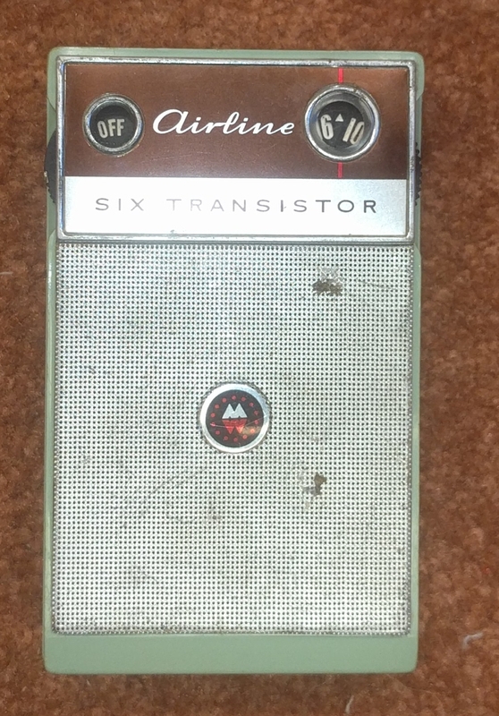

Hi willydcamaro!  I actually decided to set this radio aside for a while and work on some other simpler radios to gain some experience.  As you know the 47-1230 is not exactly a simple radio, and I had just started in the radio restoration hobby at the time so I decided I needed to do some learning before I really tried to troubleshoot the Philco.  In the meantime I have completed 6 radios, including one small transistor radio that my grandfather gave me when I was 7 or 8 (early 60s).
