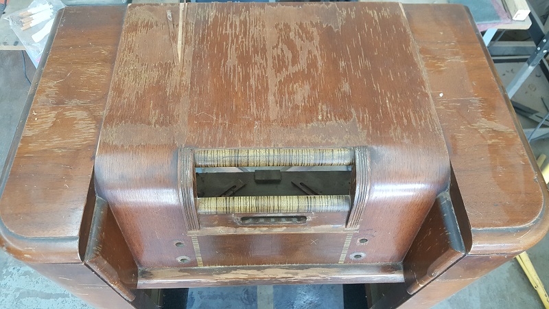

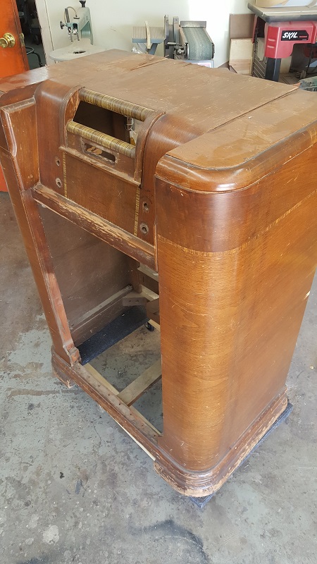

Very common set I believe and we have a customer that's has to have it lookin new again and playing like new again in including the turntable, that original turntable will not be used , its to far gone. The philco will have a updated unit rebuilt and installed. Cabinet will have veneer fixed and new photo finished applied, looks like zebra wood, stay tuned for progress on this set. This radio should look new once completed.

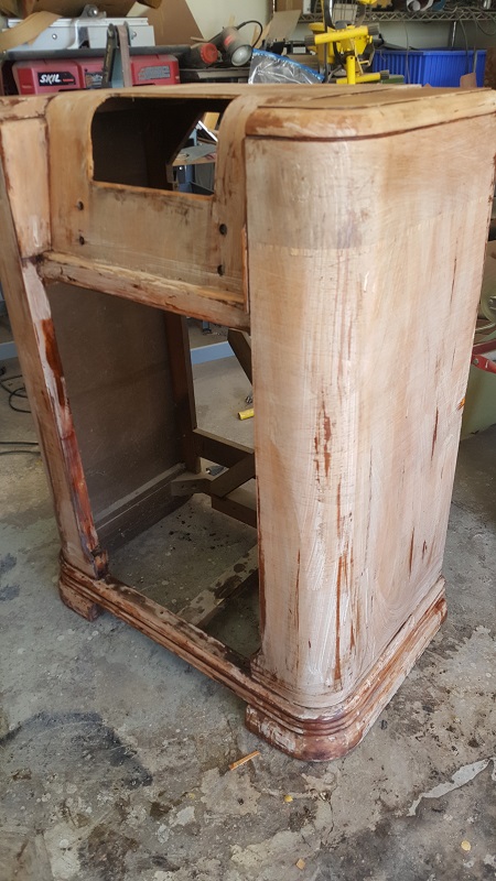

When you're removing the old finish, do you use stripper to get off the majority of the finish then sand the rest?
I know this cabinet will look great when you're done with it. Looking forward to more pictures of the work you're doing on this one. Even if it's a common, mid-level radio, at least it's going to live on instead of becoming a wine bar or some other shabby chic crap project.

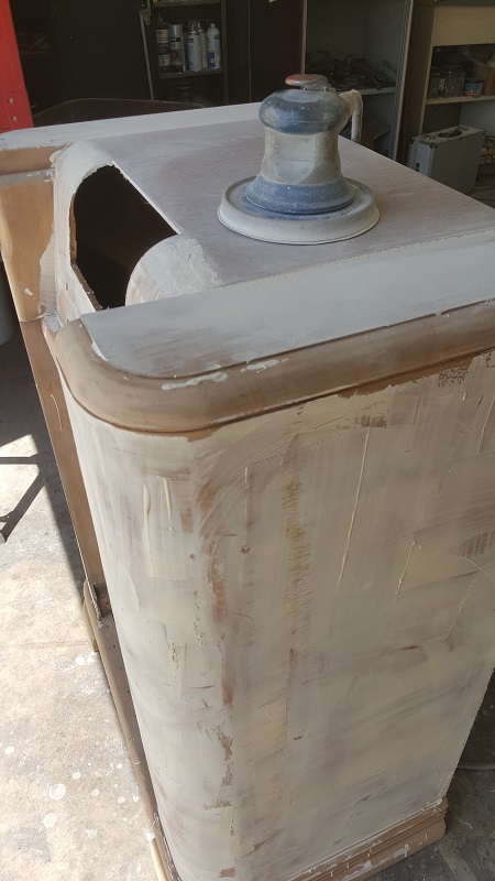

Yes I use clean strip ( Thick jelly type) from home depot, after all the finish is removed I wipe it down with lacquer thinner. Then I will proceed to sand cabinet with 240 grit using a dual action sander and by hand. Hope that helps you any.
Thanks a lot, that was the information I was looking for. I got the finish stripped off my cabinet today according to your input, and it's pretty much ready for finishing. Just need to do the veneer work now...

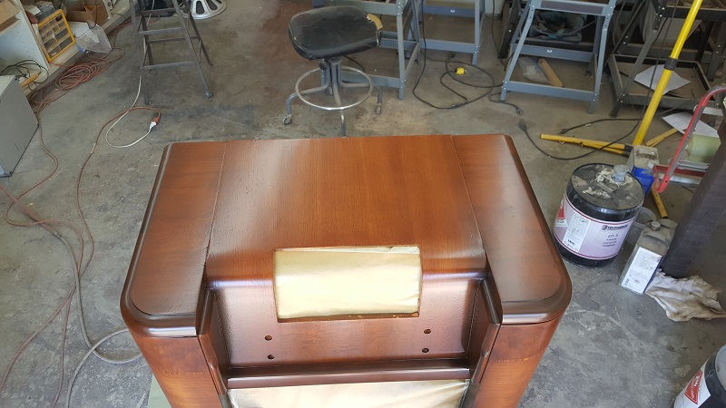

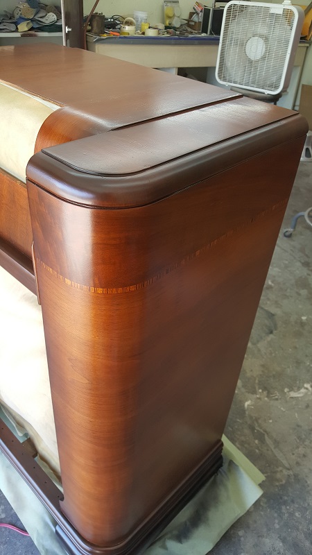

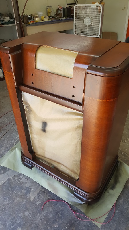

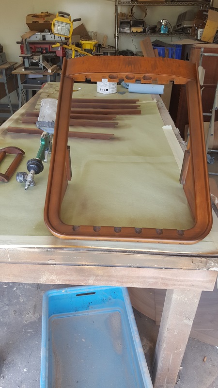

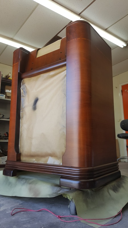

Stripped , sanded , grain filled and sanded again , stained with toned areas that I like much better than a plain Jane cabinet. I have sealed everything in three coats of sealer and then that will be sanded smooth being very careful not to burn thru. I am waiting on the zebra wood photo finish vinyl and then will apply that showing how I'm doing the photo finish to you all. This radio sure will look nice when completed.
Few more pictures
Looks good! You haven't put on the clear yet, right?
Not yet, the sealer must be sanded, that's what on the cabinet right now in the photos, clear coating comes last.

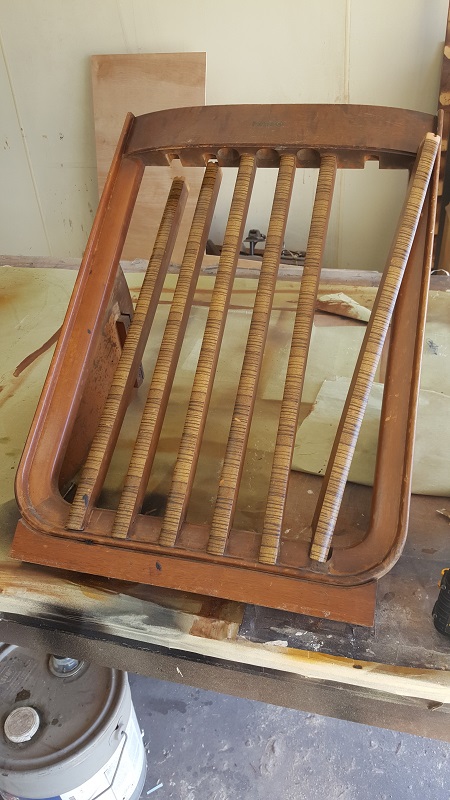

I was glad to see that most of the main cabinet did not have the photo finish. At least the grille bars can be done separately if they are bad. The little bit by the dial is not to bad by the looks of it.
