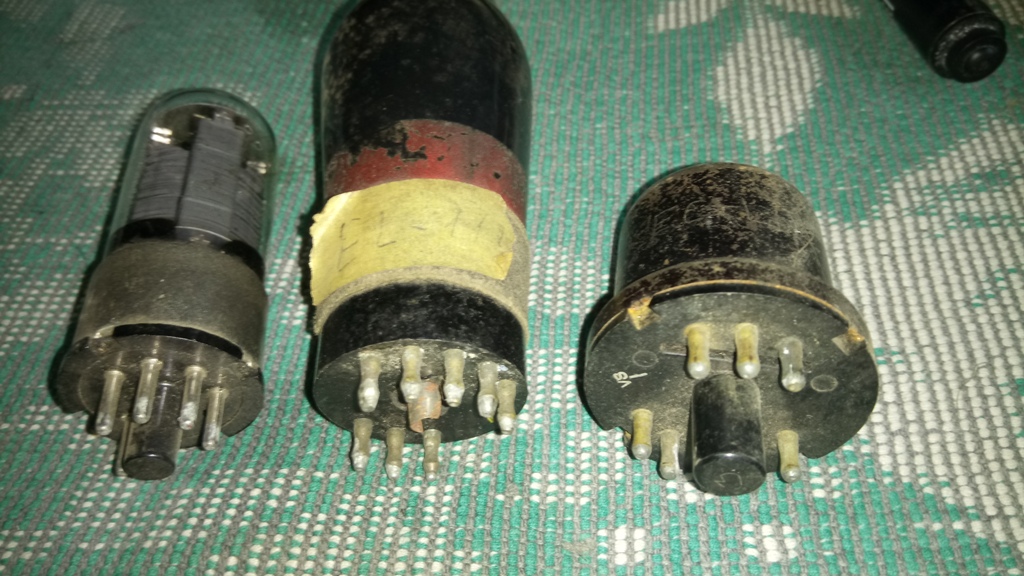

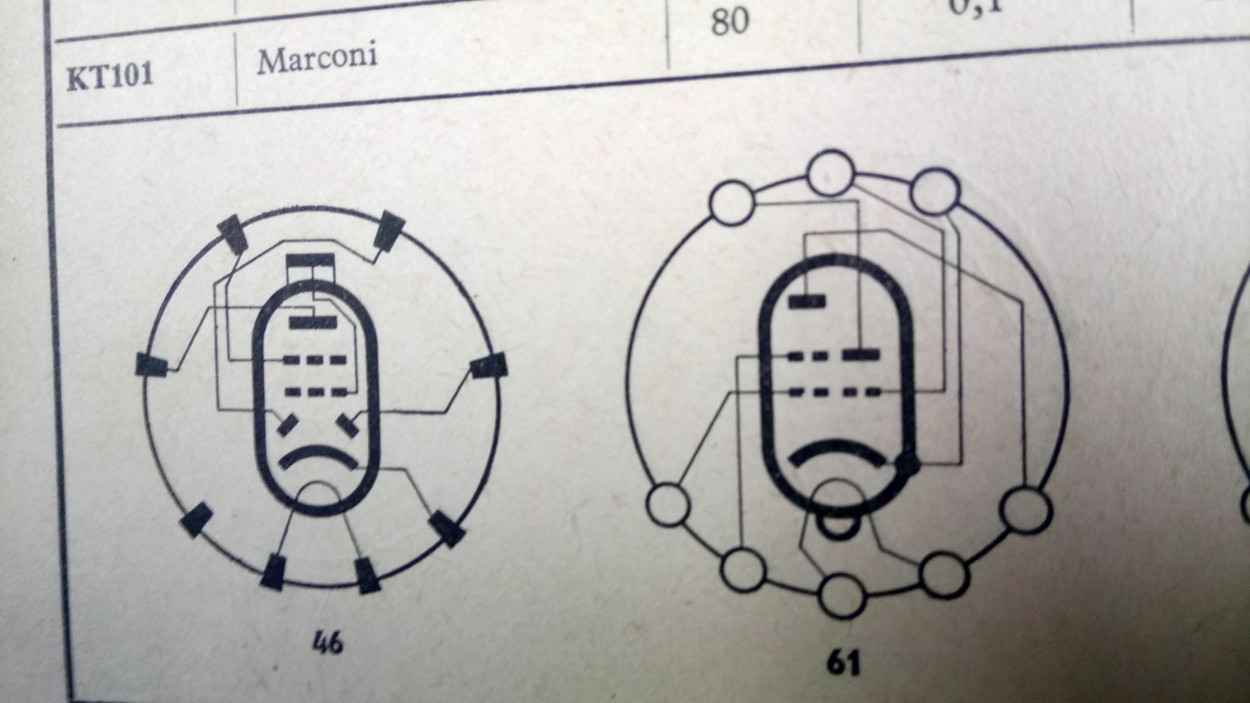

RadioSvit Wrote:Arran, this type of German radio lamps has another slang name - "helmets". From the extraordinary similarity with the German helmets of the Second World War. And you would probably be very surprised if you saw the structure of the armature of these radio lamps - it is not placed vertically, but horizontally. That is, the filament, cathode, grid and anode are in a horizontal position, not in a vertical position! As it was in radio lamps at the beginning of the 20s
Peter;
I could see one adopting a slang term like that for those tubes, we typically call those German helmets "Sergeant Schultz" helmets, or "Coal Scuttle" helmets. They are a pretty decent design for protecting your head, though very heavy compared to a British or Canadian "Tommy Hat" style helmet. They were popular in use as motorcycle helmets at one time, though now they make lighter, and safer replicas out of fiberglass, which have padding in them.
I forgot about the internal structure of those tubes, I think that I read about that elsewhere. It was rather retrograde, the only tube that I have personally own with that sort of arrangement was a Myers tube, which was a triode intended for D.C operation, that produced in Canada in the early to mid 1920s. I wonder if the stahl tubes have more problems with shorts between the elements, anode to grid, heater to cathode, etc. ? The horizontal structure would explain the pin arrangement, the heater, and cathode connections would come out of one end, the grid and anode connections out of the other. The footprint of the socket seems wasteful, one would think that they would make use of the larger diameter to use with multi section tubes, by adding extra pins, but apparently they did not. I think that the Soviet electronics industry was more sensible in adopting octal based tubes, and later the all glass 7 and 9 pin ones ( i think they had lock in tubes as well did they not?)
Posts: 746
Threads: 24
Joined: Nov 2014
City: Svalyava. Transkarpatia
Yes Arran. The socket area of German radio tubes is still larger than that of octal radio tubes. Here is a photo for comparison.
And regarding the reliability of German radio lamps of the "helmet" type, I can say that these are extremely reliable radio lamps, the most reliable of all European ones. Here are some more photos with a diagram of their internal structure.

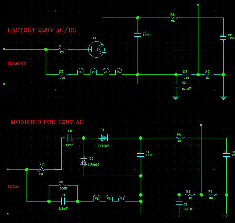

The 120VAC mod schematic. The PDF is a nicer one, but for a quick look I captured my CAD's screen.
I also added 500K resistor across that 3.3uF cap. It could be added across the input voltage also. Whichever is more convenient.
Note to folks who sub the ballasts with caps: same as across X-cap, a bleeder resistor is always needed. A 3.3uF cap is a large cap, and will store a lot of charge at potentially full input voltage peak.
500K will make for roughly 1.6 seconds discharge time and negligible electric effect while working, and negligfible power dissipation, hence the value.
A convenient place for me to put it is right across that cap.
PS. I also tried introducing X-Cap (0.47uF) across the AC lines, no effect. Y-cap already is there, 0.1uF between the Negative (lower AC line) and the GND, so no sense adding anything.

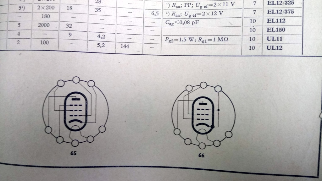

Interesting, not what I expected, on an octal tube the heater pins are usually on pins 7 and 8, shield is pin 1, and cathode is usually pin 8, but on those stahl tubes they put the cathode and heater pins on opposite sides of the socket. Does that glass tube with the same base use the same horizontal structure or is it more conventional?

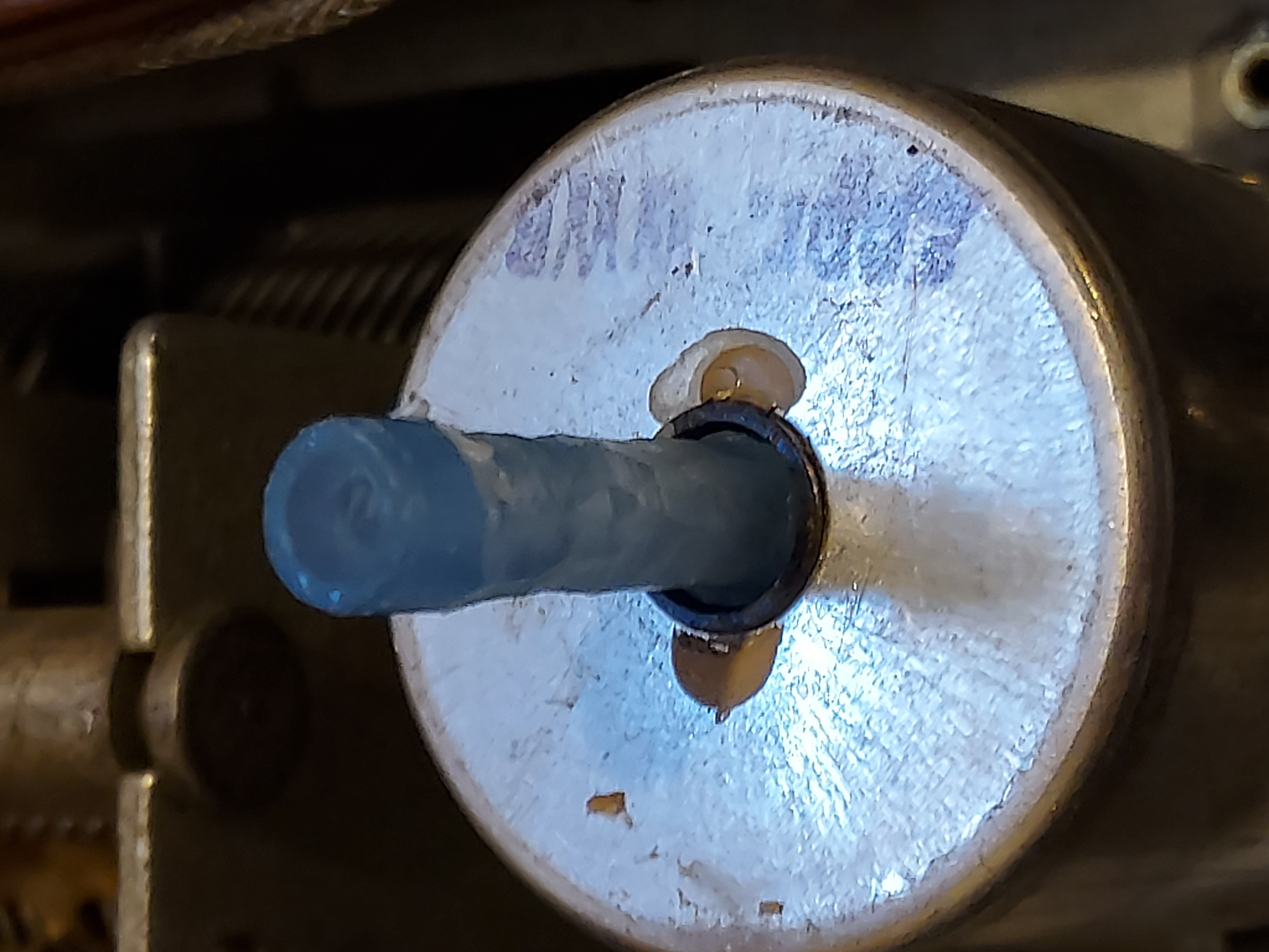

I am trying to align the radio without the instructions.
Which is OK. I'd still like to have the alignment instruction, considering the bands and the oscillator have both trimmer caps and trimmer coils.
But I have started with IF, which is 473kHz, and while I successfully passed it via antenna input (this one has no grid caps to disconnect), the trimming is a whole different matter.
The IF is adjusted by the screw core, and while the ones at the bottom of the IF transformer are easily accessible, and I was able to mold a tip holder of a ball pen to be my socket driver, the ones accessible from the top are about 1/2" inside the bobbin, and the diameter of the inside of the bobbin is about 1mm wider than the core's hex width (4mm side-to-side, 4.2mm corner-to-corner).
I am trying to figure how to access it. It needs to be hard plastic nut driver with very thin walls. I am sure there was such a tool available to Telefunken techs, but, well, those wonderful days are long gone.

Well, I have aligned IF.

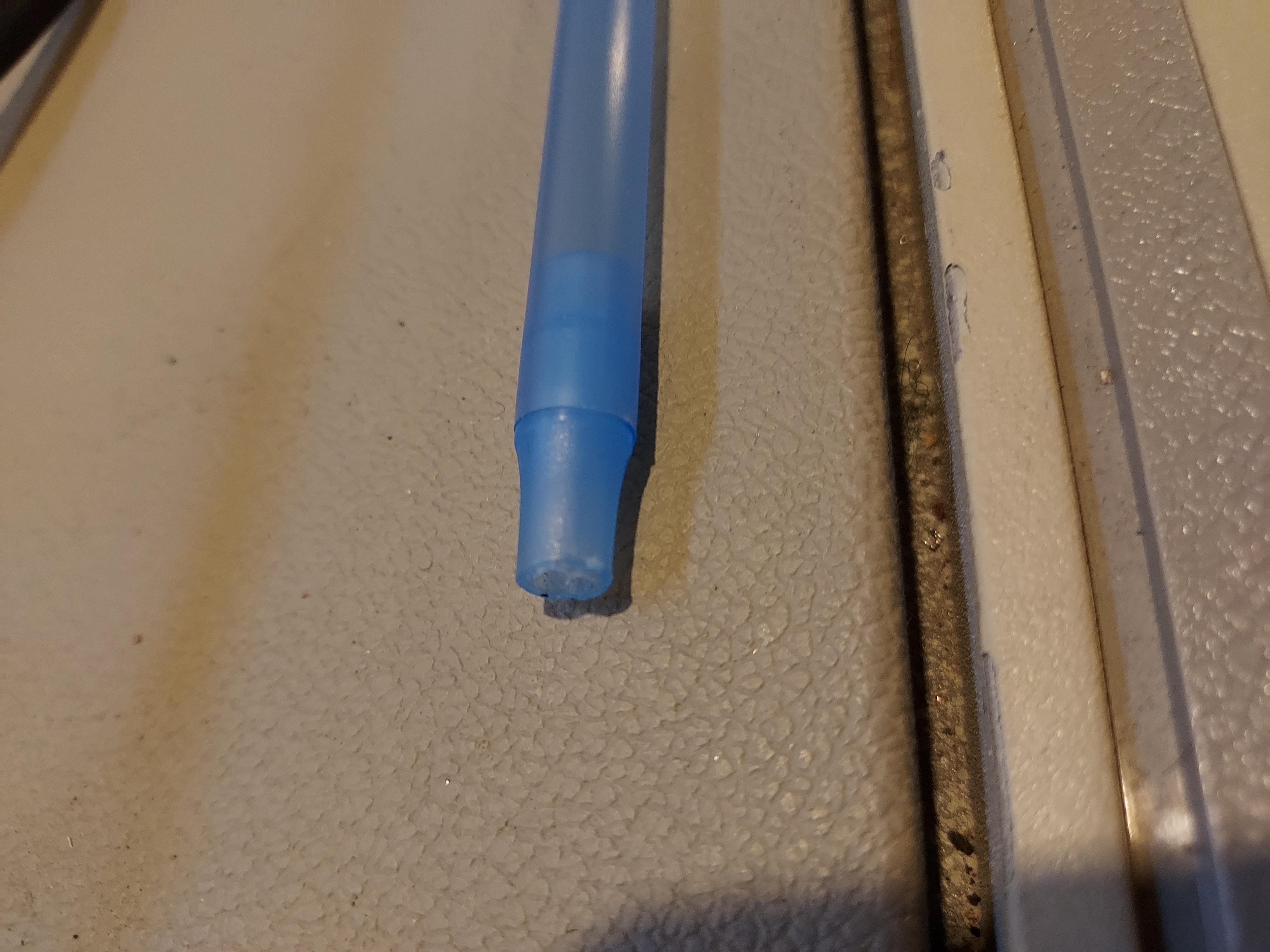

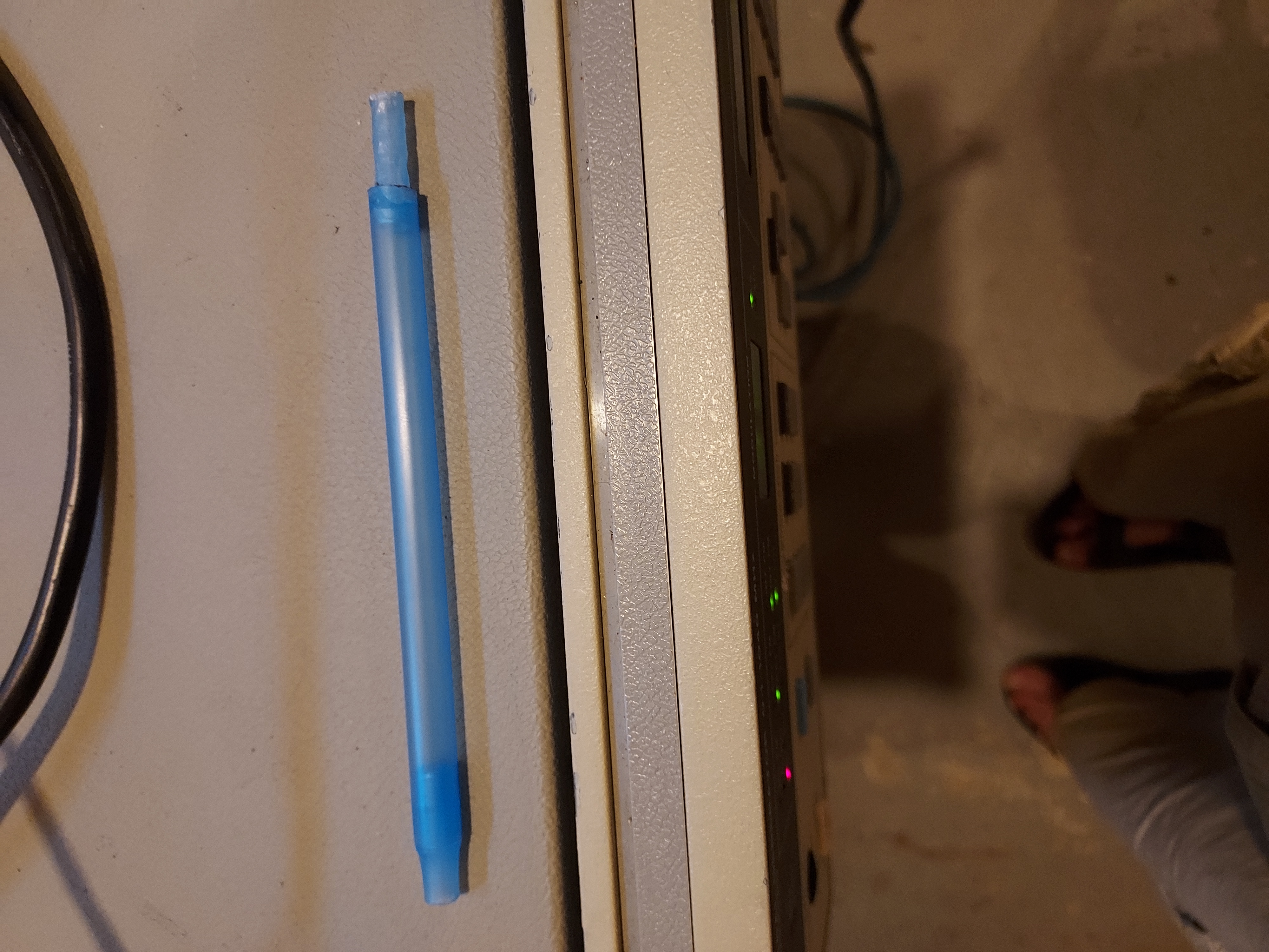

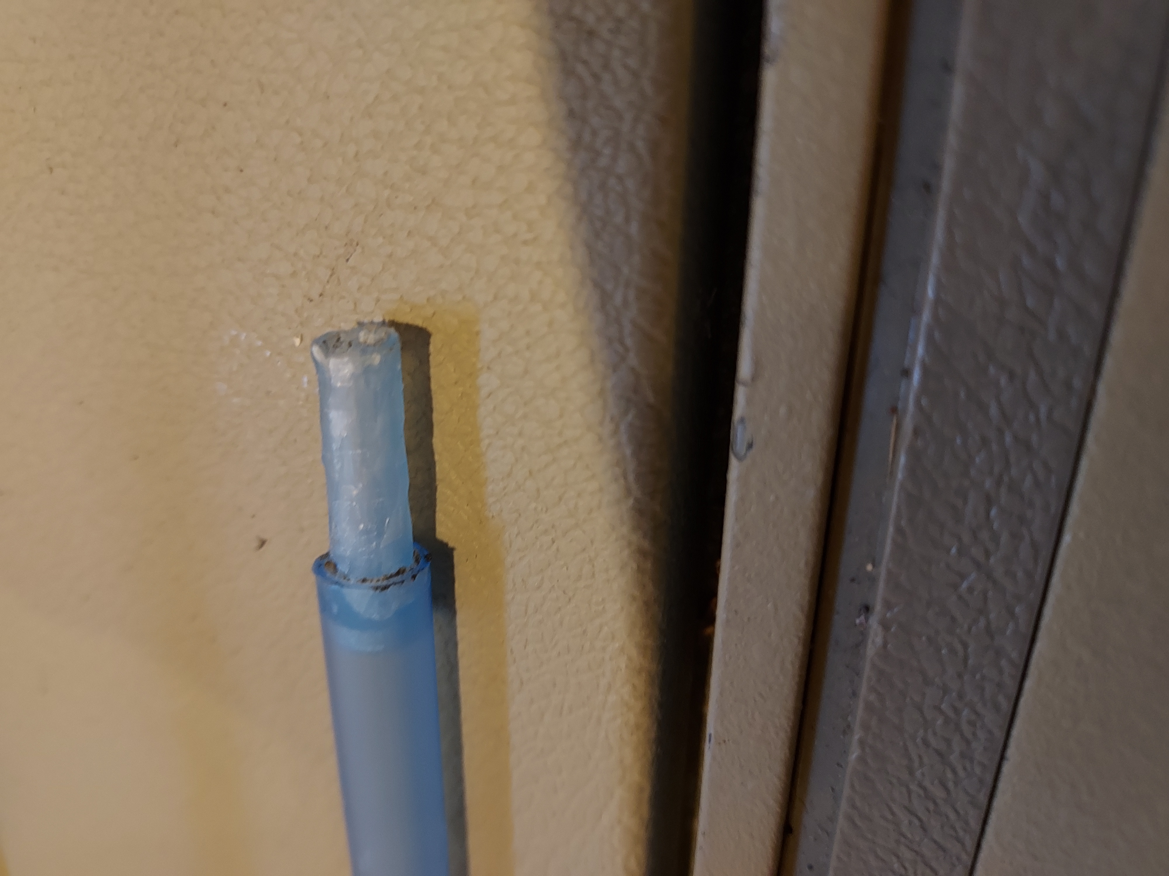

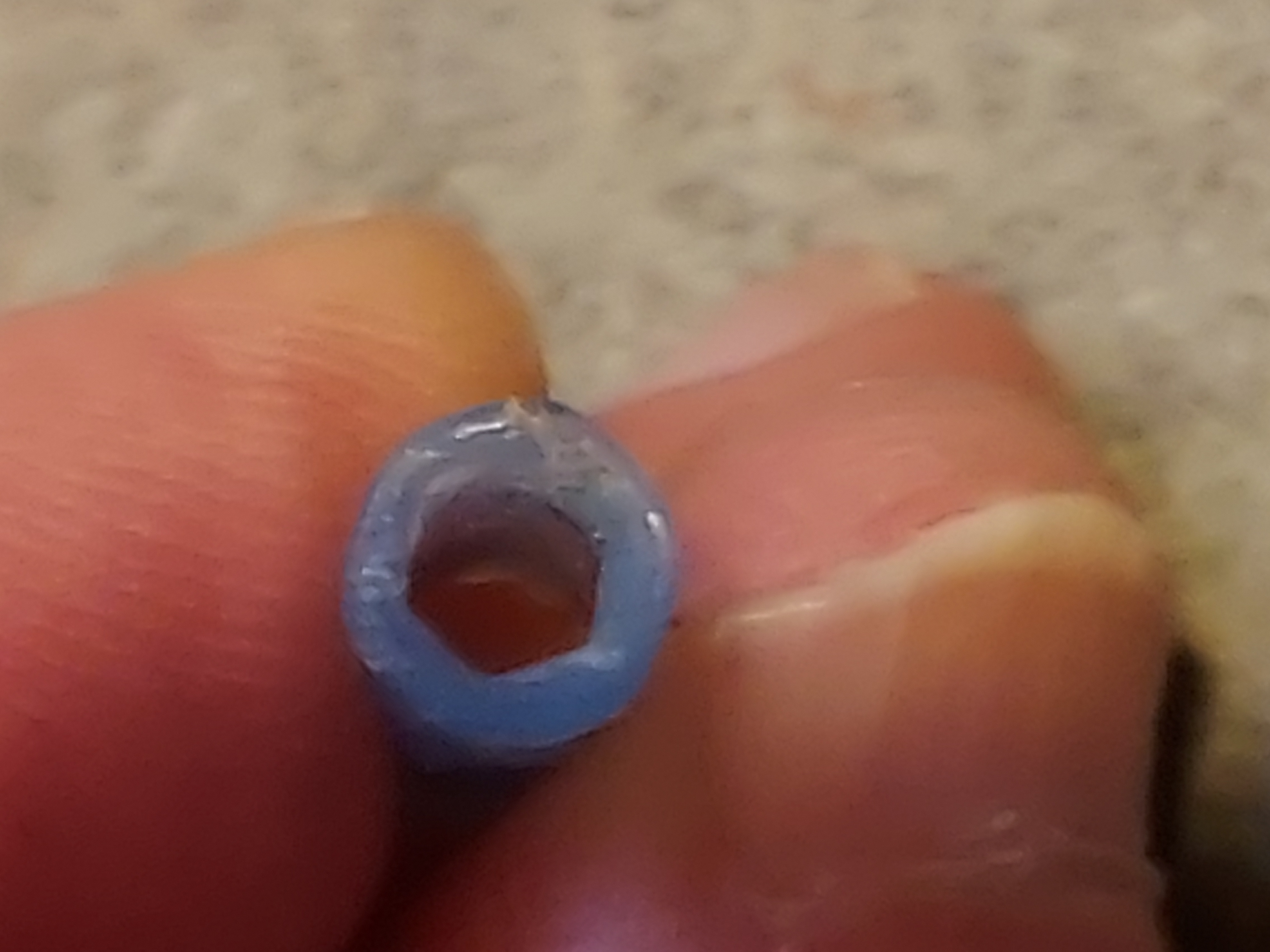

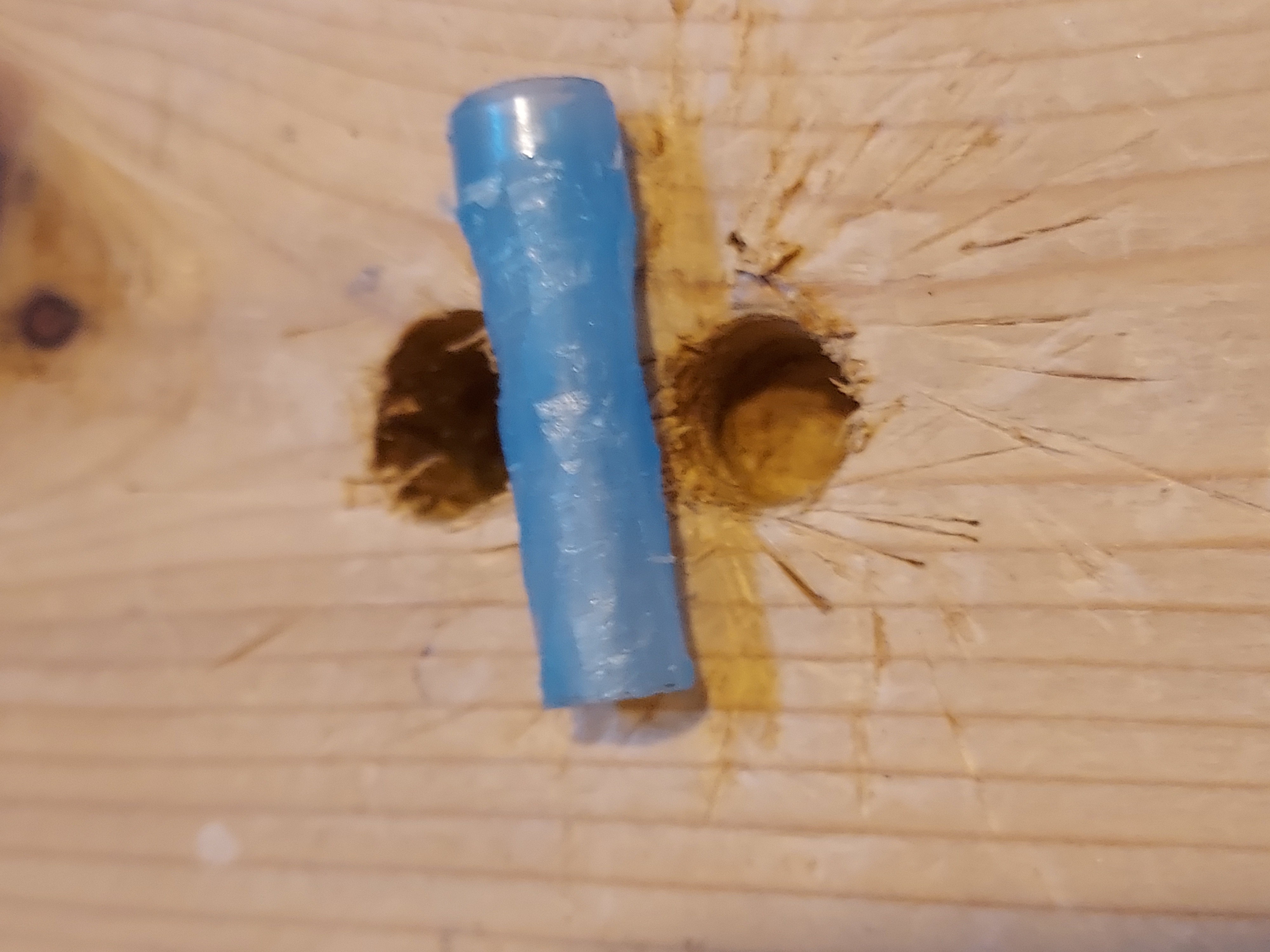

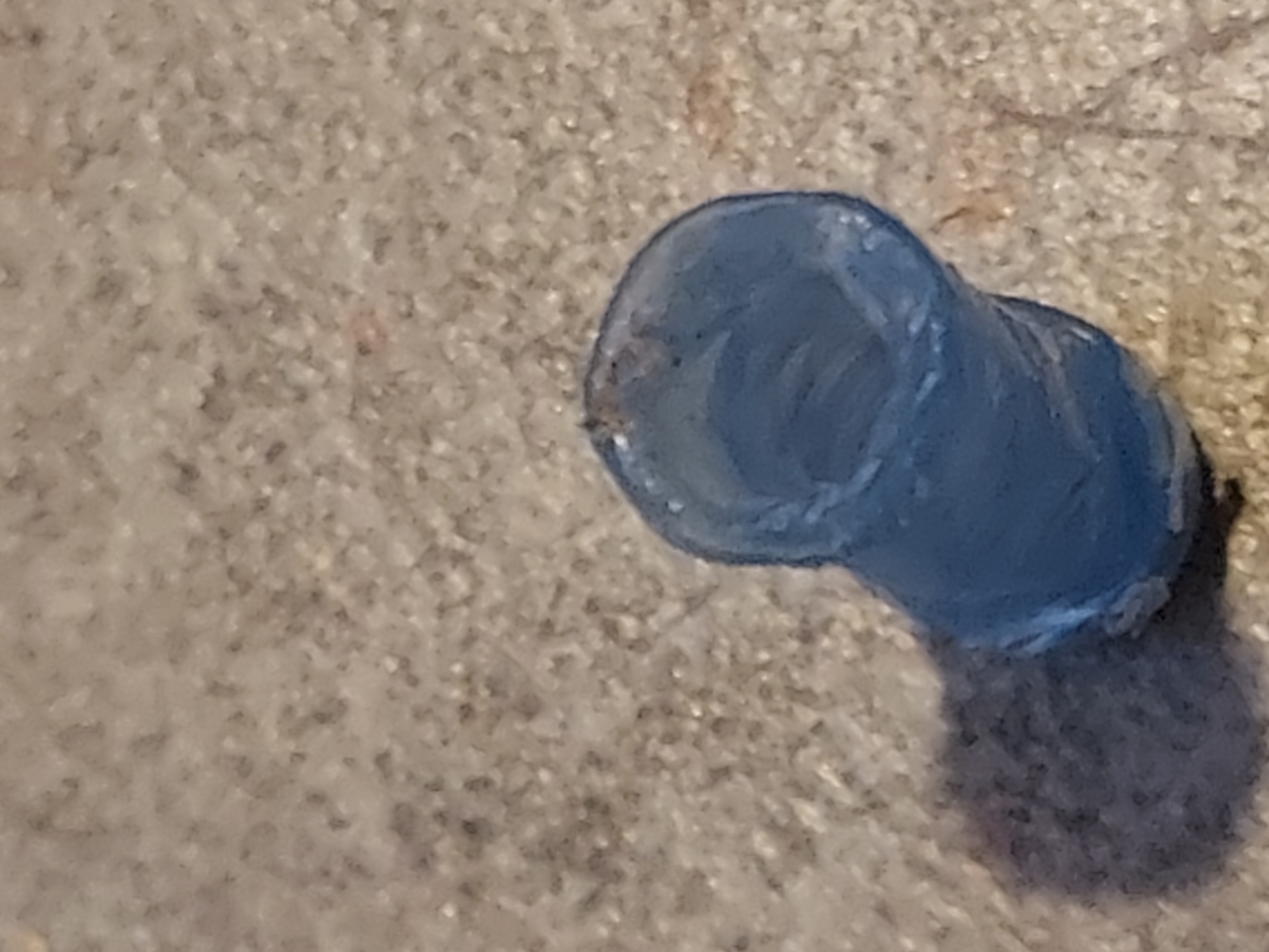

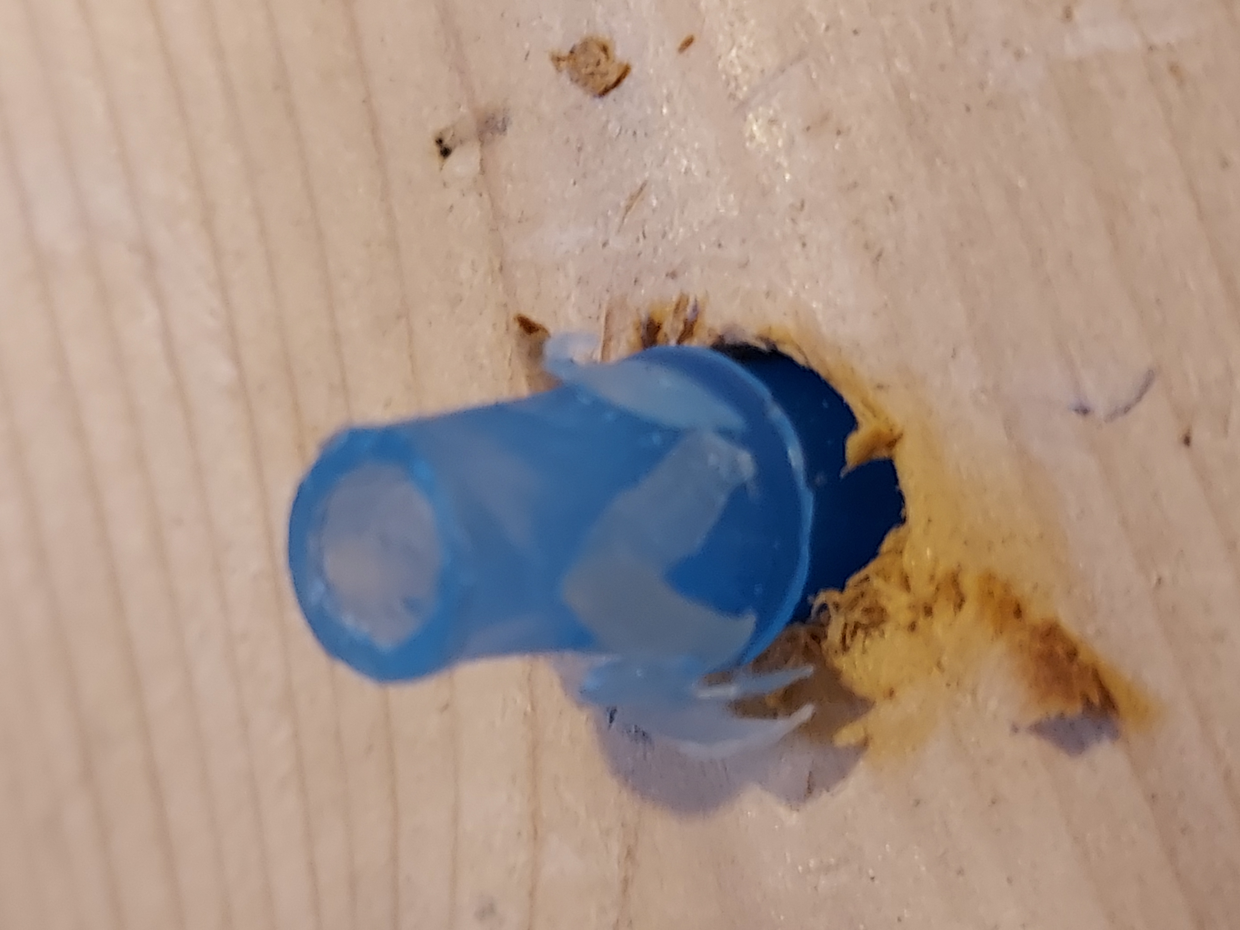

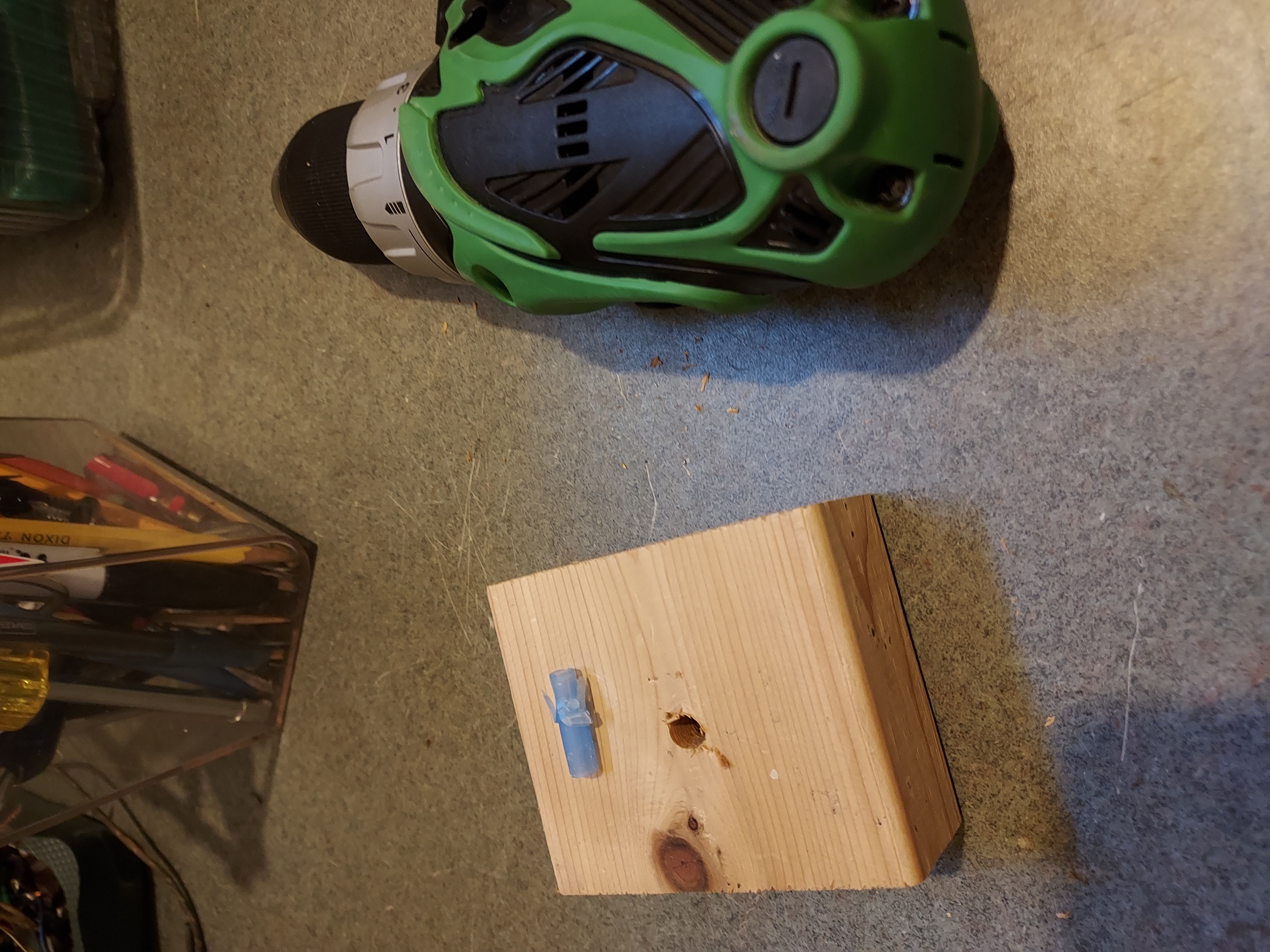

I made a tool. One more BiC ball pen lost its life, but it was not for naught!
First of, it is a well-known way of making makeshift nut drivers, molding heated plastic tube (semi-translucent ballpens are ideal, exactly the plastic that is hard enough, easily molded but does not crack) around the hex shape to be driven.
This time it was not the pen main trunk but the small cone that holds the cartridge tip itself.
I drilled a suitable hole in a piece of wood, to serve as a stable holder, and shaved the cone-shaped tip-holder to be a cylinder of about 5mm or so in diameter, to fit inside the well to reach the ferrite slug.
In went the cone, and I shaved it with my Exactlo knife into a cylinder.
Then I used the bottom slug to morf the heated cylinder into the nut-driver shape. The slug sticks out so it is ideal to form the hex shape. Earlier I formed another cone to serve as a driver for these, but it only is usable for these bottom cones, as they are readily accessible.
After the cylinder cooled off, and became solid, I took it off the slug
Then with my Exactto trimmed the edges that bulged up a bit, which would preclude the cylinder from going inside the well, and glued it into the ball pen.
Now I have a universal tool to drive the slugs that stick out or hide inside.
