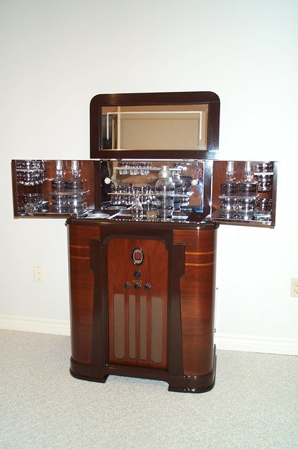

Is this an actual photo of your Radiobar, or does yours just look like this?
[Image: http://philcoradio.com/phorum/attachment.php?aid=2218]
That looks like it has a 610 or 620 chassis inside, smaller escutcheon with no provision for a shadowmeter. A 660 chassis is much larger than a 610 or 620 chassis, and needs a much taller escutcheon with a window at top for the shadowmeter screen. Plus, the shaft spacing of the 660/665 is different from the 610/620, a 660 or 665 chassis would not fit inside a Radiobar made for a 610 or 620 without some cabinet modifications.

The picture is not of mine. It is of one that looks identical to mine.

Well the model 620 and 610 do not have a shadowmeter but the model 660 and 665 do have a shadowmeter. The shadowmeter, if still functional, works kind of like a magic eye tube where there is a shadow, viewed through a little window of slot just above the dial, that narrows when the radio is tuned to a station and widens when it isn't. The dial lens should have a clear window right at the top of the oval, if it doesn't then someone swapped a 660 chassis in place of the original 620 chassis. This may or may not be a problem in that the escutcheon and dial for the 660 may have more viewing area then the 620 since it has four bands instead of three, maybe Ron or someone could tell you if the escucheon from a 660 or a 116 would physically be larger too.
The 660/665/116 escutcheons are larger...much larger...than the 610/620 escutcheons. Plus, as I mentioned before, the spacing of the control shafts is different - the bottom three controls are a bit further apart on the 660/665/116 than on the 610/620/630.

I have to amend my reply. It looks like there is a small window above my dial. I didn't really understand what you were asking before but when I looked at my dial I see there is an area above the dial that aligns with a light socket behind, which would illuminate the amber area as seen in the picture below. I assume this is what you were asking about?
