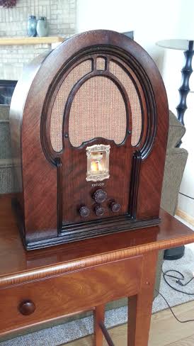

Here's the cabinet. I don't want to even tell you what I paid for this ;-). Mark
(04-10-2015, 02:19 PM)markmokris Wrote: Here's the cabinet. I don't want to even tell you what I paid for this ;-).
Then don't.
Looks very nice! But, where is the PHILCO decal?

Very nice! I love comparing the before and after shots.

Hey Ron,
I have the decals. They will go on as soon as I can elevate this radio from shelf-queen status  .

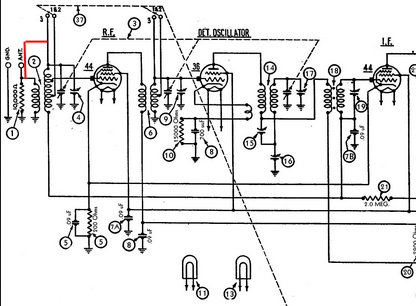

Antenna Coil
I have been working under the assumption that the antenna coil (2) is good, because I have continuity on the correct pins. However, when I make the connection in RED below with a jumper (bypassing the antenna coil), the signal gets quite a bit louder. Still not right, still faint, but stronger. Does this mean the antenna coil is bad, and I should be rewinding it?
I feel like I am making progress, but who knows?
Mark

Measure the resistance from the ANT post to the GND post. If coil is good it will read a few ohms like 10 or less. If bad will read 10K. You know what to do. It"s about the same as the osc coil but not as critical.

Well I think the antenna coil is good.

Mark,
Have you tried adjusting the cap at item 8? May also be worth reducing the resistor at item 10 to 7500 ohms. Reading through the thread it doesn't sound like these have been tried.

Here she is finished. It's performing pretty well now across the band. I know I got carried away with the escutcheon and shined it up too much? But I like it. I bought some stuff to age it a little bit, but I may leave it as is.
Mark
