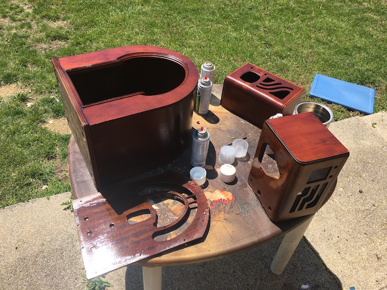

I found out today that this cabinet has silicone poisoning...
I am toning the cabinet and she has about 6 spots that are fish eyeing badly.......
Soooooooo, I am clearing, sanding, clearing, sanding, clearing, sanding....
Finished that after 2 hours and am now toning.. She will be darker than original as the veneer was so poorly refinished and filled with putty. Any lighter and you would see the mass imperfections...
Never use a belt sander on a cabinet people....
