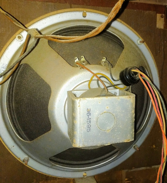

Drat!  Wired up the pushbutton assembly and still no audio.  I've done some testing and the audio section is ok.  But I can't get a modulated 455kHz signal through the AM section.  Then again, I'm not certain I'm actually injecting a modulated signal.  I have a B&K E200D that's just been sitting for 30+ years.  I did open it up and clean all the switches and controls, and I know the carrier is there, but don't know if it's the right frequency and don't know if I'm successfully modulating it.  I guess I need to test my test equipment before I test the radio!
A side question.  Is there a good (safe) way to clean the speaker cone?  This bad boy is in GREAT shape, but is quite dirty.
