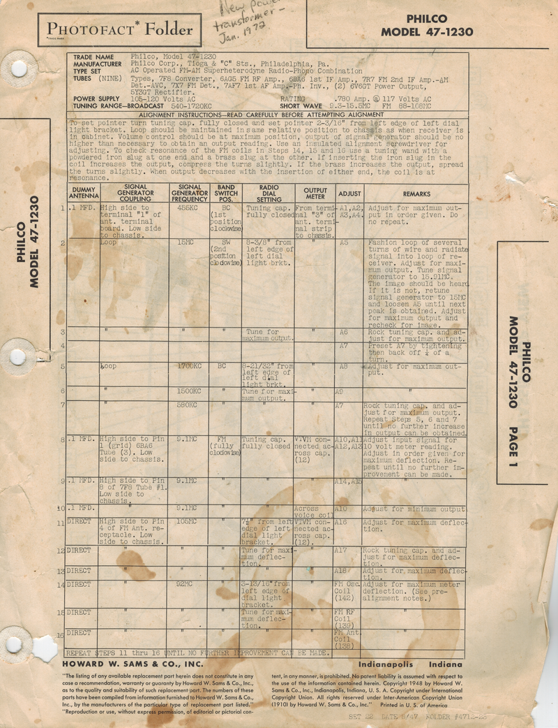

I hadn't completed the alignment procedure and after looking at the remaining steps I decided they were probably pretty important in relation to the problem I was having.  Here are the alignment steps from the Sam's Photofact

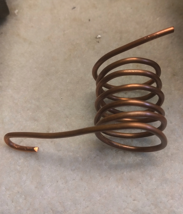

I did step 1.  Steps 2, 3, 4 are for shortwave and I didn't continue on and do steps 5, 6, and 7, which involve adjusting the caps for the AM antenna coil and the AM oscillator (403A, C415B, and C415A in the schematic I posted in post 100)...pretty important.  I made this loop and suspended it inside the radio's loop antenna for these steps.
