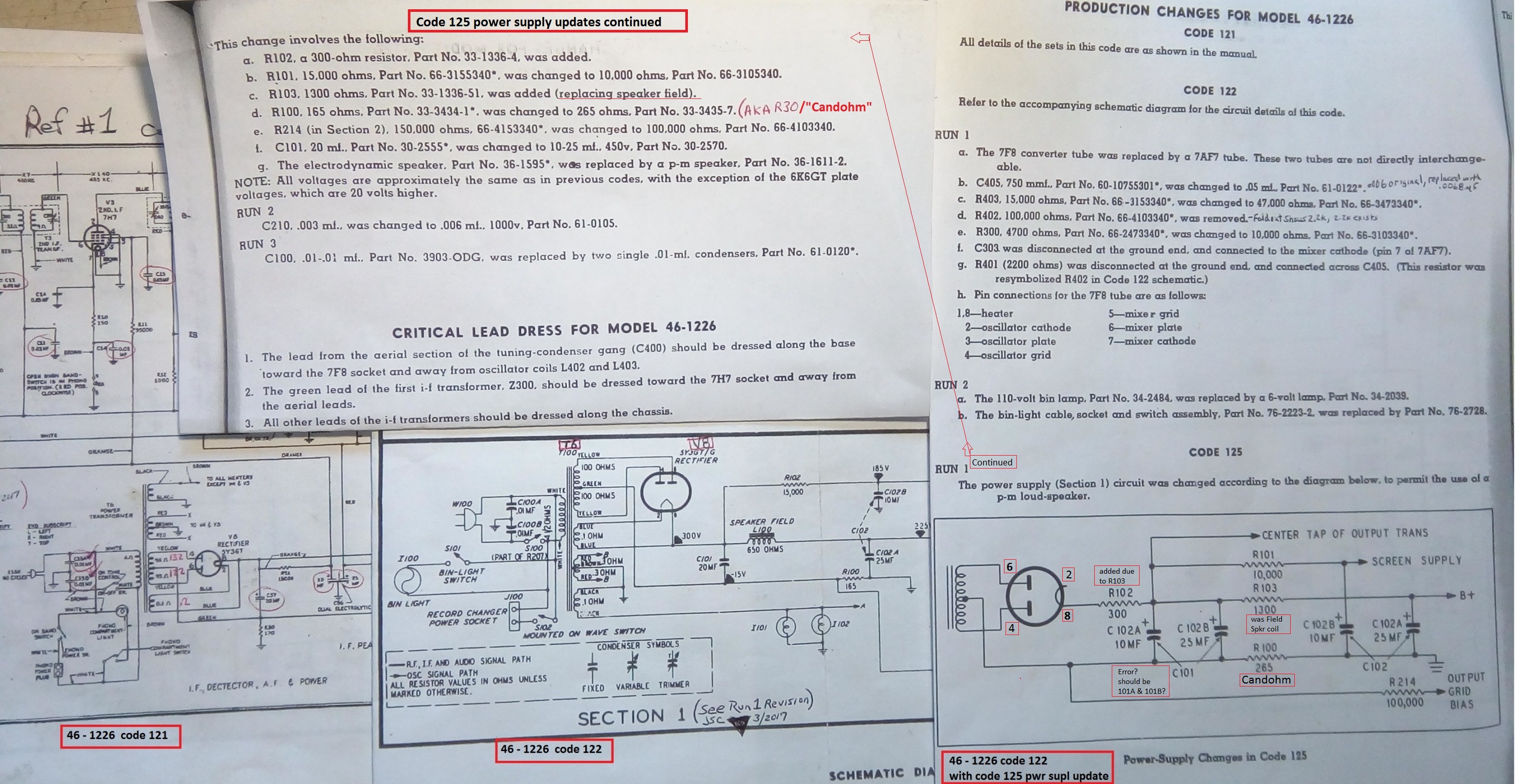

46-1226 code 125 restoratioin *DONE
communications error on my part.

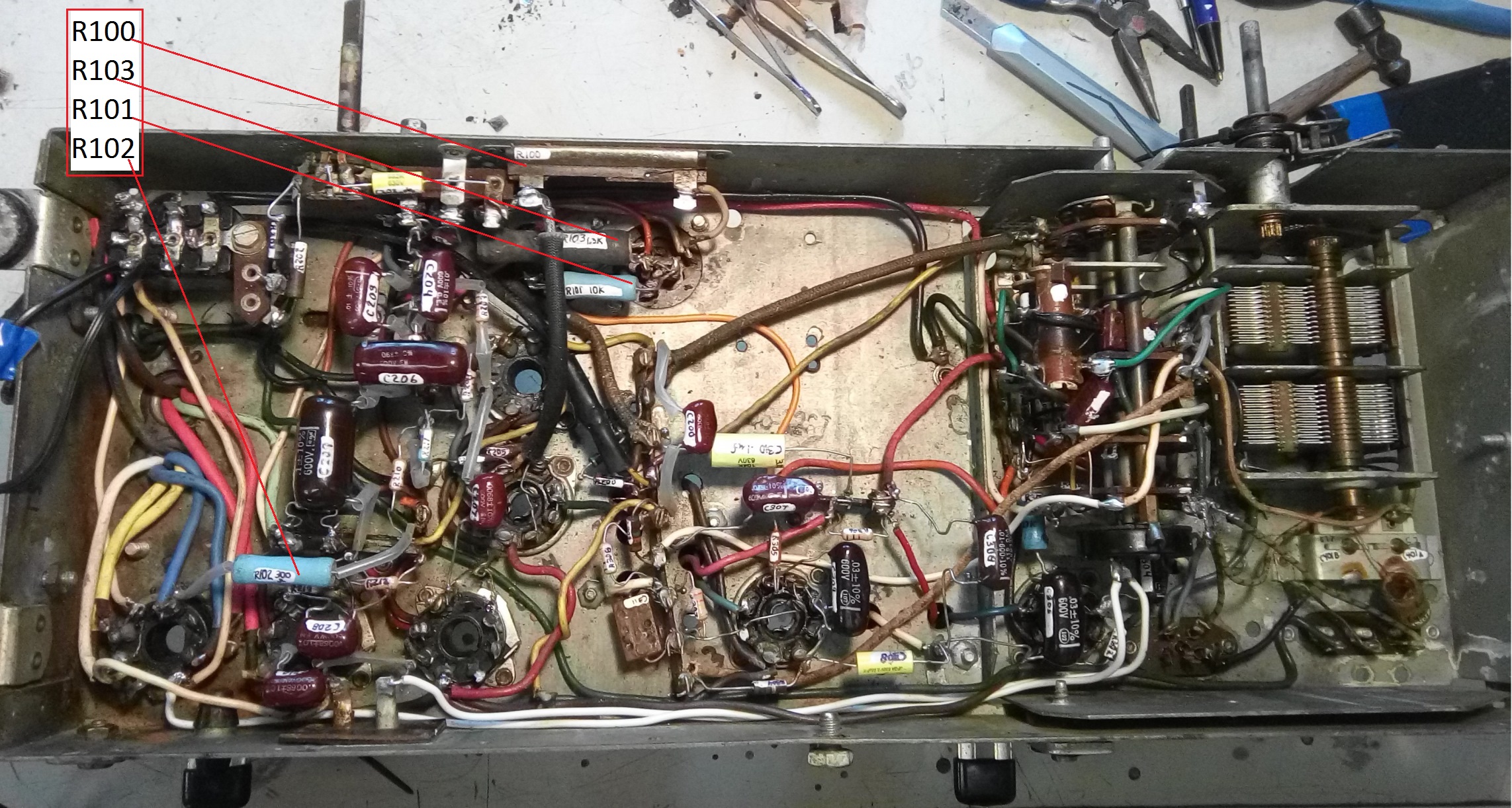

my resistor that is getting too hot is called out as R102.
R102 *IS NOT* the speaker field coil replacement.  R102 is spoken to in the code 125 update as simply "added" off pin 8 of my rectifier tube.
the resistor that replaces the field coil is R103 and is the original with code 125 called out PN#
additionally i have the original R101 with the correct code 125 call out PN but its leads were too short, replaced with the blue one in the pic.
My candohm is shown as well, as R100... its pn upgrade to code 125 is also correct.
going to get the information requested now.
I have provided updated prints & picture to help.  does this change any opinions?
