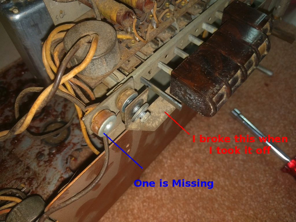

Here's something pretty cool.  I'm missing one of these spacer/eyelets for mounting the pushbutton assembly:

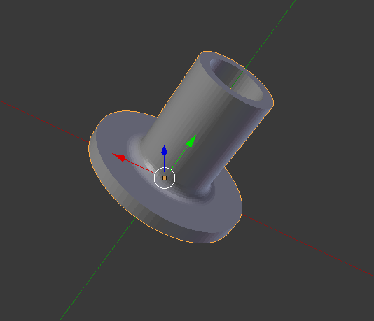

My new 3D printer is supposed to be here sometime in the next couple of weeks so I drew up a 3D model for one and will try printing one:
I also broke the stiff cardboard/fiber shield under the pushbuttons when I took it off.  I assume this is some sort of light shield?  Anyway, I drew up a 3D model for that as well, so we'll see how that turns out.
