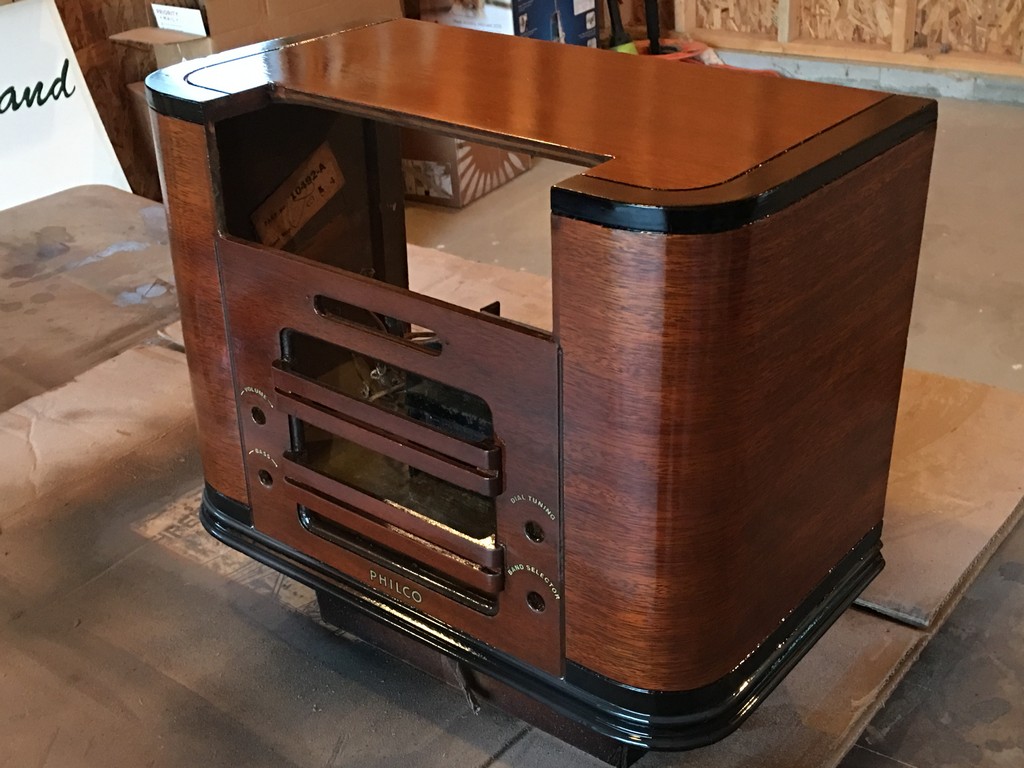

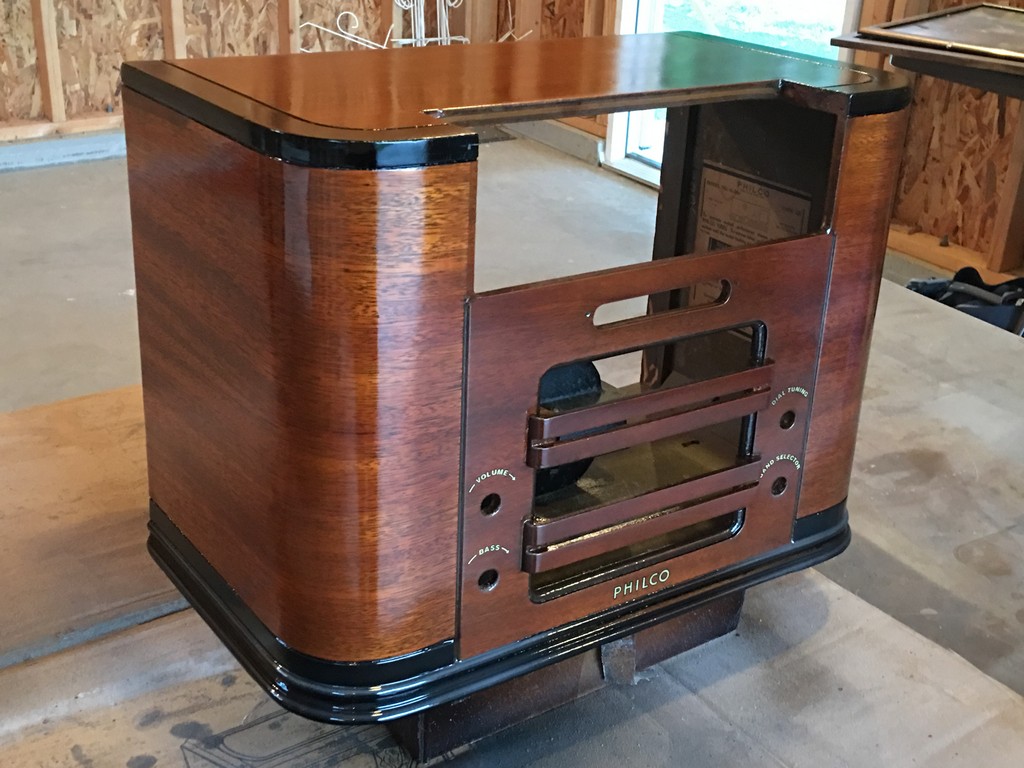

After some more clear lacquer.
[Image: http://www.philcoradio.com/images/phorum...18_044.jpg]
[Image: http://www.philcoradio.com/images/phorum...18_045.jpg]
This was sprayed as the sun was going down and the front blushed badly due to warm temperatures and high humidity. By the time I took these photos, much of the blushing had disappeared but as you can see, there still is some blushing on the bottom trim.
I will bring it inside in a little while. If the blushing remains by tomorrow, I will hit the trim with some No Blush Plus. Otherwise this may be finished save for final rubdown.
