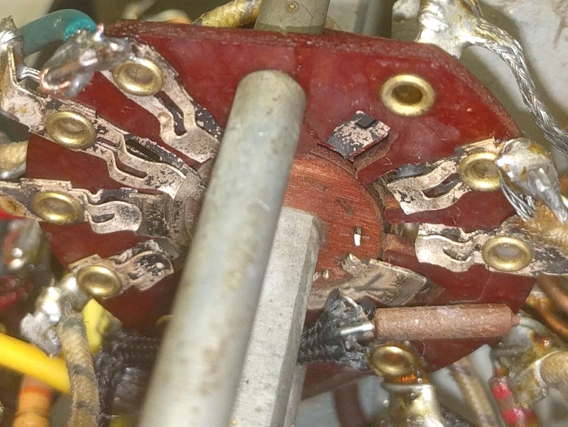

Here's something else to throw into the mix.  I decided to try to clean the function switch as well as I can...all of the contacts are black.  I don't think this is causing my FM problem because I can see tracks on the flat rotating contacts where the stationary contacts ride on them.  But it can't hurt to try to clean them up a bit.  Anyway, as I was cleaning the rear side of the front section I noticed this:
It's cracked at the top. And it's definitely broken...I can move it.  I also don't think this is causing my FM problem but it certainly needs to be fixed.  I cleaned the area as well as I could with some 91% alcohol.  So, what's the recommended glue to use?  I'm thinking super glue but want to get recommendations.
