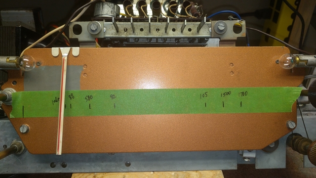

I think I'll think about that one while I remove the dial backplate and paint it.  I put some tape on it so I could mark various points on the dial and when I removed some of the tape some of the paint came with it.
I experimented with several different types of paint and it looks like Rustoleum Copper comes closest to matching.
