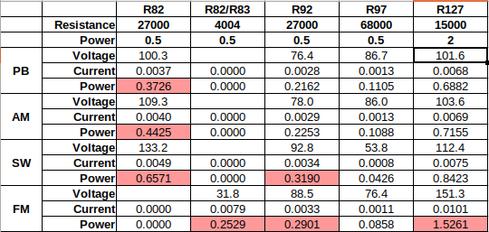

Correct Terry.  Here are my latest measurements, with the worrisome readings highlighted in light red:
I'm really not concerned about the R82/R83 combination in FM since there are actually (2) 0.5W resistors in parallel.  I need to get a better look at R82...it's buried a little bit.  But it looks more like a 1W than 0.5W.  If so, then those readings aren't quite as bad but still worrisome.  The one that really bothers me is R127 in FM.  I'll do more research and testing but it may be a day or two.
Thanks guys!
