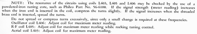

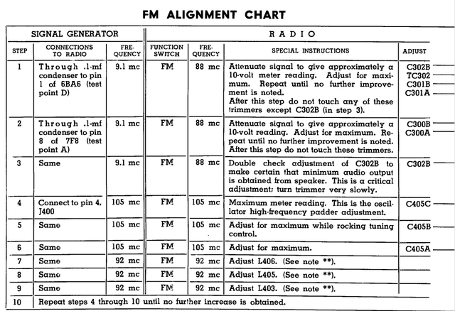

Thanks mikethedruid - I did align it at 455kHz for AM and 9.1MHz for FM, so I don't think that's the problem.  I've gotten quite good at installing and uninstalling the chassis from the cabinet, so perhaps I'll do it one more time just to be sure.  Actually I think the problem may be steps 7, 8, and 9 of the FM alignment procedure, since they are performed at the lower end of the band.
I don't have Philco #56-6100 so I don't know how to do these steps.  I did fiddle with the oscillator coil a bit when I was troubleshooting so perhaps it is off, but I don't know how to do these steps without the proper tool.
