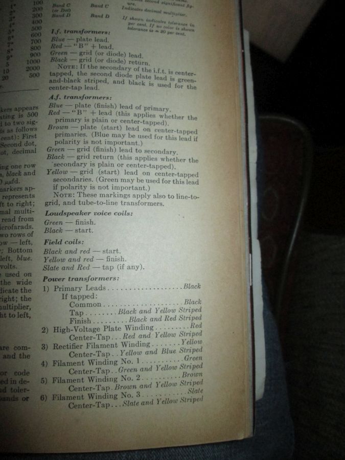

>I’m just curious if it matters what color wire you use to rewire?
The chassis doesn't care but there is the R radio M manufactures A association. They have a standardize color color for most of the wiring. I don't know that Philco abides by it though.
