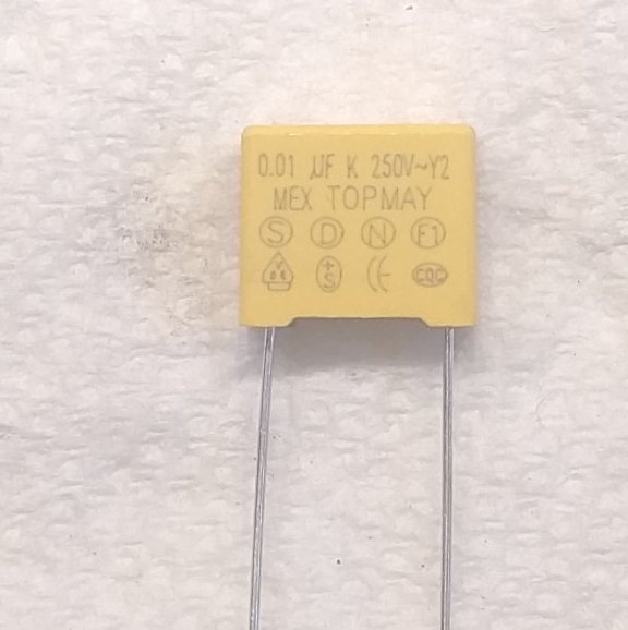

Just to clarify, in case you don't know, yours are marked X2, so they are the wrong type.  Plus, they are the wrong value according to my schematic...they should be 0.01uF.  You need something like this:
I think I got these from Just Radios, right there in Canada!
