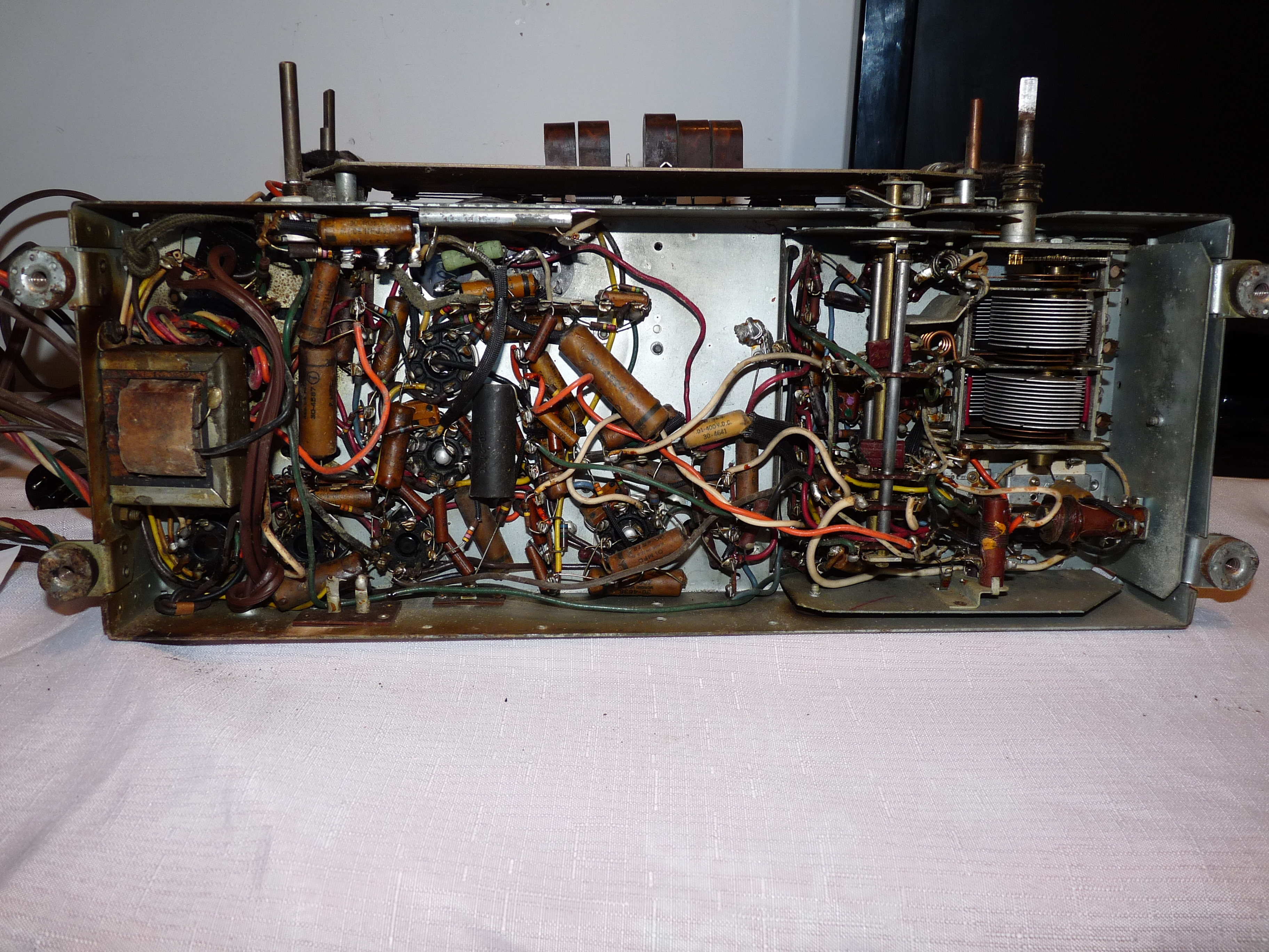

Thank you for the response, I have been scanning your threads on your 47-1230 restoration. Great job ,I hope to be as organized. So I have been cross referencing your spread sheet to the parts list and schematics.
My radio worked until the power transformer melted. I just replaced the power transformer and a small transformer for the audio tubes, since a direct replacement isn't available. I am now planning my attack on this beast, I mounted both transformers and started cleaning up the chassis. Now I plan on replacing all the paper caps. My question is what TYPE of capacitors to I order, Film ceramic, electrolyte ? and where should I order from?
I am planning on purchasing a Variac and putting in a fuse. I may look and the values of some of the resistor values too.
Thanks
Rich S
My Chassis:
