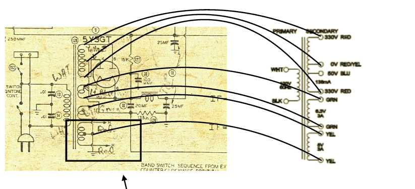

Rich, Thanks for the reply, So yea,  I ordered from just radios and should get them soon. As for the power transformer, I had to order two separate transformers since there isn't a direct replacement. I posted on how I think it should be connected , so let me know what you think.
