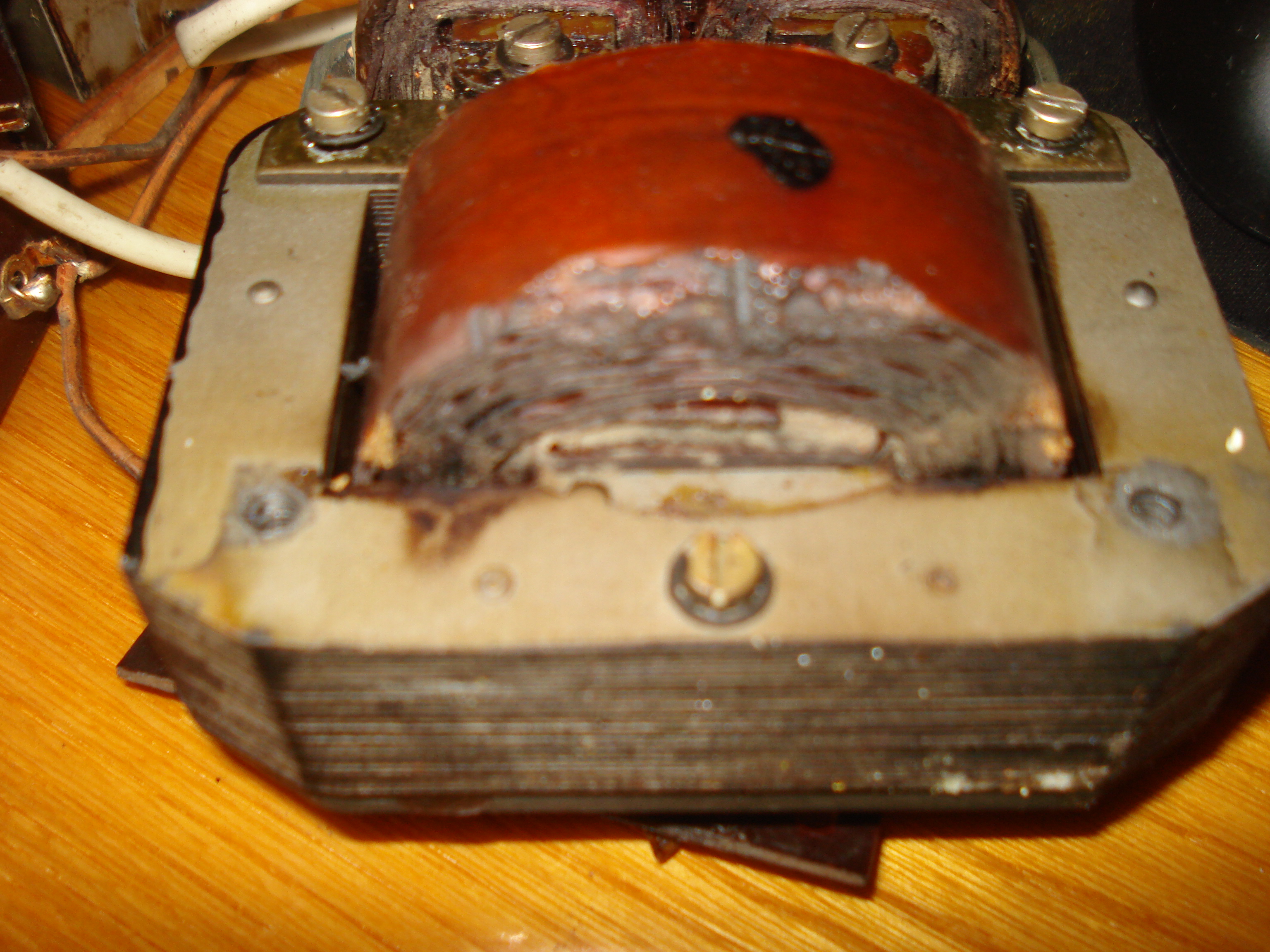

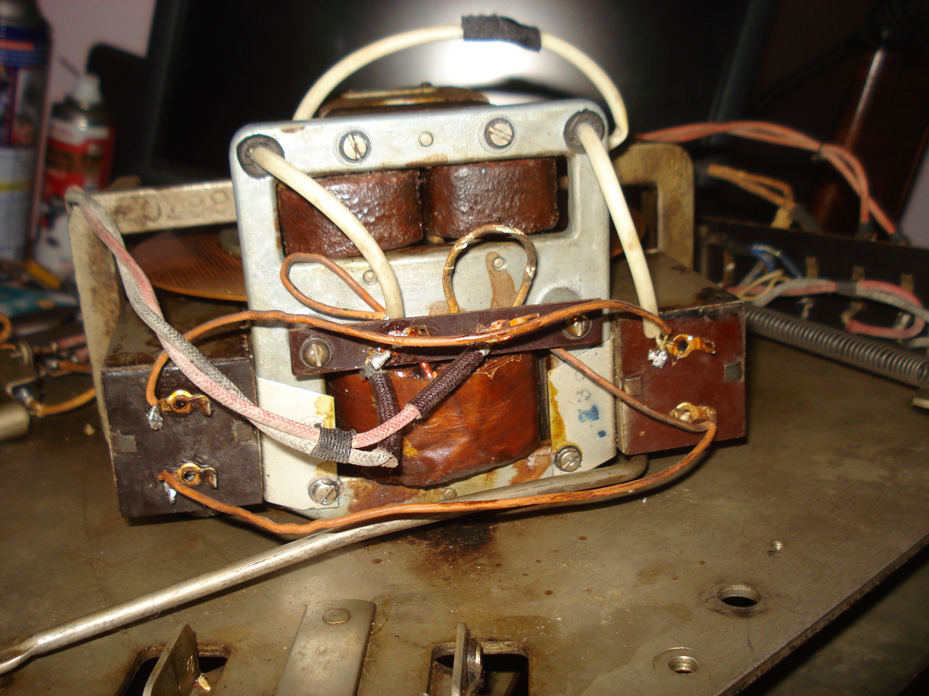

Replacing the engine with a Soviet one or another one will be a big problem, because the engine used here is a very rare type - a hysteresis engine. They have a very quiet and stable course, but I have never dealt with them, so I have no experience. Replacing the paper capacitors with new ones did not give a positive result, but I was surprised by the very low resistance of the working motor winding - only 20 ohms. The appearance also did not add optimism - it seems that the winding got very hot and has inter-turn closure.
