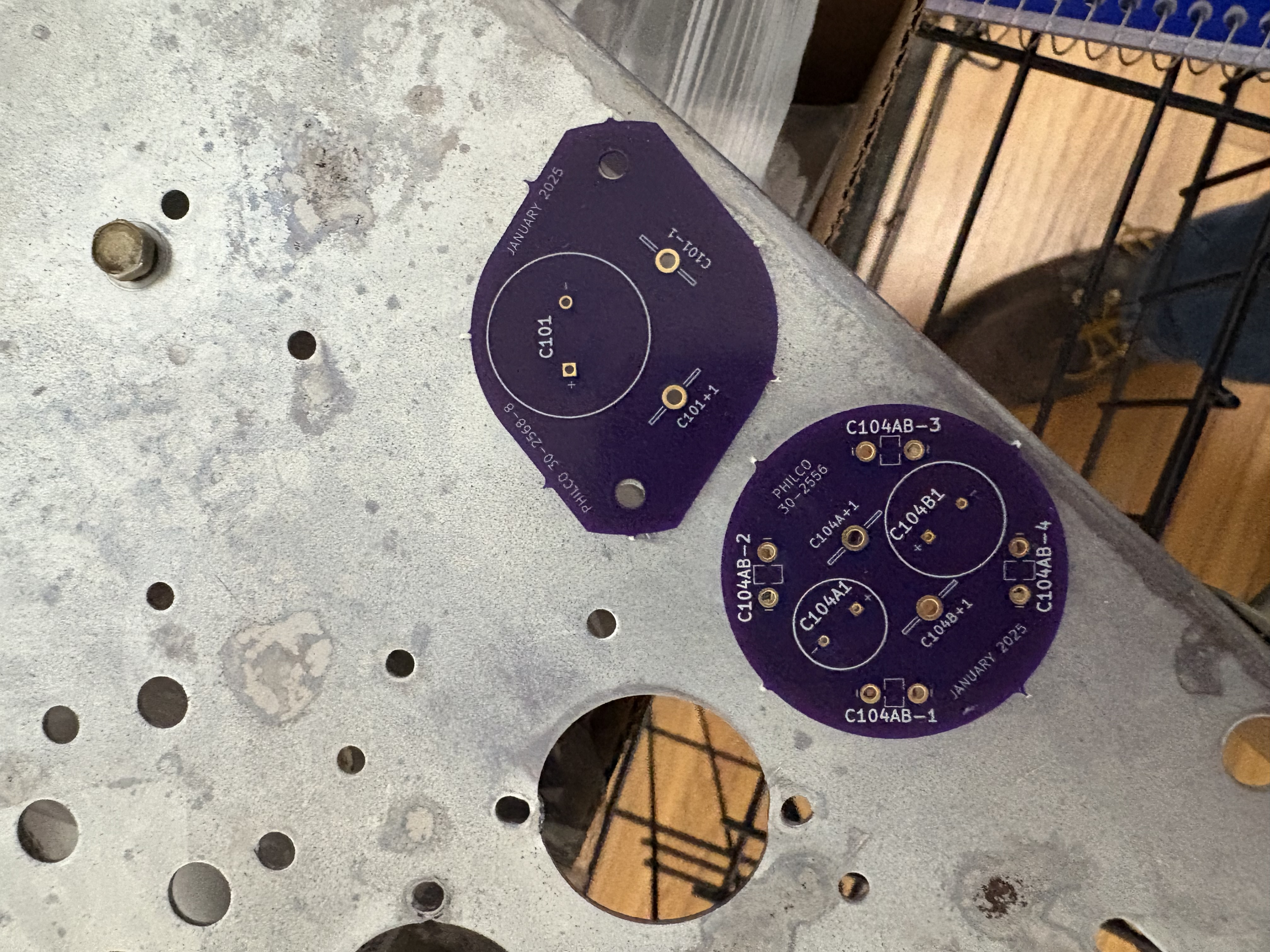

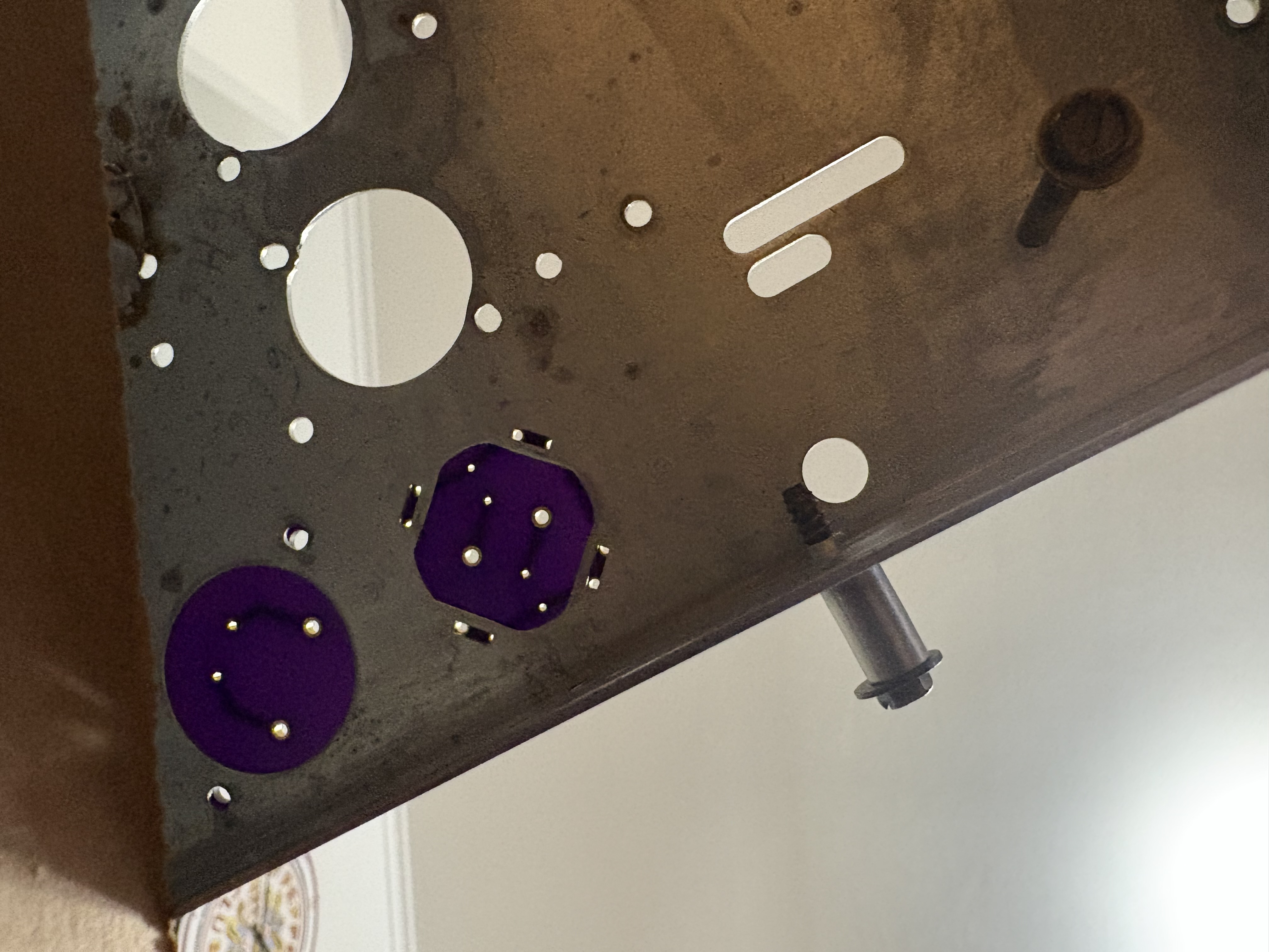

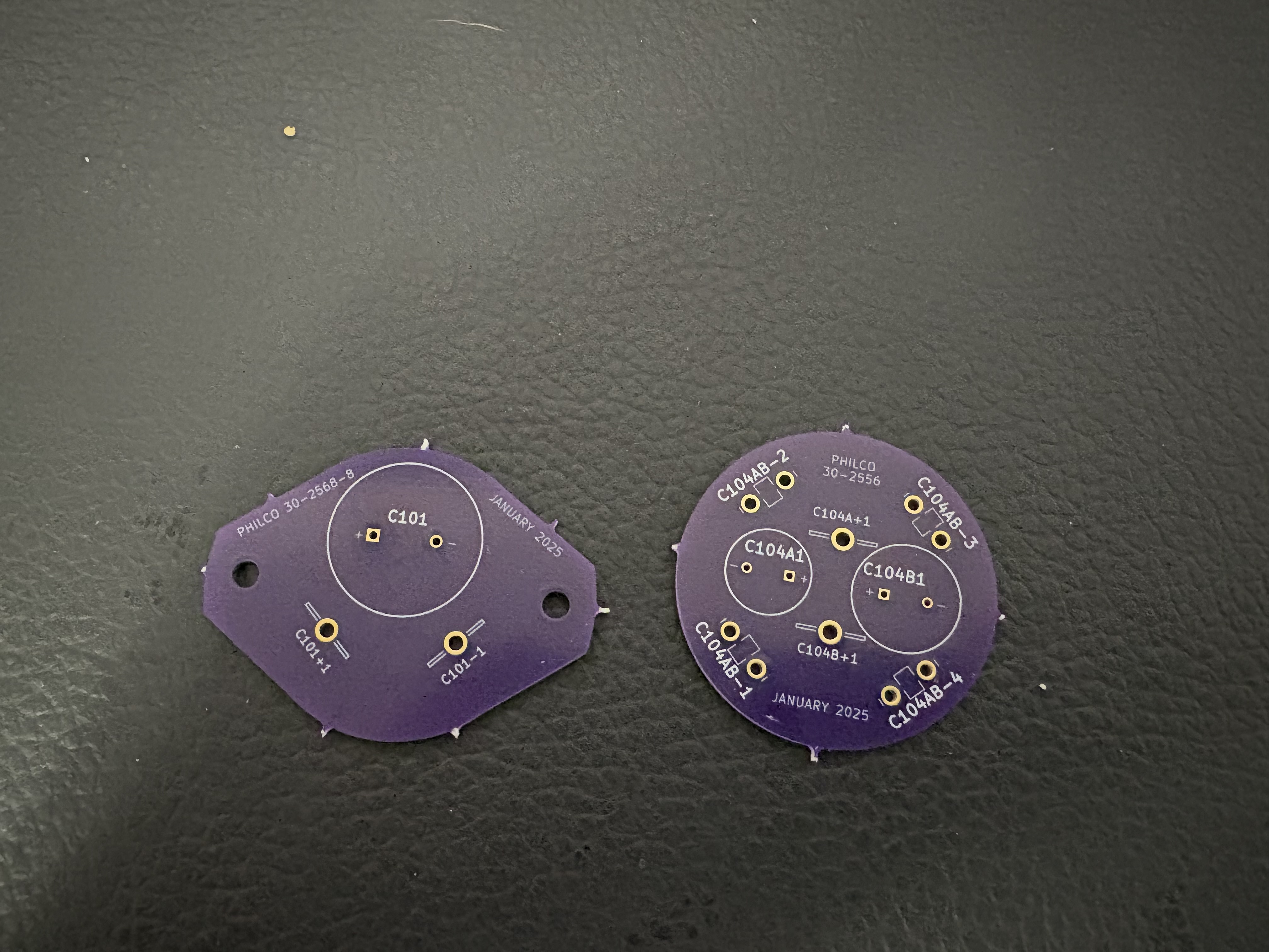

My PCBs were delivered for the multi-section capacitor replacements! The dimensions are just perfect. The elongated PCB lines up perfectly with the rivet holes, and the mounts for the four QC connectors on the circular disk align with the slots on the chassis for the original twist-lock lugs. Clearances look perfect (remember that the neutral pins, which are equipotential with the chassis) are the through holes which are closest to the edges.
I finished verifying all of the passive components yesterday, so I’ll get an order together on Mouser this evening. I’ll include the QC connectors and solder lugs for these two PCBs. Can’t wait to see them assembled and installed on the chassis!
