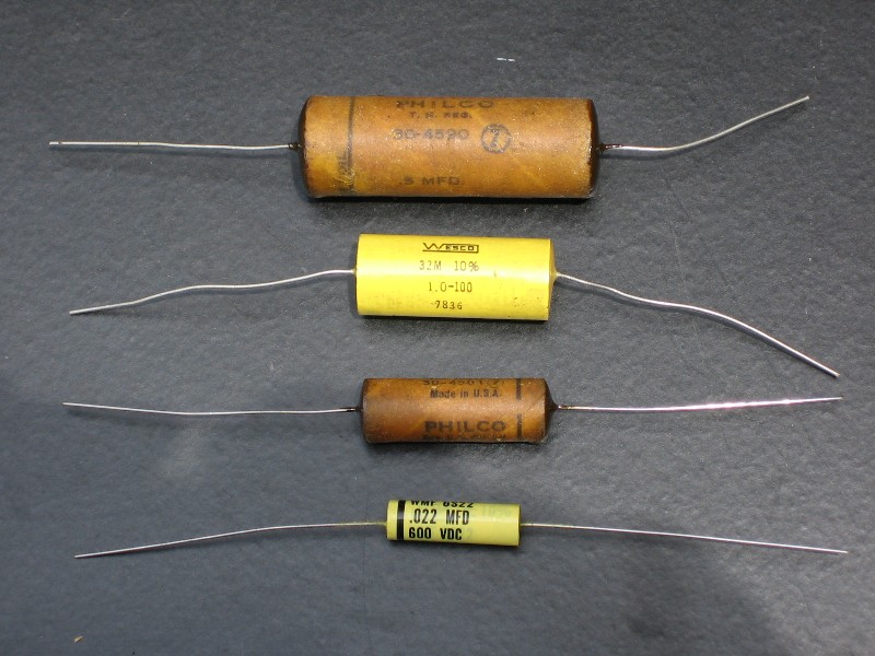

No, replacement line caps will look different and may be either ceramic or film. It should be a Y rated cap as Morzh explained above. You may be able to cut open the original cap and remove the paper assy and replace it with the modern one so it looks original.
Are you planning on restuffing the original wax caps with modern film replacements?
