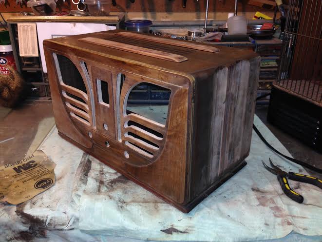

The brand I use is Mohawk. I like the consistency but it does not always fill all the grains. I will sometime have to do 3 or 4 applications when 2 is about usual. I have not really used any other kind so I cant really compare. This can has covered 10 radios and I still have 3/4 of a can.
As for the 45, I have done all the grain filling, diluted with mineral spirits to the consistency of pancake mix when you want thinner bigger pancakes,lol
After grain filling I attached the top moulding with woodworkers glue and clamped.
Now to wait 24 hours and then lightly sand with #0000 steel wool and tone this baby.
