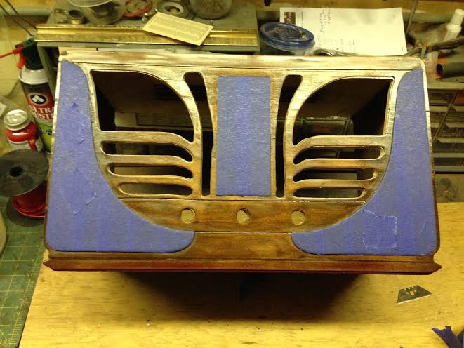

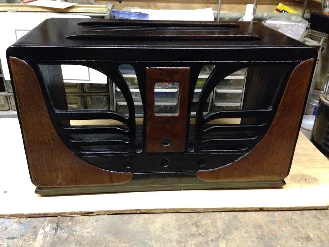

Ok, my 45, the grain filler is dry, #0000 steel wooled, and then body toned with perfect brown.
Next I taped off the the top veneer, and coated the whole cabinet with black toner, Inside and out.
The next step is to add the whitish yellow stripes and the Philco decal. Then I'll clear coat the entire cabinet with sanding between coats.
