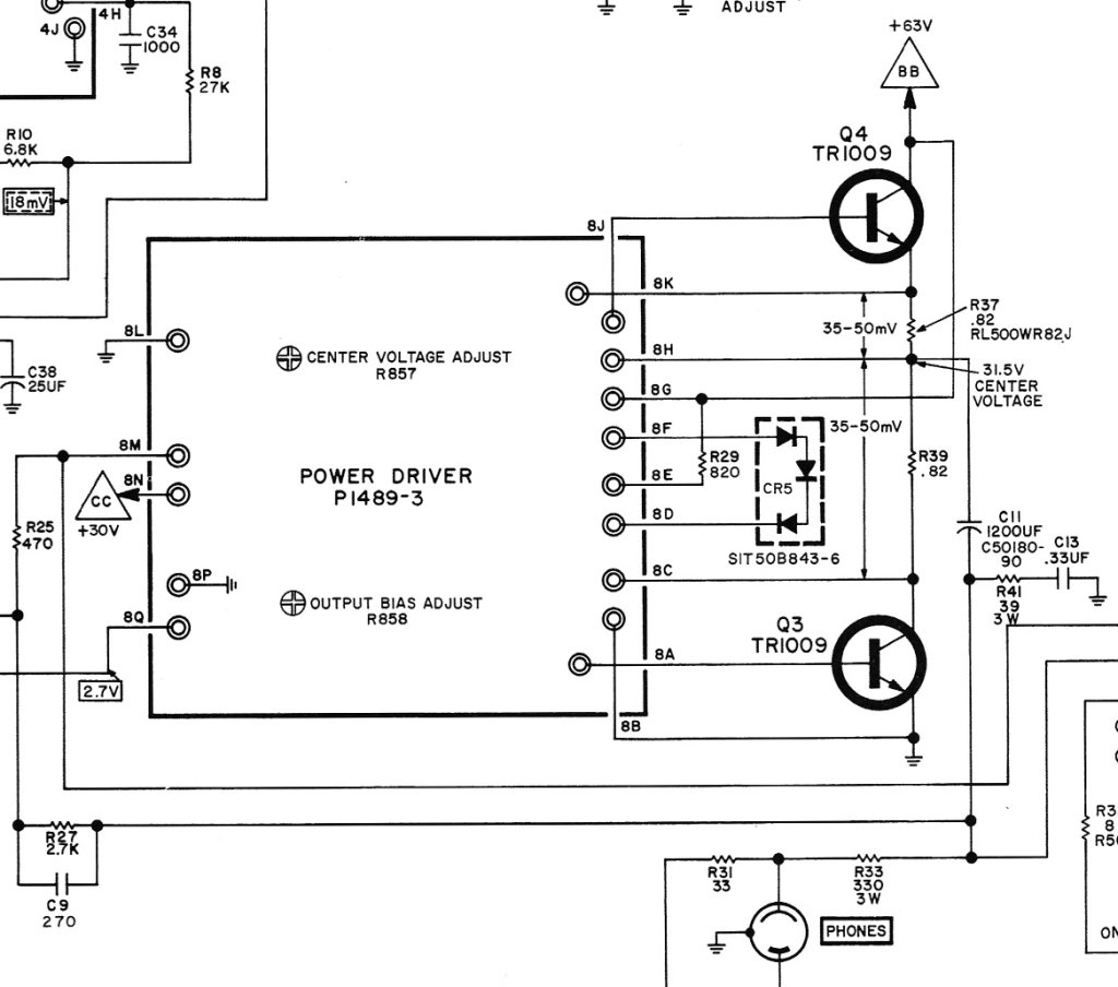

Well, Mondial, you beat me to it. But I'll go ahead and post the partial schematic of one of the output channels anyway, for the edification of anyone else interested.
[Image: http://www.philcoradio.com/images/phorum...output.jpg]
$2.85 each, eh? Well, that is less than I paid for each of the ECG162s that are, most likely, lost in the mail.
What do you suggest for a wattage value for the two 0.82 ohm resistors, R37 and R39? I still need to order these, so it's just as well that I get resistors and new transistors from Mouser at the same time.
