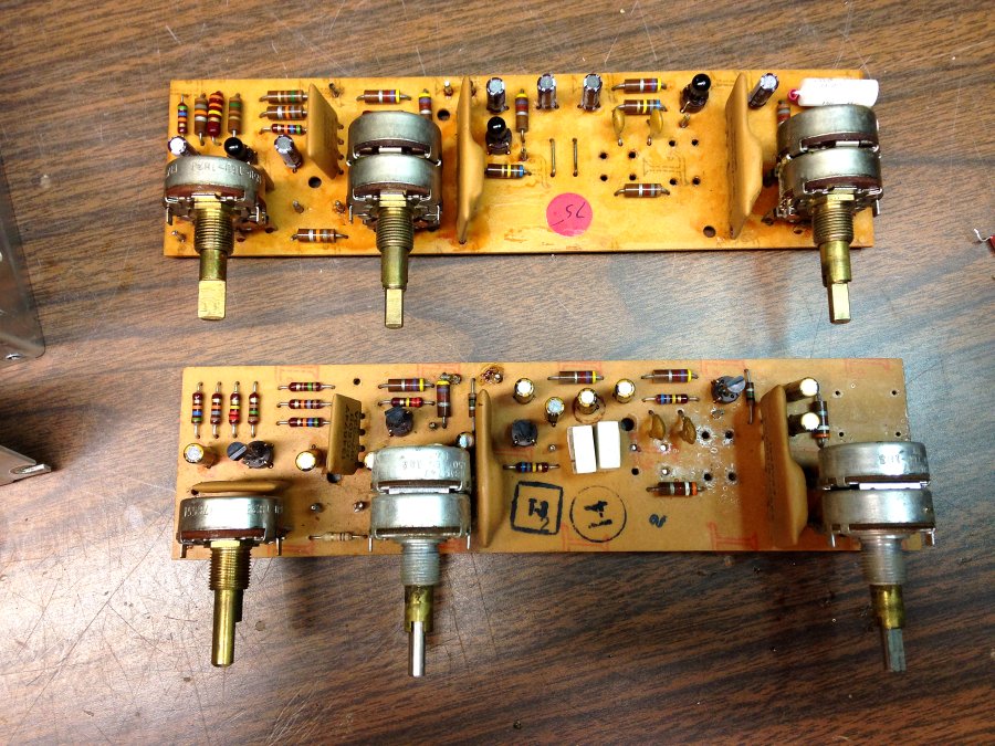

You may recall that I had traced distortion in my 700-T to the control amplifier board.
So last night, I pulled a control amplifier board from a junk 440-T. The board is very similar to the 700-T board; I felt the very slight differences would not make any difference.
Here are the two boards:
[Image: http://www.philcoradio.com/images/phorum...00-T_4.jpg]
The 440-T board is at the top in this photo, with the original 700-T board underneath it. I put new electrolytics into the 440-T board. Did you notice the two jumper wires in the middle of the 440-T board where the 700-T has two white capacitors? Well, I removed the jumpers from the 440-T board and put two capacitors in place of the jumpers. The capacitors are needed in the 700-T as part of the low filter switch circuit, something the 440-T does not have.
I tested the transistors in the 440-T board and all were OK, so I put them back into the board.
So I installed the 440-T board into the 700-T this morning...and then tried it out with headphones.
Verdict: Sounds good Icon_thumbup with no noticeable distortion.
