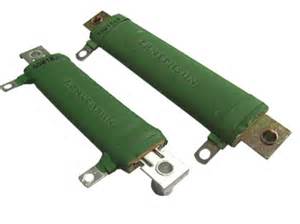

is there a source for these chassis mounted resistors somewhere?
what are they called, how do i hunt them, terminology and such.
Does anyone have these i can trade out for ?
of all my options, i can install my mouser gold looking chassis mount resistors but would rather pick something more vintage looking if possible.
where can i find a site that has these?
looking for about 600 ohms.
I have two 2700 ohm resistors of this type and put them in parallel but that brings my voltage too low at the 6k6's.
i believe that 750 is actually my sweet spot
even all of my new 50watt adjustable ceramic types get way too hot to touch unless i mod them to be heat sync chassis mounted.
i am starting to wonder if i should look at 100w or 75 watt.
with only 800ma here, i am starting to really scratch my head, by the numbers 50 watt should be way over kill but it seems not.
Do not be so concerned with the voltage on pin 3 of the 6K6 tubes. It can go to 315 V or more safely. What is really important is the voltage on pin 4, which is the screen grid. If the voltage on pin 4 is around 250 V or less then you are fine.
Check this voltage on pin 4 as I believe there is a dropping resistor which reduces the voltage to it. It appears Philco ran a higher voltage on pin 3 but reduced it on pin 4 so the tubes operated within there ratings.
Any power resistor that is not heat sinked to the chassis will get too hot to touch. They will reach several hundred degrees at their rated power and is perfectly normal.

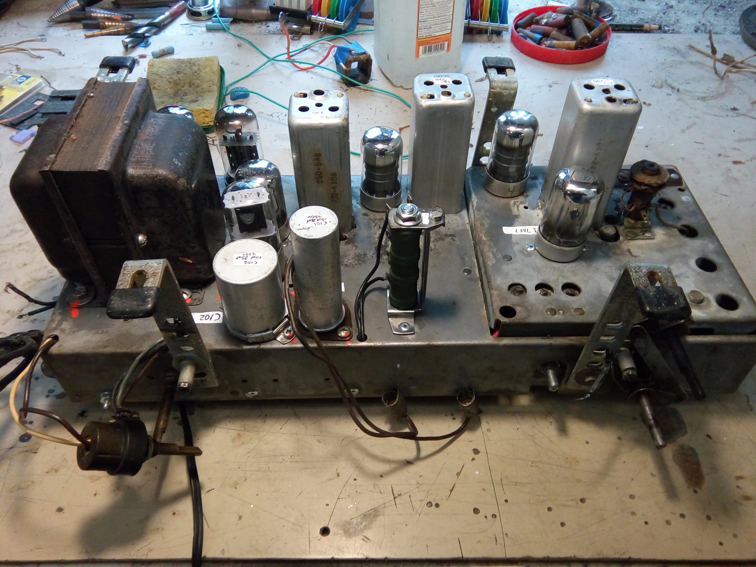

of all the resistors i ordered, this one i had laying around worked out best.  its 611ohms total.
wired it in and placed it outside among the tubes.  there were two convienent holes already waiting for me to mount this resistor right where there are no other components below it.  seemed like the radio was trying to tell me something,, like "put that resistor here!"
During long operation of radio i can still touch the resistor and not get the ouch factor till about 5 seconds so its doing its job wicking heat.

another thing i learned,,
when replacing loktal sockets,, the factory rivit is best because its lower profile.
the ones i show on my far right closest to you in the pic above shows a standard rivit.
it stands too tall bumps into barely the bottom of my 7AF7 tube. This tube still snaps in place fine but i sure its not ideal.
a little file work would fix it but i wont bother now,, its not broke so i wont fix it.
