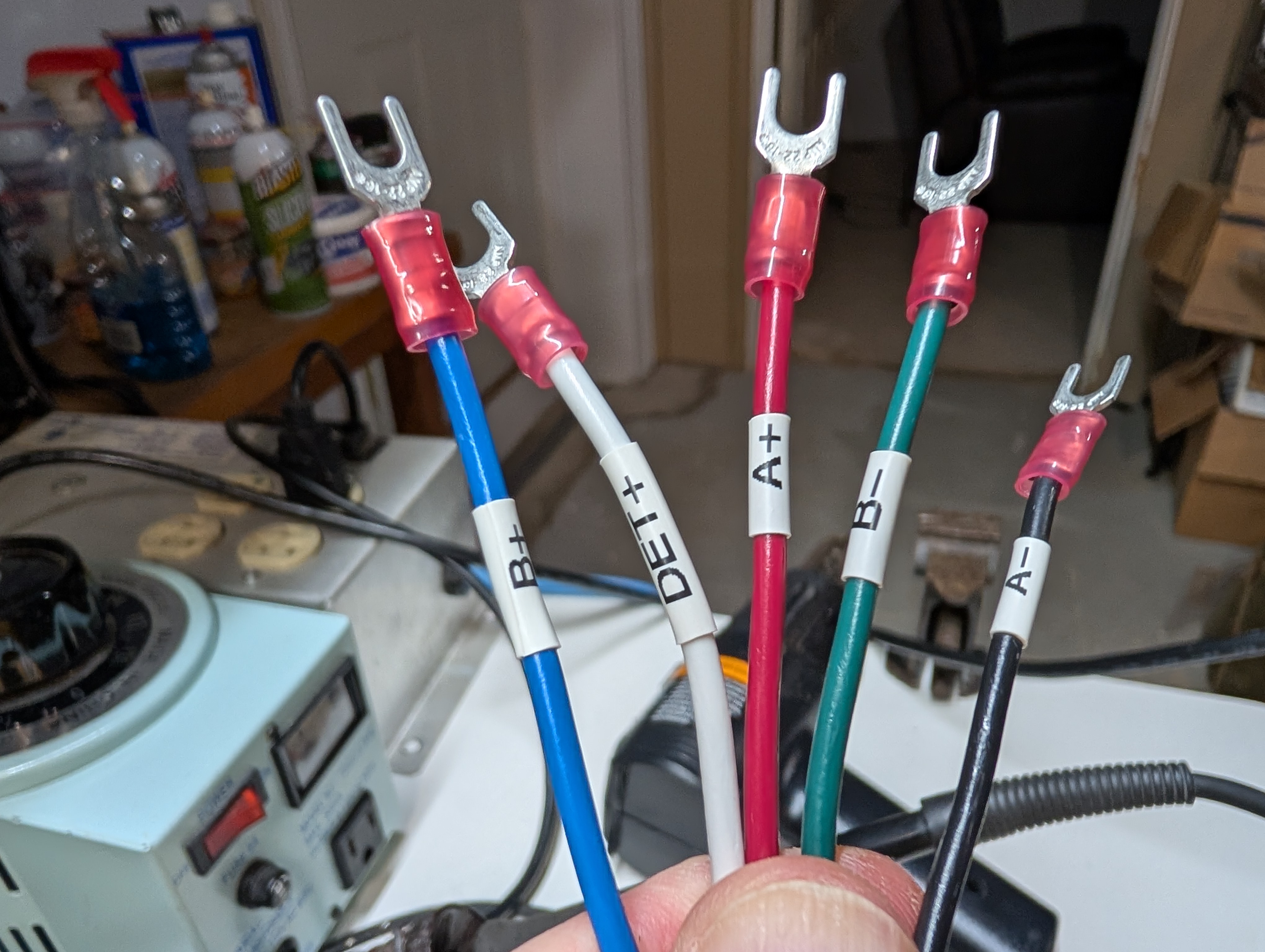

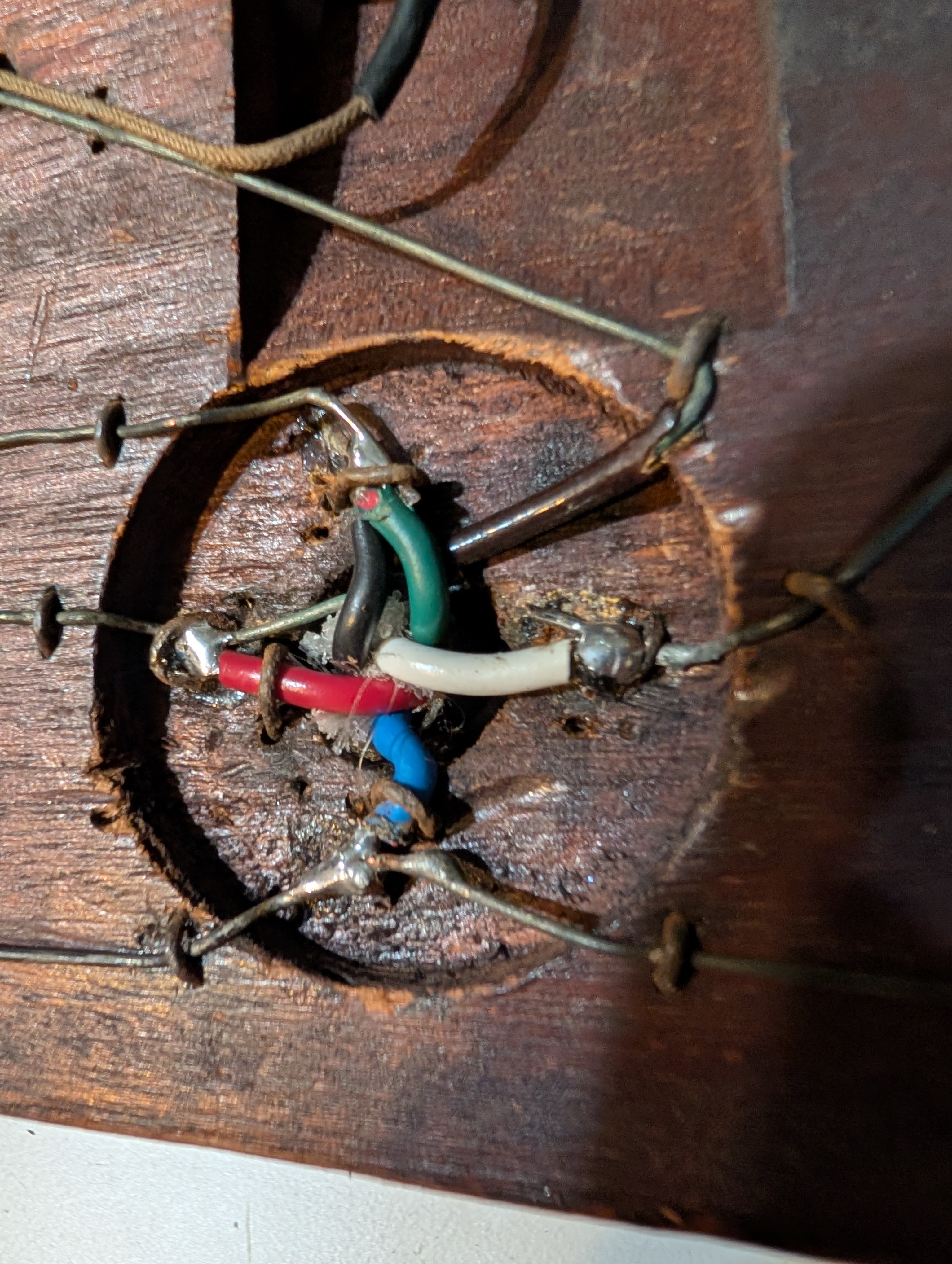

I decided to go with 5-wire harness, as the original was. They had two wires together, the Green and the Black (B- and GND).
So, this is the bottom:

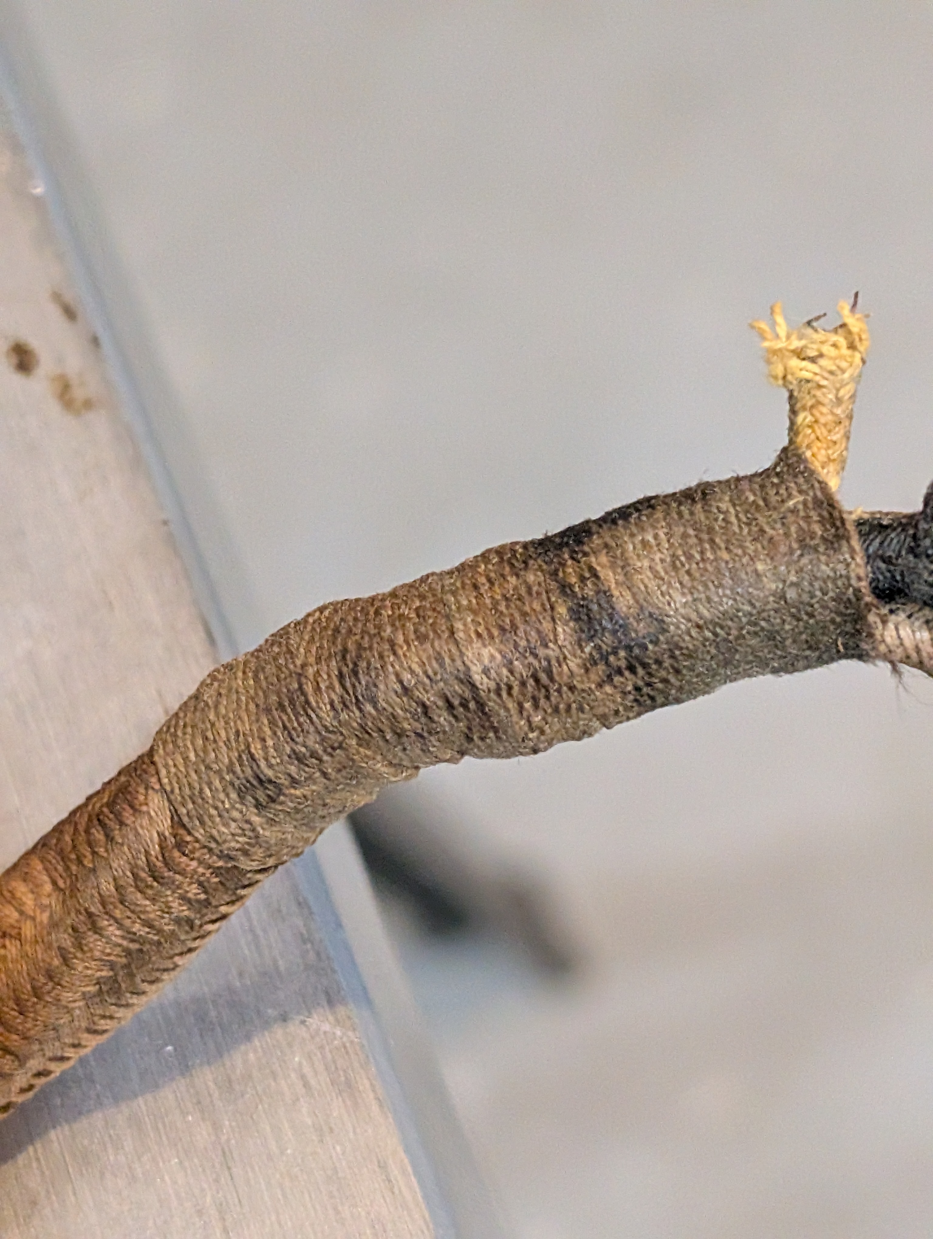

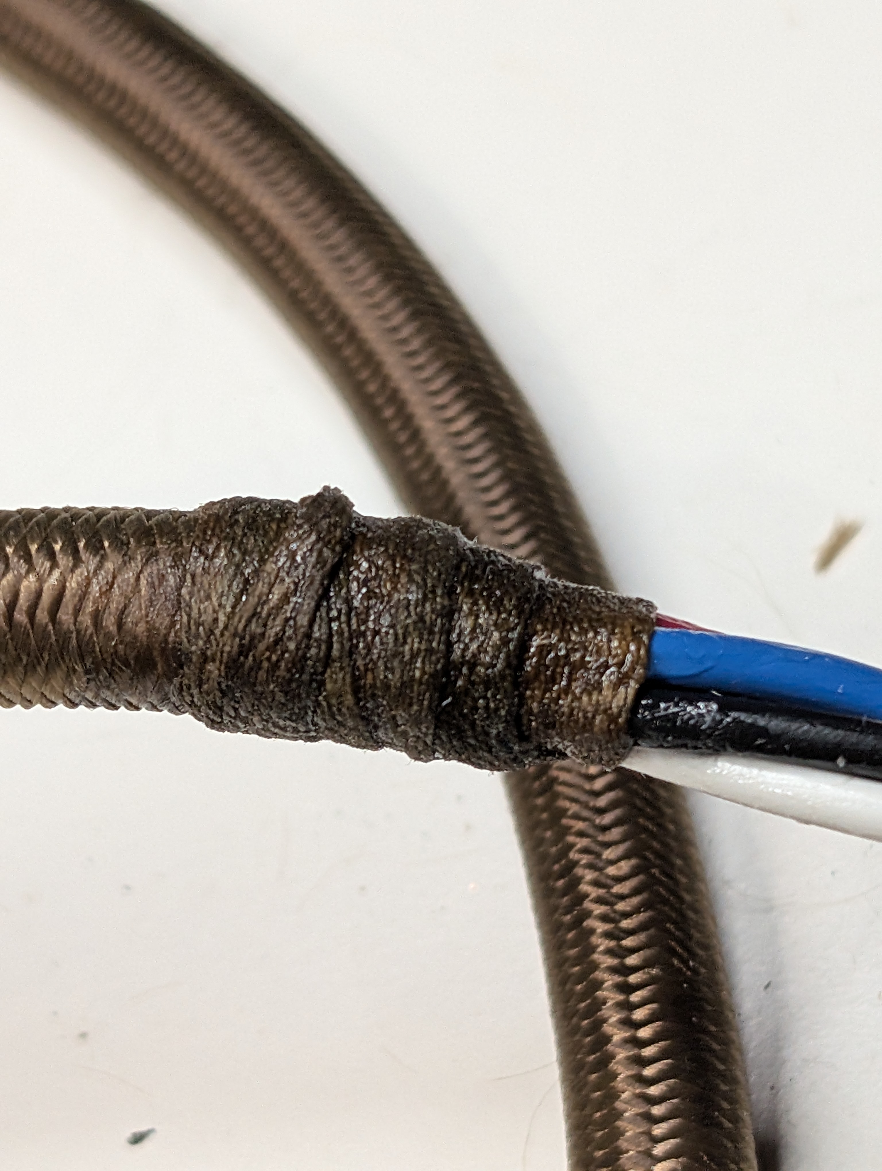

Then I dressed the cable. I unwrapped the original cable
and reused the wrap on the new one to bandage the end that goes towards the battery. The other end received a heatshrink to dress the braid.
And the Batteruy/ARBE end is this:
So, all is ready to start.

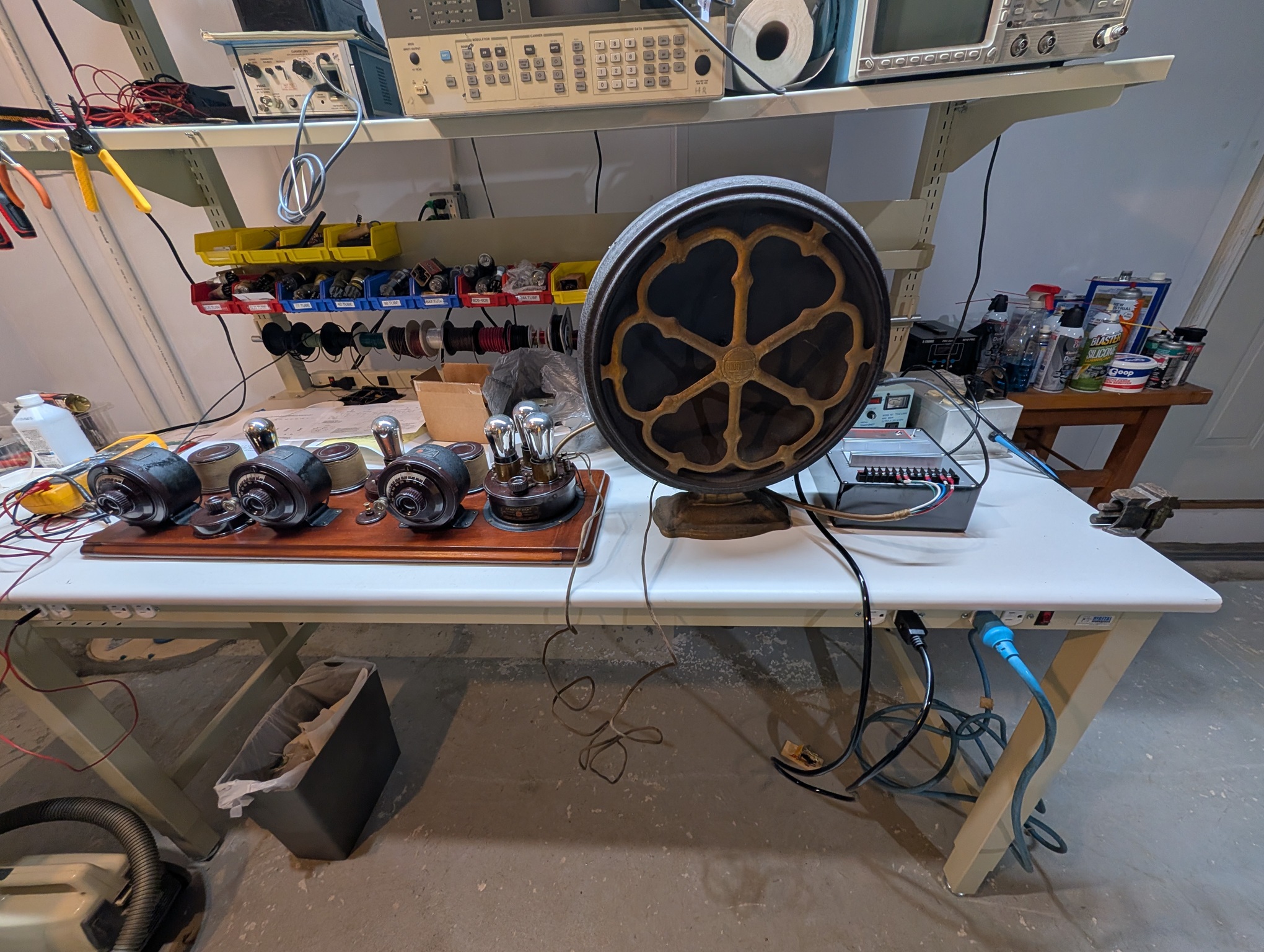

So, today I connected the radio to ARBE, connected the GND to an outlet's GND, used a piece of wire for antenna (I do not have a really long one) , put UX-201A in all 5 sockets, connected the "E" AK speaker and started the radio.
There was some weak noise, looks like RF, then at some position of one of the tuning caps the radio started generating. As if it were a sinewave sound oscillator. The other two tuned circuits would make it louder, the potentiometer could make it weaker or disappear.
I spent overall 20 minutes with it, but no station, just that whistle.
Good news is, the speaker and the amp work.
I think I will try to put BC band modulated signal through, see what comes of it.
