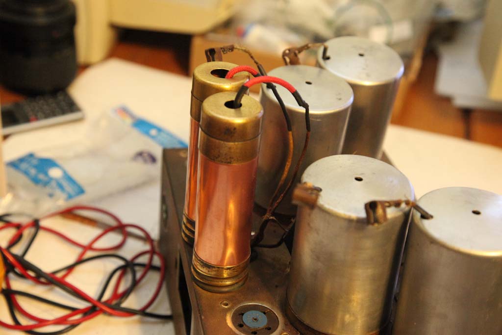

The Mershons

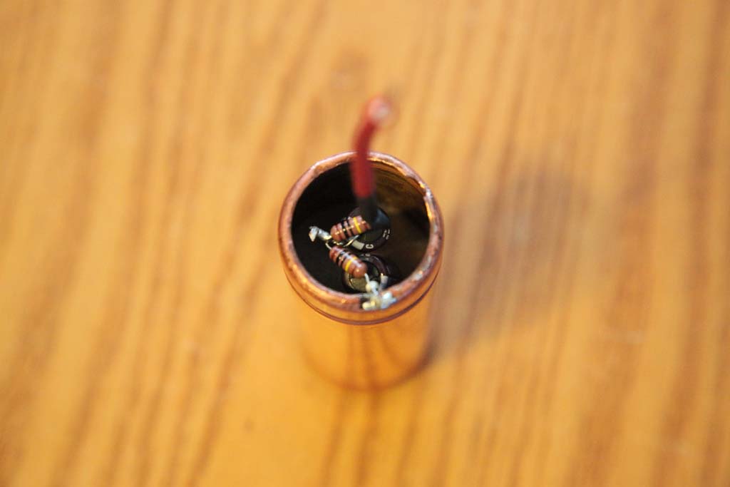

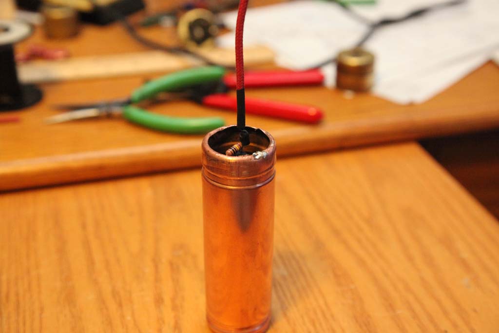

Just so nobody gets scared.....I potted part of the caps so they stay put and the wires do not touch the shell. It is pretty sturdy. I showed it before I potted it.

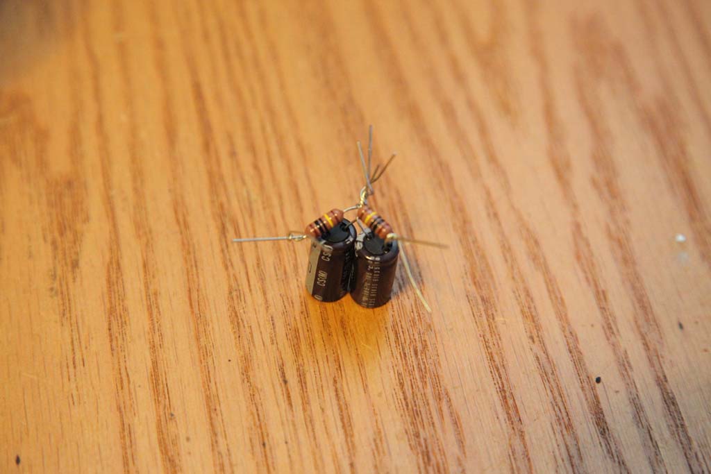

I used two 10uF 350V caps, and I equalized the leakage with 1M resistors.
When I use 450V caps I do not add resistors but with 350V I do.

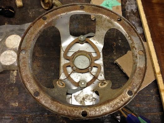

The speaker would not help anyway,
See below, Icon_eek
Yyeeeeah........you're right, this one wouldn't.
What did you do to the cone? Icon_lol Sold it separately?
