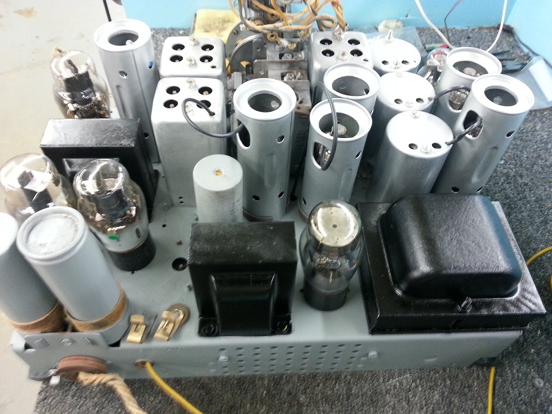

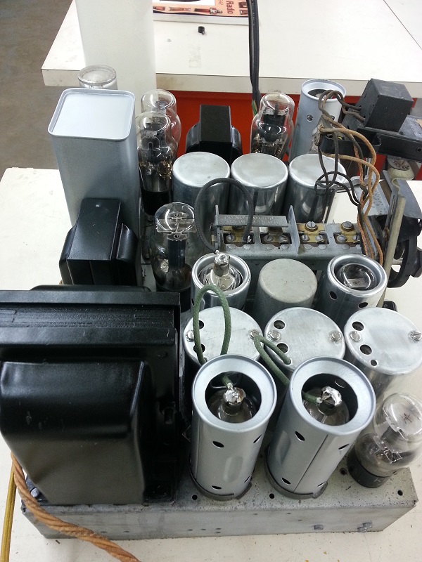

I have to ask this. Is your chassis restoration guy related to Nucow? Those IF and RF transformer shields on the 4-band chassis should be bare aluminum, never painted. The same goes for the tube shields and multi-capacitor can on the 5-band chassis. Those were tin plated steel, not painted green.  It's OK to polish them to a nice shine but why paint them green when they were never painted that color from the factory?
Yup, nit-picking again. But those painted shields detract from an otherwise great looking chassis.

I did the work on chassis Ron, Dick helps me with the hard stuff and likes to keep parts looking original also, may be I could remove the tube shields and have them tin plated . The aluminum IF cans were pitted and i tried to polish but didn't look to good. So I sprayed them with self etching , like a zinc chromate primer to protect from any more detereation . Theirs a plating shop in town , im sure the cost to plate each tube shield would be expensive . Thanks for your input Ron.
You could paint the tube shields with Krylon Satin Nickel. No, it isn't original, but looks better than green...or aluminum spray paint  ...plus, Satin Nickel is conductive so a shield sprayed with Satin Nickel will still act as a shield.
What sort of polish did you try on the aluminum IF and RF transformers? Mother's Mag & Aluminum Polish is wonderful stuff. Of course it won't work miracles, but some Mother's and a lot of elbow grease can make a big difference on aluminum coil shields and electrolytic cans.

I used a aluminum polish in stick form that is applied on a electric bench polishing wheel . I works good if the metal isn't pitted, I guess I could have sanded out the pits and final wet sand with 1500 grit then re polish. Do you think with the paint on there will mess up the performance of the reception or sound quality ? The tube shields looked like dark olive drab color before I painted them, were those tin plated as well? If they were you mention polishing those , but arent those steel with tin plating ? I made sure that everything that had been painted still had a good ground.

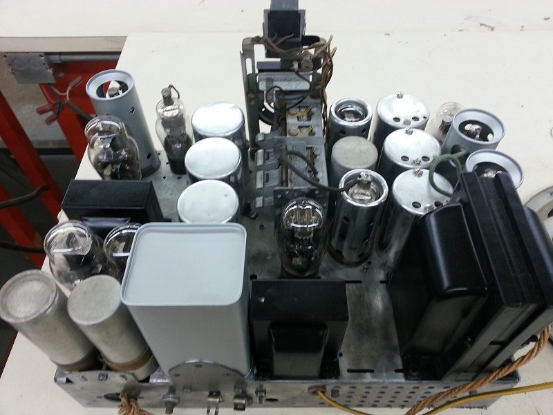

Kind of interested in the difference in power transformers between the two chassis.
Model run change or replacement?

Green is wrong.

I didn't change no transformers, one is early model and the other is late model, you can a slight deference in the two cabinets, the late model is more rounded at the top.
(06-01-2015, 03:02 PM)morzh Wrote: Green is wrong.
I said that a'ready.
Mike, what was it you were saying in another thread about friends being brutally honest about another's work?
(06-01-2015, 02:47 PM)PhilcoMike Wrote: Kind of interested in the difference in power transformers between the two chassis.
The 5-band 16 chassis uses a vertical mounting power transformer.
The 4-band 16, which came later, uses a horizontal mounting power transformer.
Both are correct for their respective chassis.
Well, here it is small things. Fred does superb cabinet restorations. A little green thing here or there is correctable.
It is not like he placed a wrong size font decal on a cabinet and then layered it with several coats of lacquer  The green will come off.

Much better looking now.

Fred, one suggestion. Try to make the wires to the grid caps of the tubes as short as possible when you replace them. If the leads are left too long, you will get stray capacitive coupling between stages. This can result in oscillations, instability, alignment problems or hum pickup.
Aside from that minor point, a very nice restoration, especially considering the original condition.

Not sure if this is ok to post, but I offer silver zinc plating thru my business. Could these pieces be plated with this finish?? I'd be happy to trade occasional chassis work (I'm electronically challenged) for my plating services. My site is www.detailplating.com. If this isn't ok Ron, please delete my post.

Thanks Steve for the offer . Does look like nickel ? Good idea.
