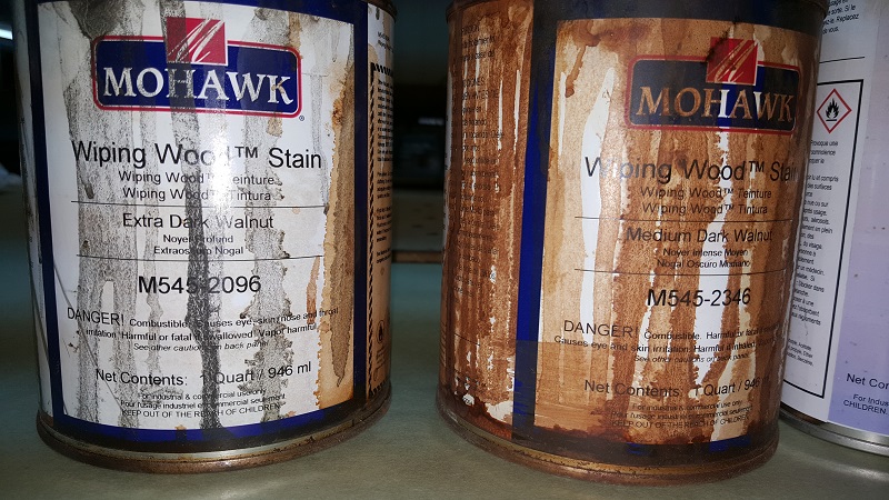

Don't buy anything till I can get to the shop this weekend and see what the part #s are on the products. I will post some pictures of the products used also. Air brush is used sometimes where doing a fade on edges or other areas on cabinet where you want to highlight or do some antiquing or a custom job. I use the stain in the airbrush as a tonner. One quart of stain will go a long long way so get any thing in a gallon. All this staining and toning is done before the sealing is started.
Here is the stains and toners used on the 118 cathedral. Any questions on these products and application please ask for best results. The buffcoat clear is whats on my 118 cathedral, if you want a little more gloss you can add a little piano or instrument lacquer to the buffcoat. If the high gloss piano or instrument lacquer is used , it must be wet sanded and buffed out for maximum results.

-Wiping Wood Stain 'Medium dark walnut' on everything except for front center and wings.

-Wiping Wood Stain 'Extra dark walnut' used to tone front panel mini wings and center darker, fade on bottom moldings and arch

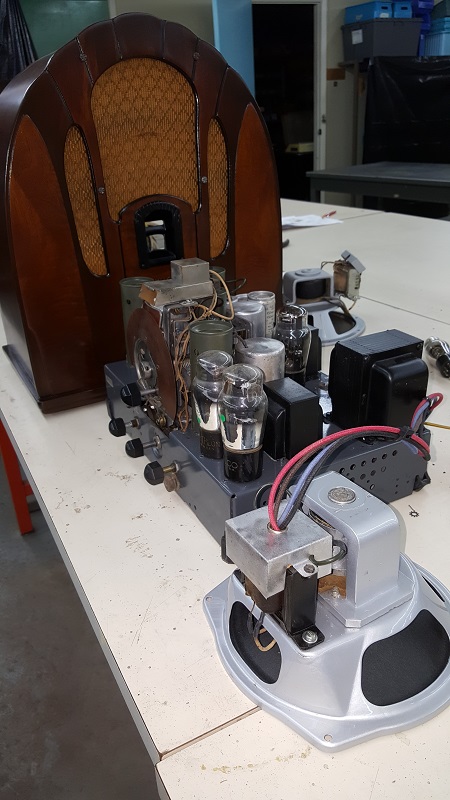

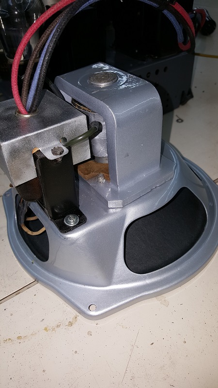

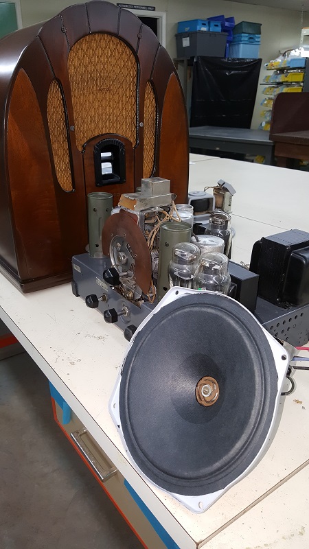

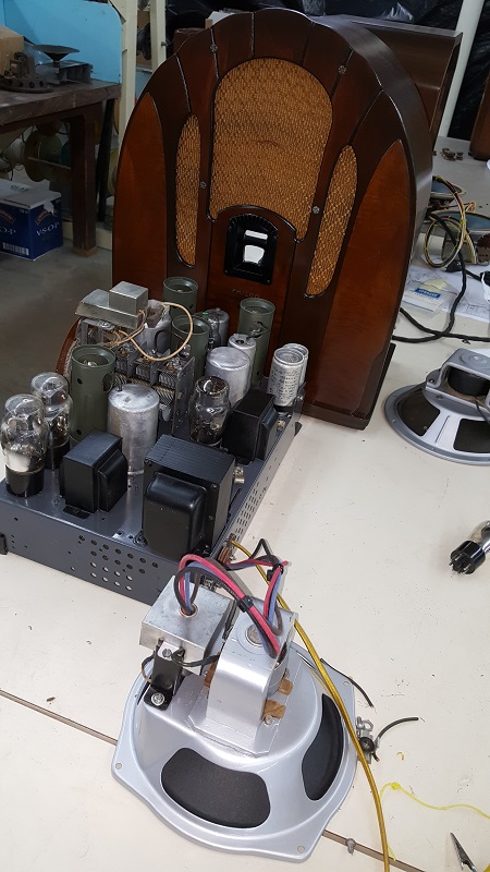

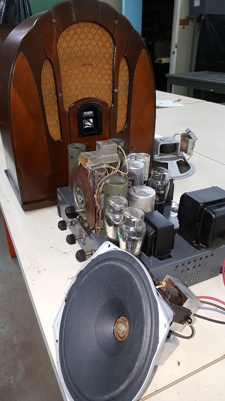

Sneak peek at the chassis that hade been painted because of the rust , got the speaker back today from a recone and now is the time to get her playing and put all back together Icon_eek
It looks sharp!   Icon_thumbup Icon_thumbup Icon_thumbup
