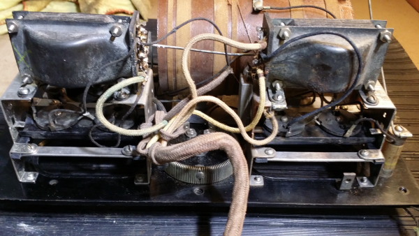

Hay! You Wanna' See What's in the BOX?

The only failures I've found inside the catacomb have been the interstage transformers. And you really have to dig into it to change those.

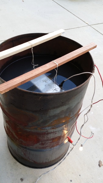

Pictures of the stripping process:

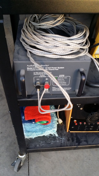

This is NOT the plating supply

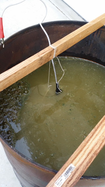

Yes, the crud floating on top came off of the chassis.

Also, I get these 55 gal drums for about $15 and sandblast the inside. The process eats a hole in the bottom pretty quickly. Another reason to be outside. (The agent in the stripping barrel is washing soda. I would not drink it but it is not hazardous)

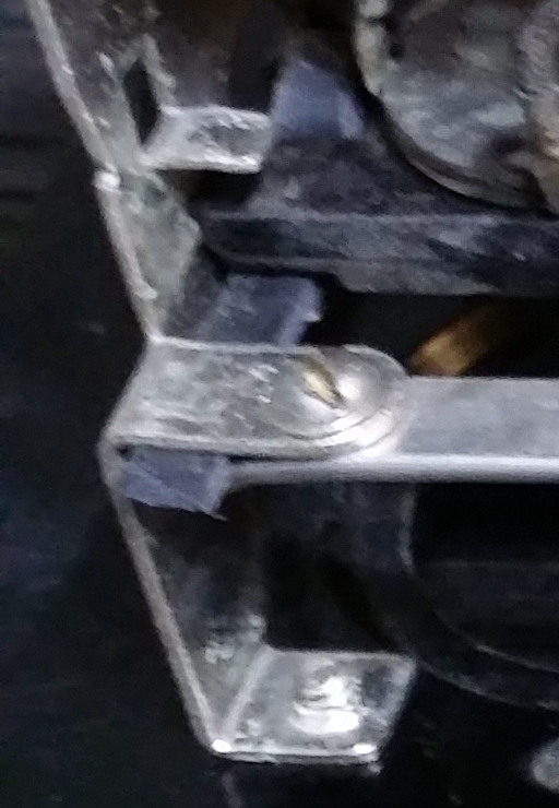

Also trying to find some appropriate material to replace the vibration dampers (lack thereof is keeping me from reassembling the radio and enjoying it). Any ideas?

I am not familiar or don't remember that chassis but if you are talking about the isolation bands like on a Radiola III or the early Federal radios (59, 58, 61 and such) then I use heavy rubber strips cut from flat material that I got somewhere(?) probably old Telco projects/waste. I think I used the last of what I had yesterday to mount the C supply (transformer supply removed from a wall-wart) inside of my new power supply project. I am going to have to see if I can find some more. It is a little less than 1/8 " thick, black rubber.

Closeup of anti-vibration/microphonics suspension.

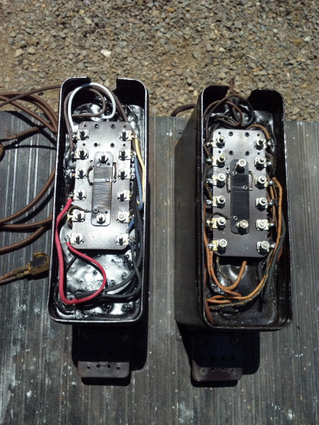

Also (again) I would not try "digging" out anything in a catacomb or any other potted device , like an AK power supply. I use a oven, also outdoors and carefully monitor the temperature to de-pot these devices. The setup prevents unexpected movement (weight CHANGES as the tar/wax melts) and catches the tar for repotting. All of these devices are completely rewired.
An AK supply After/Before rebuilding. You know that the transformer can put 800+ volts on some of that crispy old wire. Every time somebody says "just dig out the caps" it make me cringe Icon_rolleyes

In my example the 55 gal. drum is the anode. There are a lot of those drums around here, cheap, used for burning barrels. When I rot one out I get another dropping off the old one at the metal recycler on the way. I usually fill the old one with other metal scrap. They will actually pay for the scrap but I usually just drop it off and move on.
When using a high current supply there is a lot of gas coming off. This also depends on the size of the item you are derusting. 12V seems to be about right (other voltages for plating). So watch your supply for a voltage drop. If it is cutting back (regulated) it probably isn't big enough.
PS: That is REAL WE wire on the supply. It is probably worth $!,000.000. It makes my supply sound better with clear highs and a solid bottom end (not like mine) with just a whiff of lavender. Icon_lolno Icon_crazy
Remember when Circuit City went out of business? That supply ran the local car radio display. It was hooked to a battery and could deliver 300A that way. I run it without the battery (heavy enough). The supplies are expensive but when they were closing I got it for - - - $25.
