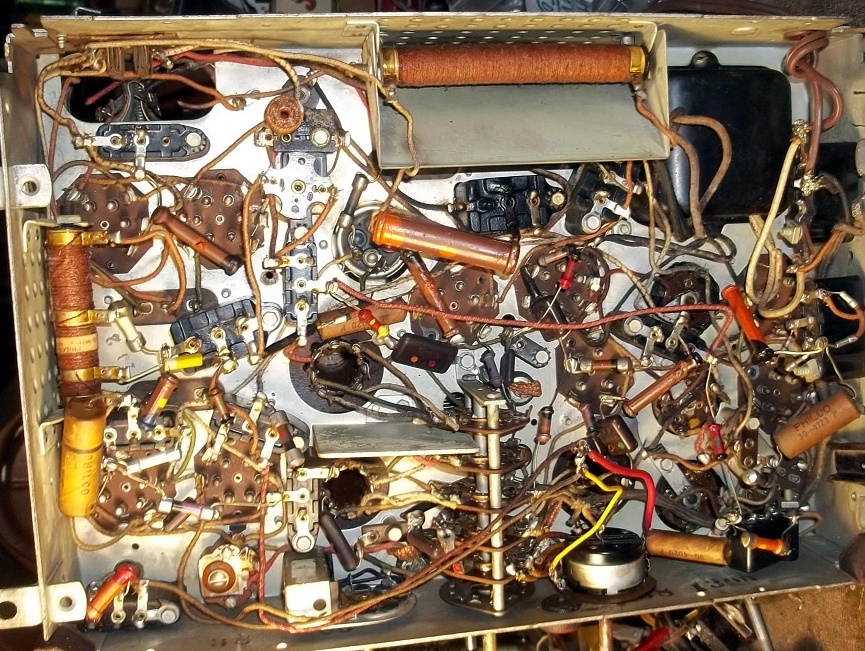

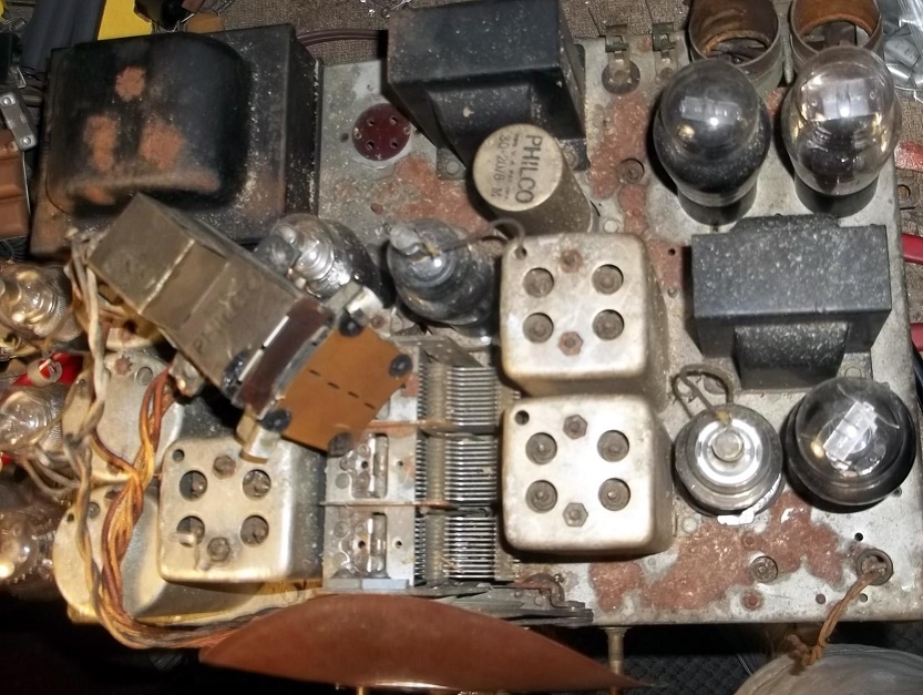

Here are some pics of the parts chassis I received. I was told it's a 116, but the tube layout (and tubes) are identical to those used in my model 16, code 125. Also it has 4 bands, as does my 16. I thought most of the 116's had 5 bands?
Anyhow, can someone identify which I have based on these pics?

(09-18-2016, 10:34 PM)NostalgiaRadioTime Wrote:  ...Here are some pics of the parts chassis I received. ...can someone identify which I have based on these pics?
That isn't a 116 chassis - it's a 4-band 16.
I am going to send you a PM about the drive mechanism on your parts chassis.
