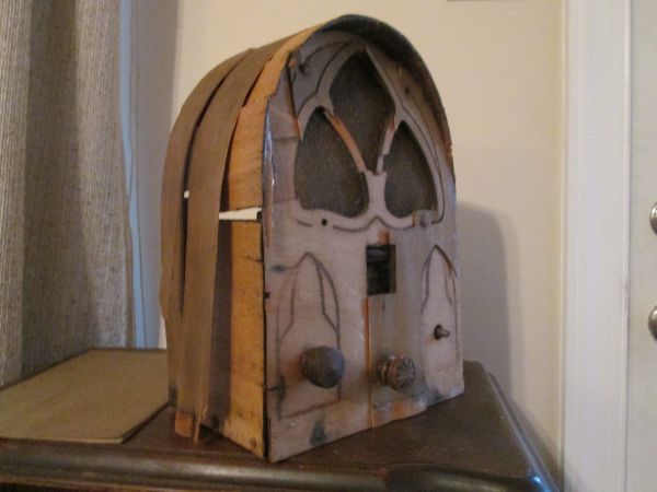

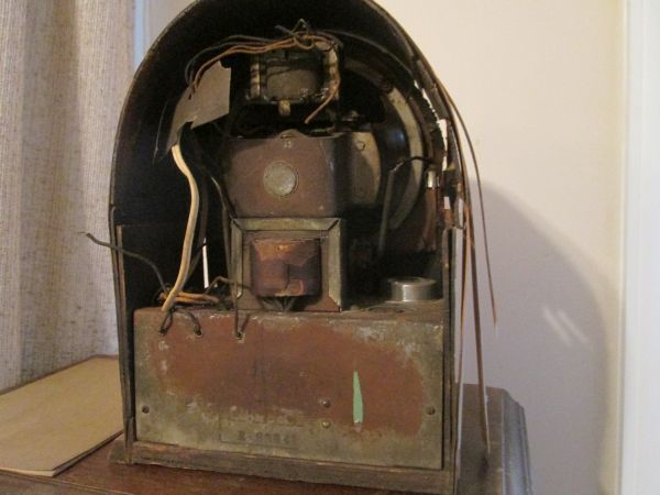

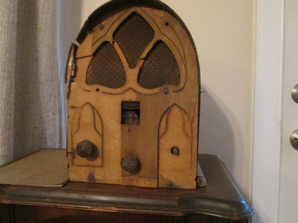

Hey Buzz,
If you have a couple of minutes to do a quick repair I have your mystery set's cousin. Should be a quick repair.
Your volume control isn't really a volume control but a rf gain control that's why it's a much lower resistance than a normal audio volume control. If you would like a bit of an explain of how it work read this starting at post 16. http://philcoradio.com/phorum/showthread...481&page=2

You're right...they are cousins haha...Looks like the Philco 10k pot I ordered will work then....thanks, Buzz

great work Icon_clap Icon_clap   way too funny with dickel Icon_lol
terry that that thing out back and bury it Icon_sad

Bury it...Icon_sad no way...It will be beautiful... Icon_clap
