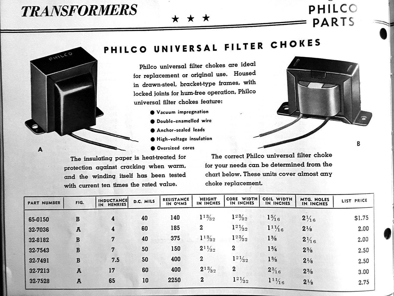

Well, things have been going well when, while going thru the alignment, one of the filter chokes opened up. It is Philco part number 32-7491. It is shown on the schematic as having a DC resistance of 400 ohms. I can't find what the impedance or current rating is supposed to be. Does anyone have any information for a suitable replacement?
I am not really sure why it opened up all of a sudden, as the radio has been playing very well for weeks. This choke does supply the B+ for the IF stages and the discriminator circuits. Is there anything that I may have done in the alignment process which could have caused the choke to open up? I can't think of anything. Nothing appeared abnormal, no mistaken shorts. (I was using an insulated tuning stick.) Maybe the choke was just on its last legs to begin with.

It could just be its time. Supplying B+ is about conducting some decent amount of current, especially in a beast like 37-116.
I would check if any tube decided to short on you, but in all likelihood it is just the choke having decided to quit.
Check it for simple stupid leads breakage, oxidation etc. I had the one in my 16 being open, then upon opening it up and resoldering the lugs it just came back. Not sure how.

According to the choke specs from the 1949 Philco Parts catalog it is 7.5H, 50ma.

Thanks Nathan and Morzh for posting the choke specs. I thought I had a choke from another chassis, but it had been replaced by another which wasn't even close to being the right choke. I have subbed in a 400 ohm power resistor on a temporary basis. I am only seeing 40 mils across the resistor, so think the old choke just gave up the ghost. I checked for a shorted tube, finding none. The old choke is wide open. Doesn't smell or look like it had over heated, and the spare chassis had a replacement. I am thinking it might be a common problem?
I'll start looking for the correct choke, or at least something close. It is in a pretty tight spot.
