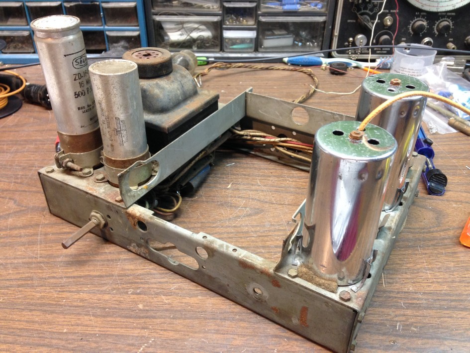

The IF cans are also back in place:
[Image: http://www.philcoradio.com/images/phorum/37640_029.jpg]
Two more caps and two more resistors, and the right side of the chassis will be finished. Then on to the left side...

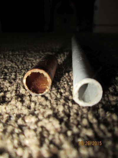

  One thing that I have been looking for are sources of smaller diameter cardboard tubing in order to make replica capacitor shells. So far the smallest that I have found are maybe 5/8'' inner diameter tubes from a Saran wrap or wap paper rolls. I have heard that one source of smaller tubes are those wire hangers that the dry cleaners use but I haven't found any of those yet. I was looking at tubing for fireworks but they seem to be thicker walled then capacitor shells.
Arran Wrote:One thing that I have been looking for are sources of smaller diameter cardboard tubing in order to make replica capacitor shells.
Back when I was working I was wearing company supplied uniforms. The pants hangers used a cardboard tube to support the weight of the pants. These tubes are just about perfect for making new shells for replacement caps. An old tube from a Sprague .1 600v is within a mm or so. New Mylars fit easily inside even though the wall thickness is bigger. Each tube is long enough to make about a dozen shells.

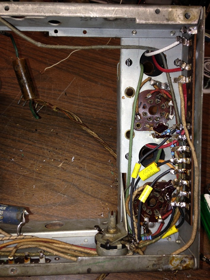

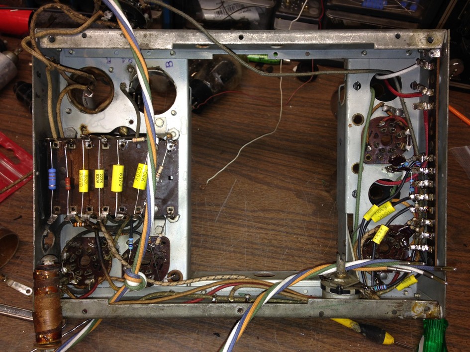

Progress:
[Image: http://www.philcoradio.com/images/phorum/37640_032.jpg]
Almost finished with the right side. I only need to add one more capacitor and one more resistor here.
Plus, I will also have to attach new wires to the shadowmeter, rebuild the shadowmeter lamp assembly and add new wires to it, and reattach all four inside the right side of this chassis.

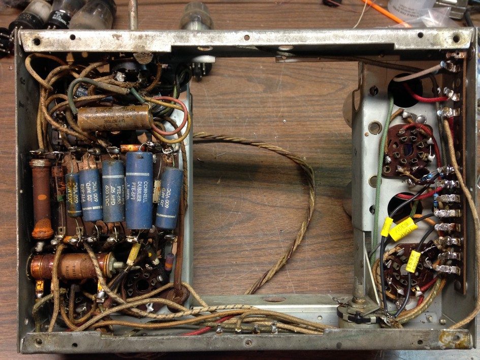

Meanwhile, I moved on to the left side:
[Image: http://www.philcoradio.com/images/phorum/37640_030.jpg]
[Image: http://www.philcoradio.com/images/phorum/37640_031.jpg]
Almost all of the tubular capacitors and almost all of the resistors have been removed. Only a few more to remove, plus removing and rebuilding the aluminum can electrolytics, then replacing all of the caps and resistors (save for the large two section wirewound resistor), replacing the speaker cable, and replacing the power cord.
Once that is done, I can move on to the most fun part of the project - the RF unit. Icon_thumbdown

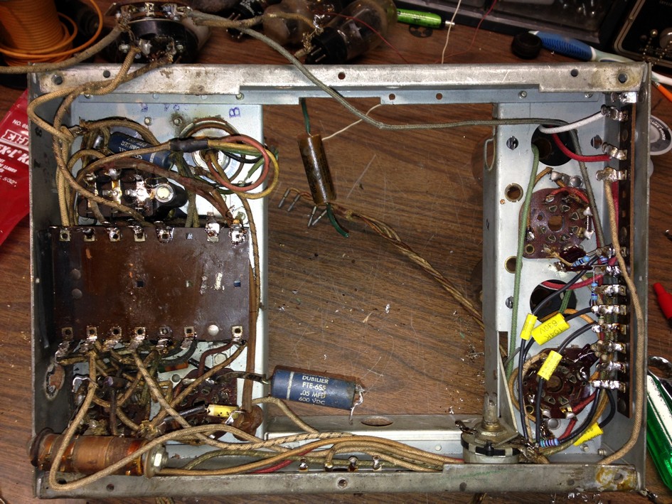

After another hour or so of work:
[Image: http://www.philcoradio.com/images/phorum/37640_033.jpg]
Tomorrow I hope to finish replacing the paper caps and small resistors, then turn to the two large aluminum electrolytics.
I've also removed the single bakelite block which contains the two line-to-ground caps. Those will be replaced with safety caps.
Icon_yawn  ...time for bed...

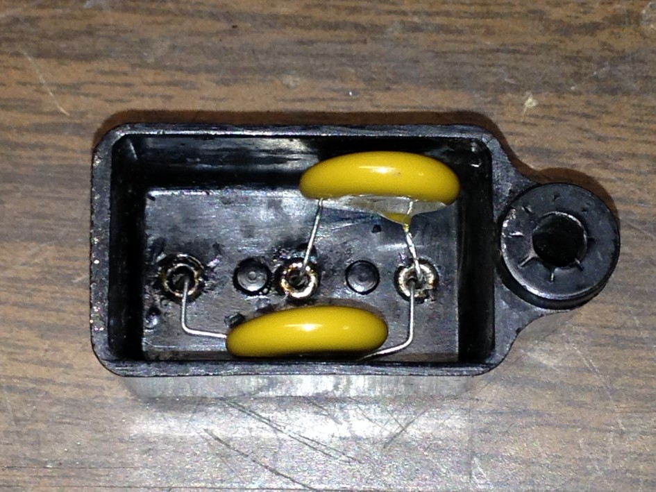

The death caps having been replaced...
[Image: http://www.philcoradio.com/images/phorum/37640_034.jpg]
I then set the bakelite block aside and continued with the left side of the chassis.

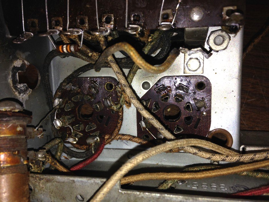

I had to remove almost everything around the 6F6G output tube sockets in order to be able to replace parts and replace the speaker wiring harness:
[Image: http://www.philcoradio.com/images/phorum/37640_035.jpg]
I made a new wiring harness using four different colors of cloth-covered wire. Man, that is getting hard to do with my arthur-itis.
I unsodered the push pins from the original four wires and soldered them onto the ends of the new wires.
Here you go.
[Image: http://www.philcoradio.com/images/phorum/37640_036.jpg]
Man, this side is really difficult. More difficult, I think, than the RF unit is going to be. I keep getting mixed up on rewiring the two output tube sockets. Icon_crazy
