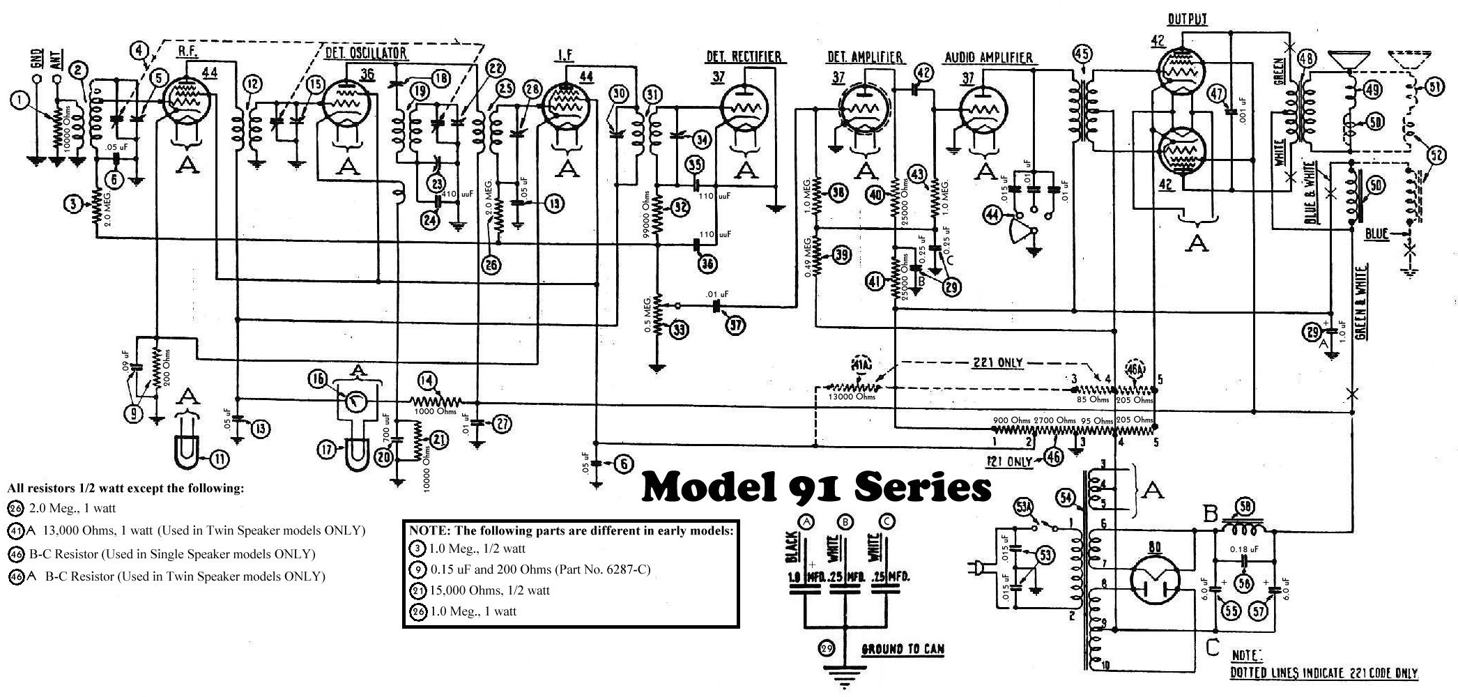

I've gotten back to this model 91 and am recapping. Bakelite block cap#9 ( 6287-C ) is a 0.15uF with a 200 ohm resistor. (The resistor and capacitor are wired in parallel.) Here's a link to Ron's annotated schematic:
http://www.philcoradio.com/images/phorum/schem/91.jpg
So I got the resistor out and could use it but the lead is very fragile (I think I lost some of the wire strands in the process of removal) and its probably better to replace it. I'm not sure what wattage would be used, but it looks like a wirewound resistor. Does anyone know if a 2 watt 220 ohm resistor would work OK in the circuit? Thanks!

I would just trim the ends and reinstall the loop.
Did a quick calculation and 2w is plenty, came up w/abt .25w.

update: I looked at the resistor package that was embedded in the bakelite block and was able to unwrap it. Here's a pic of the insides. Just a resistance wire bundled into the paper package. As Steve suggested, I was able to easily trim and strip off the insulation on the ends, repack it and wire it back in place...easy peazy.
