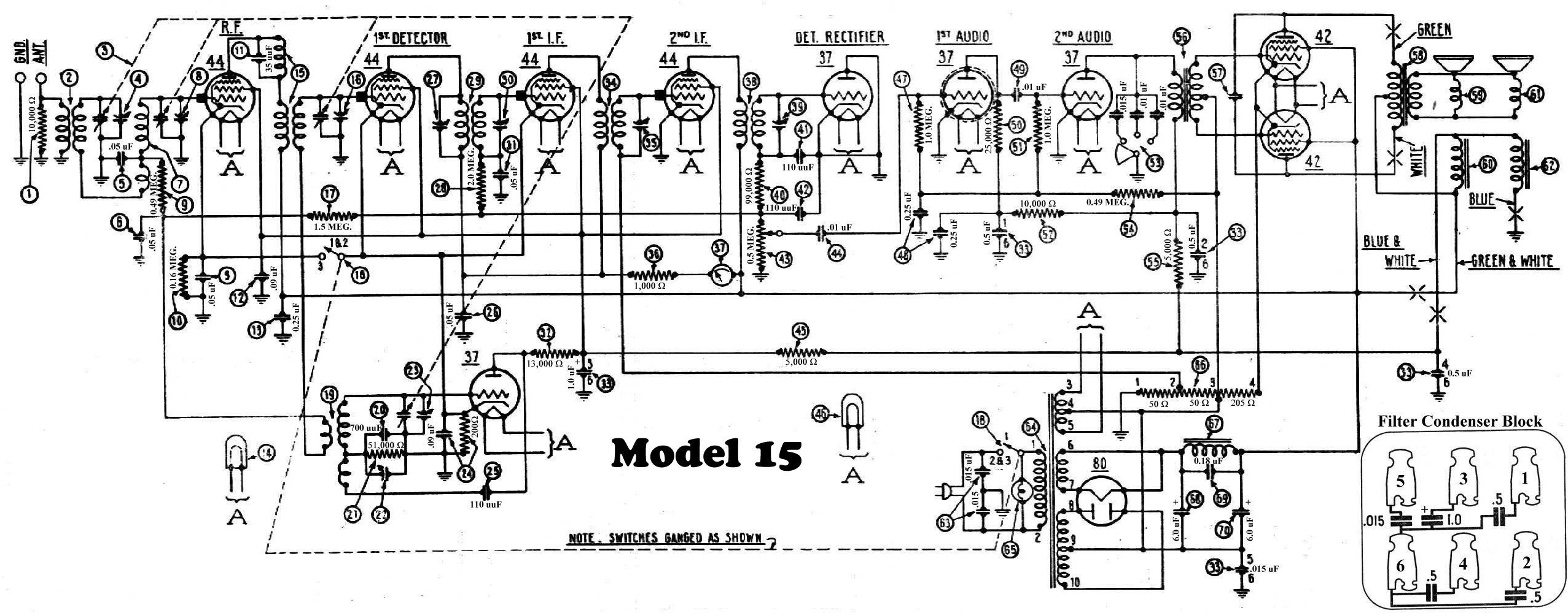

If anyone has a 91-121 or 91/221 ( broadcast only) radio and you want to check, please see if your on/off switch has an extra "on" position (far right) that affects the sensitivity. The schematic and 44RF cathode tube socket data don't make sense as shown, thank you Terry, but 25 volts with the switch off and 5 volts with it on could account for this. The schematic and tube voltage data are here: http://www.nostalgiaair.org/Resources/884/M0013884.htm

This sounds like either someone adapted the model 15 local-distance circuit to a 91, or else this is yet another of those undocumented factory mods.
Take a look at the model 15 schematic and see if the switching circuit is the same:
http://www.philcoradio.com/images/phorum/schem/15.jpg
The 91 on my bench at the moment has only the ON-OFF function.
Thank you Ron and Bob, that local/distance switch in the 15 schematic matches what I have. Checking the tube socket data for the 15 shows 30 volts on the 44RF cathode (only one listing). Going back to the 91-121, should all of them normally have 25 volts on the 44RF cathode unless they were a factory or "aftermarket" modification?
