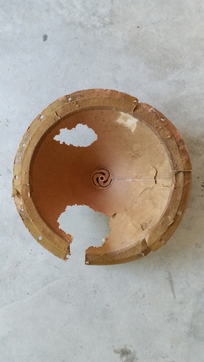

The poor cone - which had been patched up in our early 2000's work had now deteriorated to a very poor state:

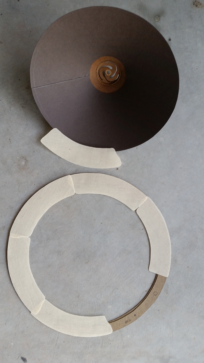

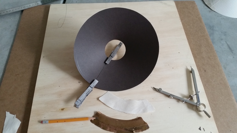

I found some suitable card on-line, and worked out the maths needed to make a new cone, using the voicecoil and center section of the original, which were still in good condition.
The surround was made from six pieces of cotton cloth. This was "doped" with shellac to stiffen and flatten it, and an original used to make a template. They were cut and stuck to the perimeter of the cone.

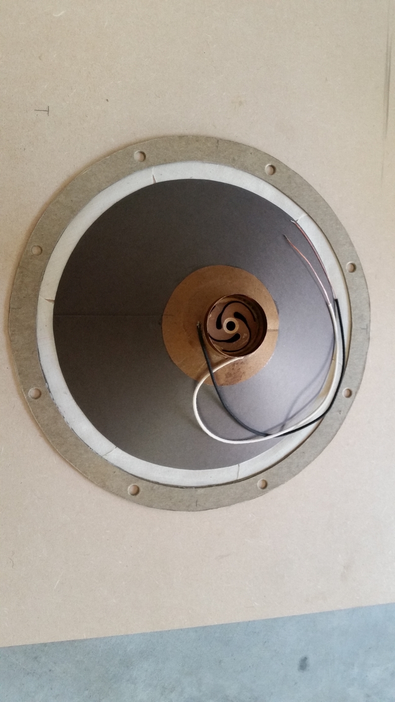

Holes were punched in the surround, and everything reassembled.
New wires were made up. The original wire was braided (presumably for flexibility). I approximated this with (if I recall correctly) 16 strands of #36 wire twisted together, and pulled through the cloth insulation stripped from some of the wire on hand for the project.
I was please to find everything went back together, and the cone centered nicely. With a 9V battery on the field coil, I fed some audio from a small portable radio. Success - nice clean sound!
