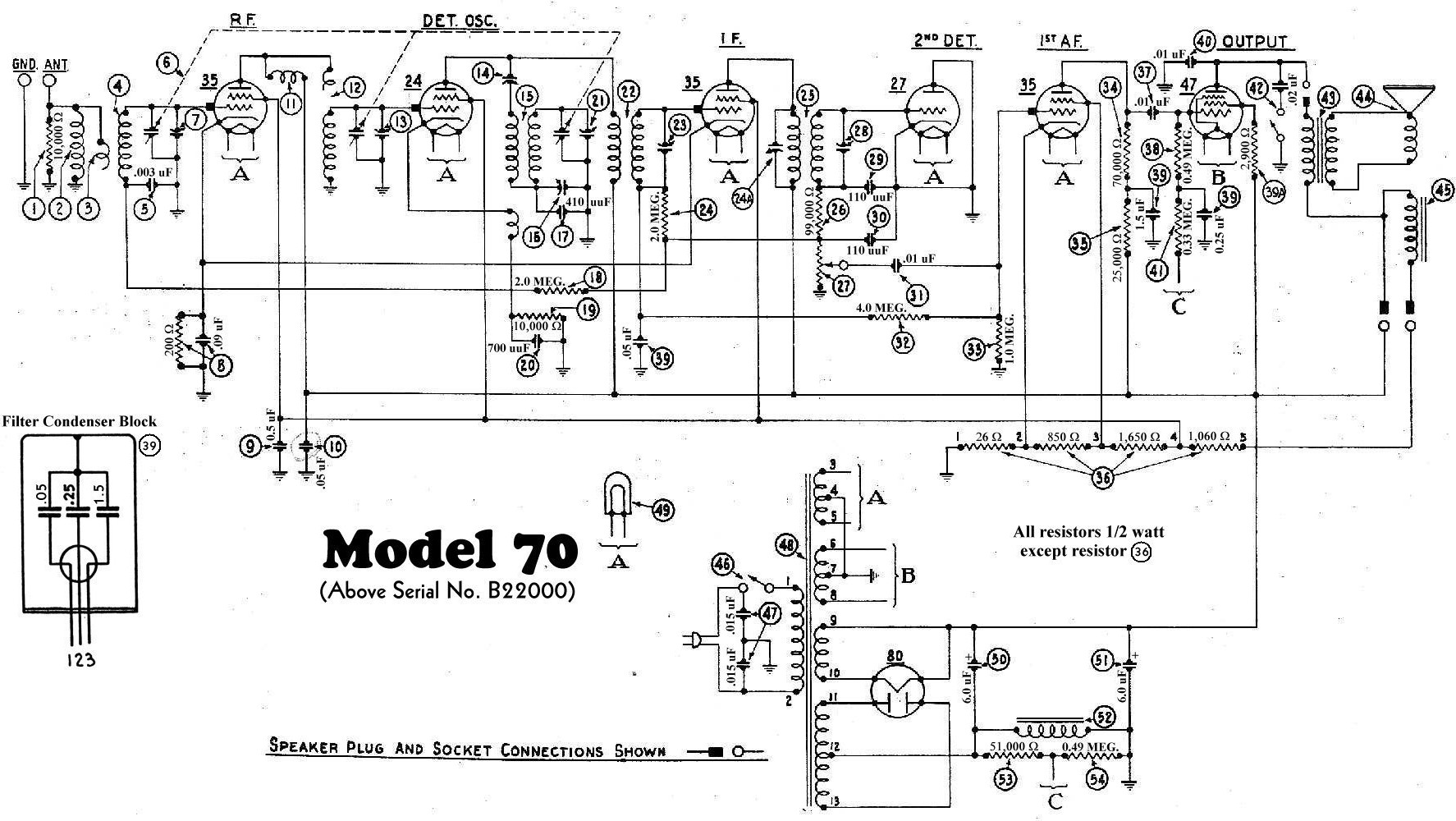

Have a question.. My radio doesn't have the .09 Cap # 40 that is across the 2 Filter caps 6 UF # 41 and # 38..
I know schematic says not used on all models.. But how do you know what models it was used on..
Is it really necessary?
[Image: https://farm5.staticflickr.com/4690/2468...1858_b.jpg]

That cap is used on units with serial numbers less than B22000. See: http://www.philcoradio.com/images/phorum/schem/70a.jpg (early 70 version schematic)
vs the later version schematic http://www.philcoradio.com/images/phorum/schem/70b.jpg

A capacitor used in this fashion is of doubtful usefulness. If the radio originally had cap 40, my advice is leave it out and up capacitors 38 and 41 to 10uf. The idea was to create a tuned circuit to trap out the 120 cycle ripple. The problem with this is, if the capacitor is off value, either high or low, it will actually increase hum. Other models used this capacitor also, I always omit them.

(01-07-2018, 12:17 AM)vecher Wrote: I know schematic says not used on all models.. But how do you know what models it was used on..
Simple...first look it over carefully. Does your radio seem to match the early or late schematic? Does your radio have any 35/51 tubes, including one as audio amplifier? If so it is a "late" version (above S/N B22000). Otherwise it is an "early" version (below S/N B22000).
At some point in early 70 production, capacitor (40) was removed as the bean counters at Philco deemed it unnecessary. As to when, I do not know. We could figure it out, but it would require everyone owning an early 70 to be willing to share their 70's serial number. As you know, that isn't going to happen, so why worry about the little things? Just know that your 70 was likely built after the bean counters declared that part (40) in your set was not necessary, and was no longer installed.
