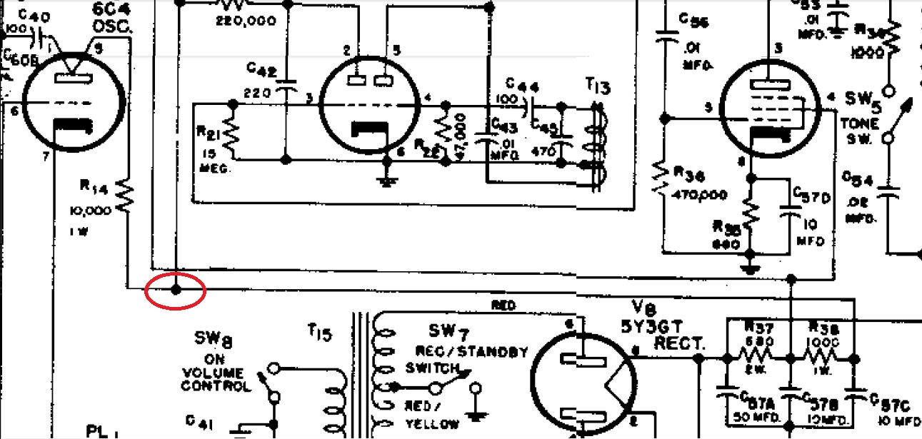

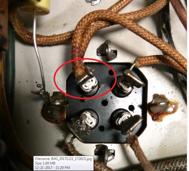

Although i have reconnected things,  i believe this is the junction you mention.
this junction would be the only terminal on my filter cap section i show in my previous pic where there are 2 wires.

when i power up, at the + side of C57c filter cap & 1kohm resistor R38 i experience this.....
radio warms up and meter shows voltage ramp up to about 325v, quickly the voltage ramps down to only 55 or 60vdc.
radio has no output.
if i leave the set on for more than 20 seconds the 1kohm resistor will overheat.
terry,
I disconnected the two wires at C57c.
my voltage settles in at around 230vdc when i leave this branch open that feeds pin 5 of the 6c4.

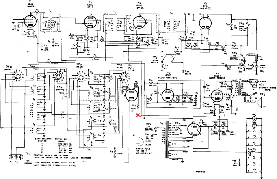

For those of you who are watching at home after several phone calls and digging into the schematic we found that this HV distribution is wired slightly differently than the schematic. There was another wire connected to C-37C feeding the 1st and 2nd IF amp's plate voltage. Schematic shows this wire connected to C-37B.

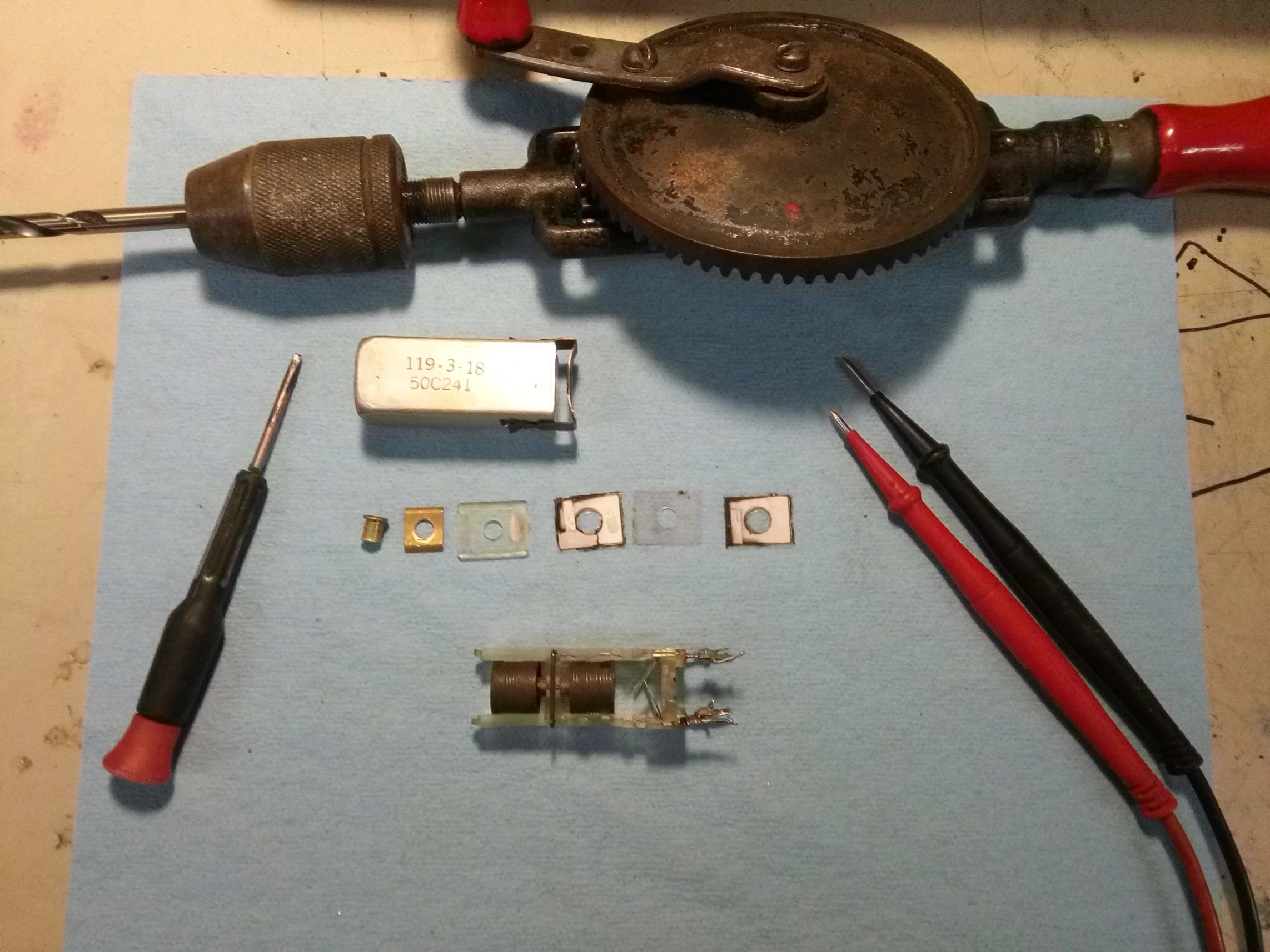

The problem ended up being a low resistance path across T-10 the 1st IF transformer. From pri to sec was about 1.5K this applied + 200vdc to the control grid 1st IF amp tube V-2. It didn't like that! Caused the tube to draw excessive plate current pulling the HV down.
I'm thinking that the two fixed caps in the IF can are shorted from silver migration, but that is yet to be seen. We do know that the IF transformer has resistance from pri to sec which it shouldn't and there is a high + voltage on the control grid of the IF amp.

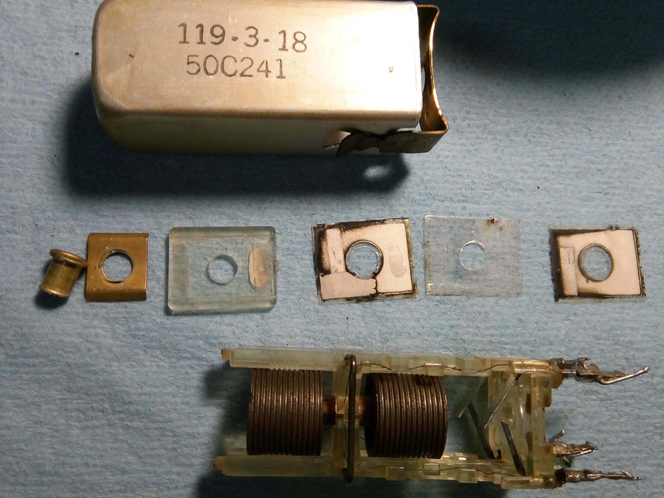

it just occured to me (sunk in) that the only way the IF can have resistivity between pin 3 and pin 1 is through the caps.
by design, its a single mounting pad but 45% of the pad on the left and right are allocated to each separate cap. the gap in between is getting full of crud that bridges the pri and sec coils.
I know i have to remove the rivit.
i will take the first IF apart again.
I will see if i can rake a dental tool along the gap to remove anything that bridges these two caps.
basially hoe out any debris to separate the two sections.
i was so confussed becuase i found it nearly impossible for the pri coil to be touching the sec coil, now that i see the flaw in the cap design, two caps under one roof, i get it now.

You need to remove brass rivet and remove the thin mica sheet. Cut the metal tabs that are on top of and below the mica sheet so they can not short together. The issue is that the mica becomes contaminated from the metal tabs. This changes the mica from an insulator to a CONDUCTOR. So the mica has to go as do the tabs that make up the fixed capacitor. Once you get that done measure the resistance from pri to sec, should see no resistance between the two coils. Then reinstall.

not only is there signs of strikes and deterioration, there is a hole blown right through from one mica cap to the other passing through the clear spacer.
came apart really easily, I am thinking of using very tiny caps to bridge the tabs.  I would like to install the caps right inside the can and space the tabs so that i dong cut away any lead length that may have contributed towards the alignment.  .. otherwise i will just mount the caps down under the can.
I really dont like these caps!
any thoughts on hand making a gimick capacitor for this applicatioin? I have some very tiny wire if it is acceptable?
