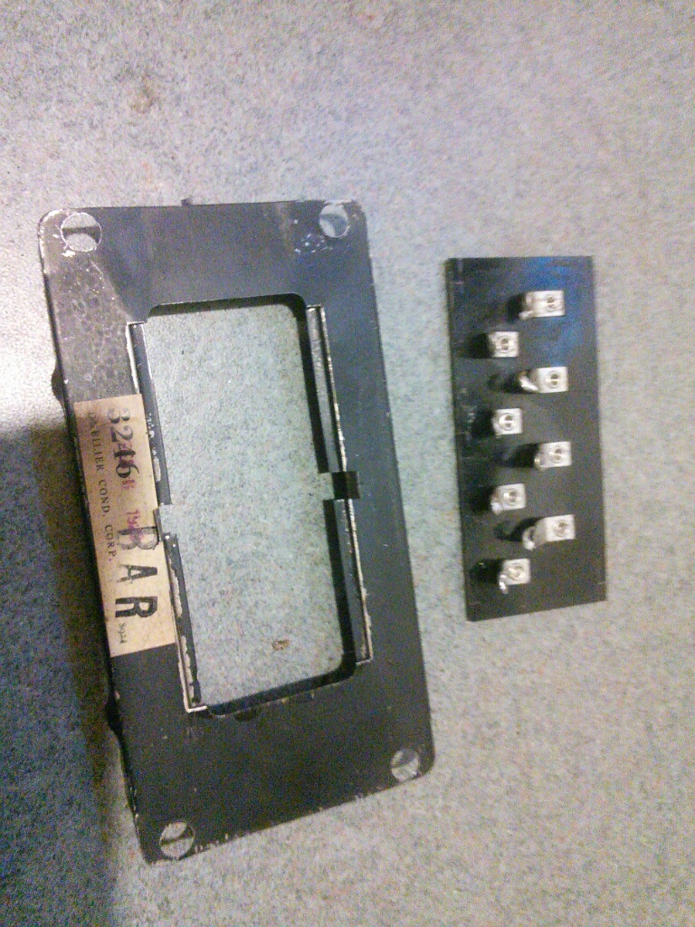

Tomorrow will attempt to open the large can. I did that before with 111 chassis and that wasn't too bad: I didn't scrape it much or warp it and was able to keep the terminal board. With some luck I could repeat it.
After watching Buzz' video where he extracts the cap can and has to demo!ish the panel to get inside it, I decided to tinker with it.
In about 10 minutes with some patience I was able to produce this result:
Now to emptying the can. I hope it is the same as with 111, which proved to be a bit easier than 20.

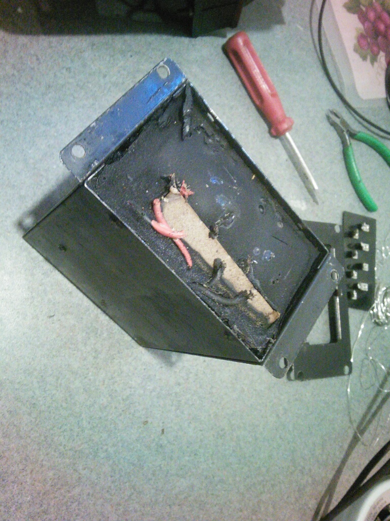

My strategy will bee to really feeze it overnight, with the large screw (the one I bought for the same purpose for 111) fully in.
Then I will attempt briefly immerse it into boiling water, using the screw as the handle.
My hope is that the thin metall shell wil quickly heat up and expand while the frozen tar block will remain frozen, and the two will separate. I think I should hear some clicks and pings while this is happening. Not more than a few seconds.
If it works, that will be a good technique to empty these boxes.
I don't think there is a danger of sputtering or explosion with this.
Another way is heat it with a gun but somehow I think it is not going to be efficient.
I tried it with over 3hrs freszing and boiling pot.....no, nope, no dice.
OK, will try tomorrow again.

This can is an entransigent lil'bugger. I have emptied 4 cans, a 20, another 20, a 16 anda a 111. But this one was refuses to be disemboweled.
I might try heating when it is warmer outside.
