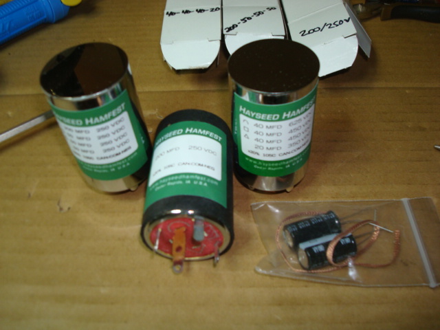

I pulled the trigger on some Hayseed caps. The more I thought about it, the less I liked the idea of having a bunch of caps stuffed under the chassis. To restuff may be an option, but not on this unit. FYI, the Dynacos have bias problems on their ST70's at least, so it's not just Fisher. The mods available for those amps can drive you nuts. I like the Dynas too.
Tim
Look what showed up in the mail today! Boy, do these babys shine! Still doing some research, but maybe at least I can get started with the recap.
