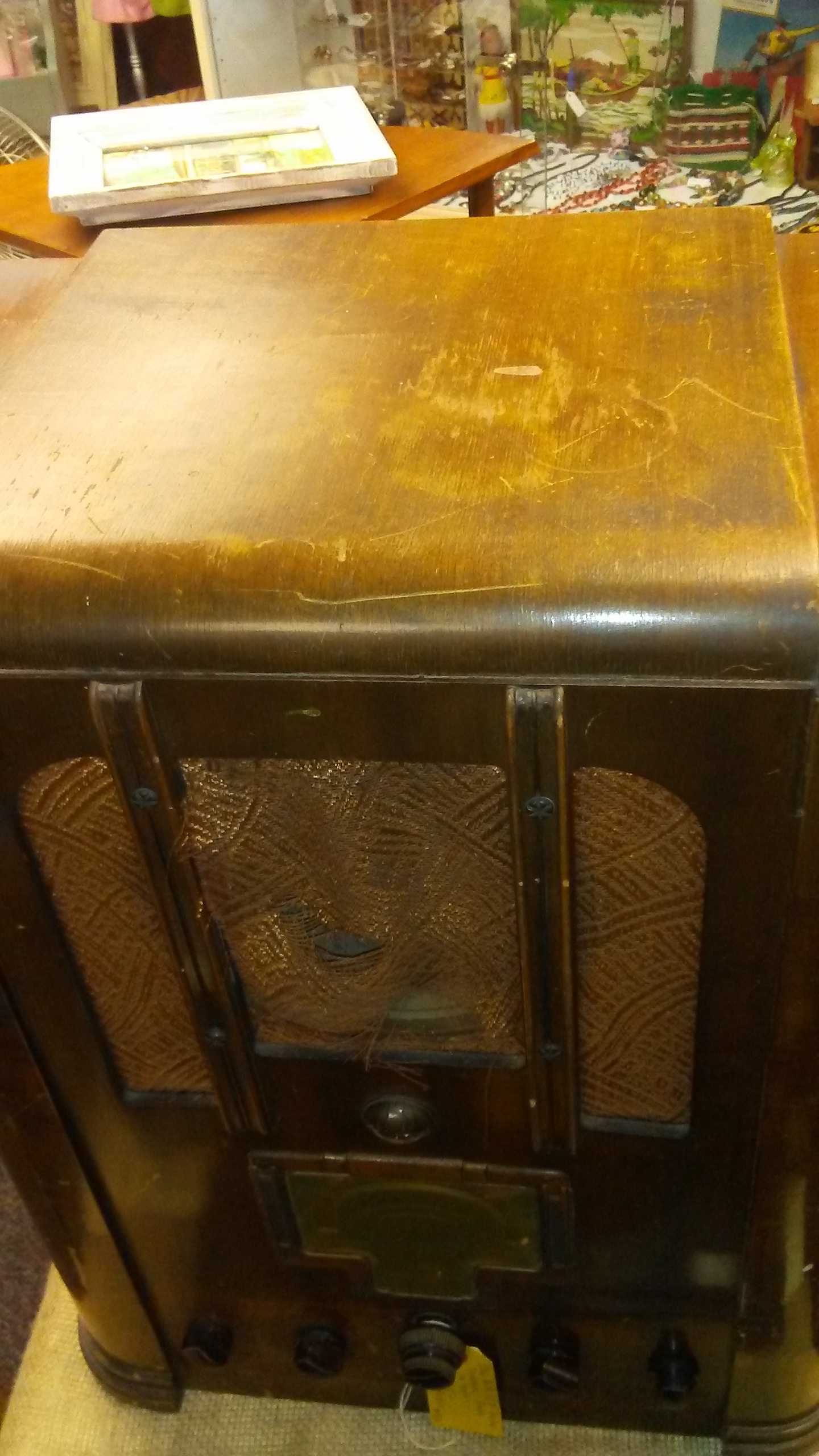

More pictures
I wonder if he would ship it?

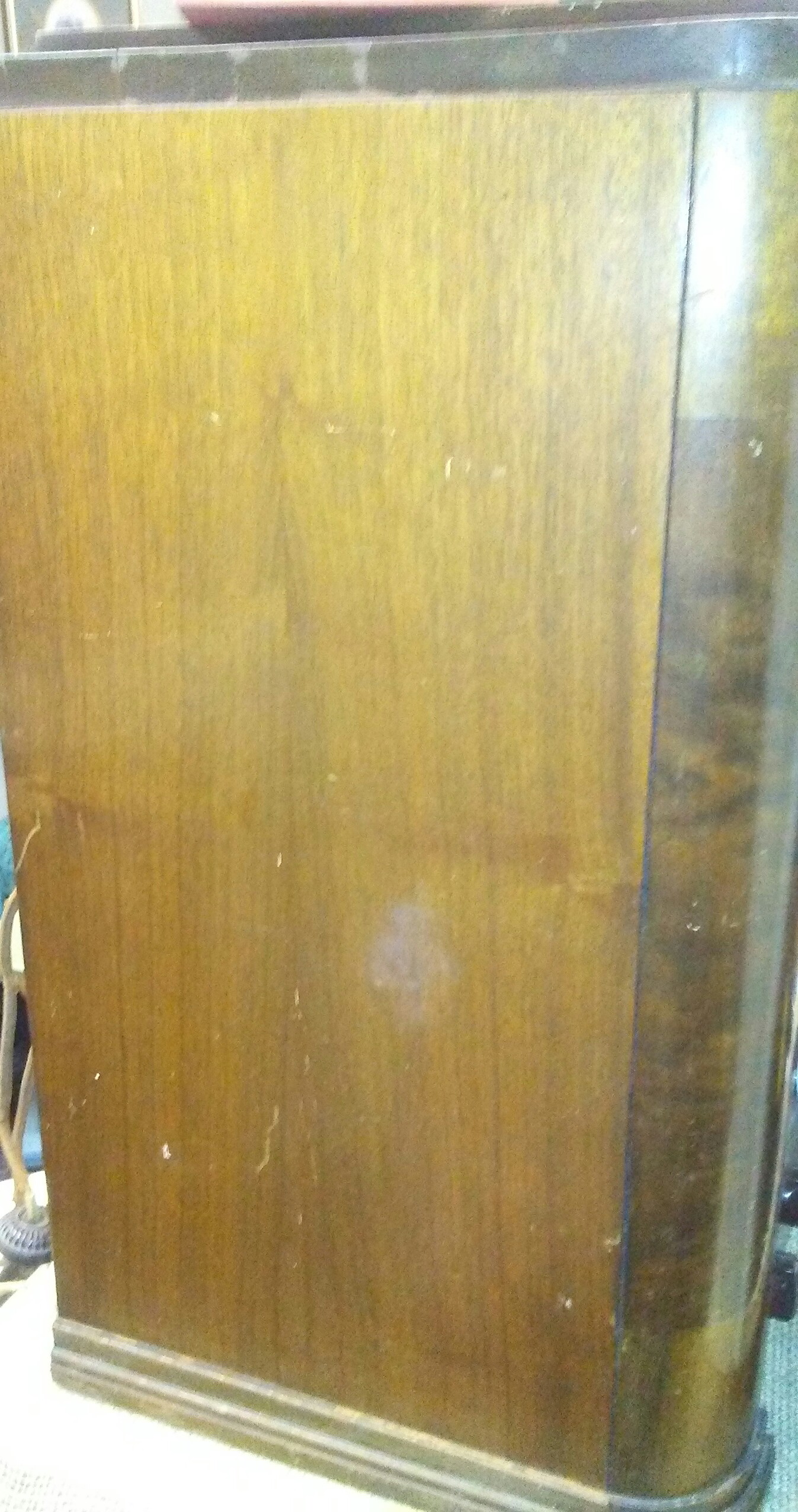

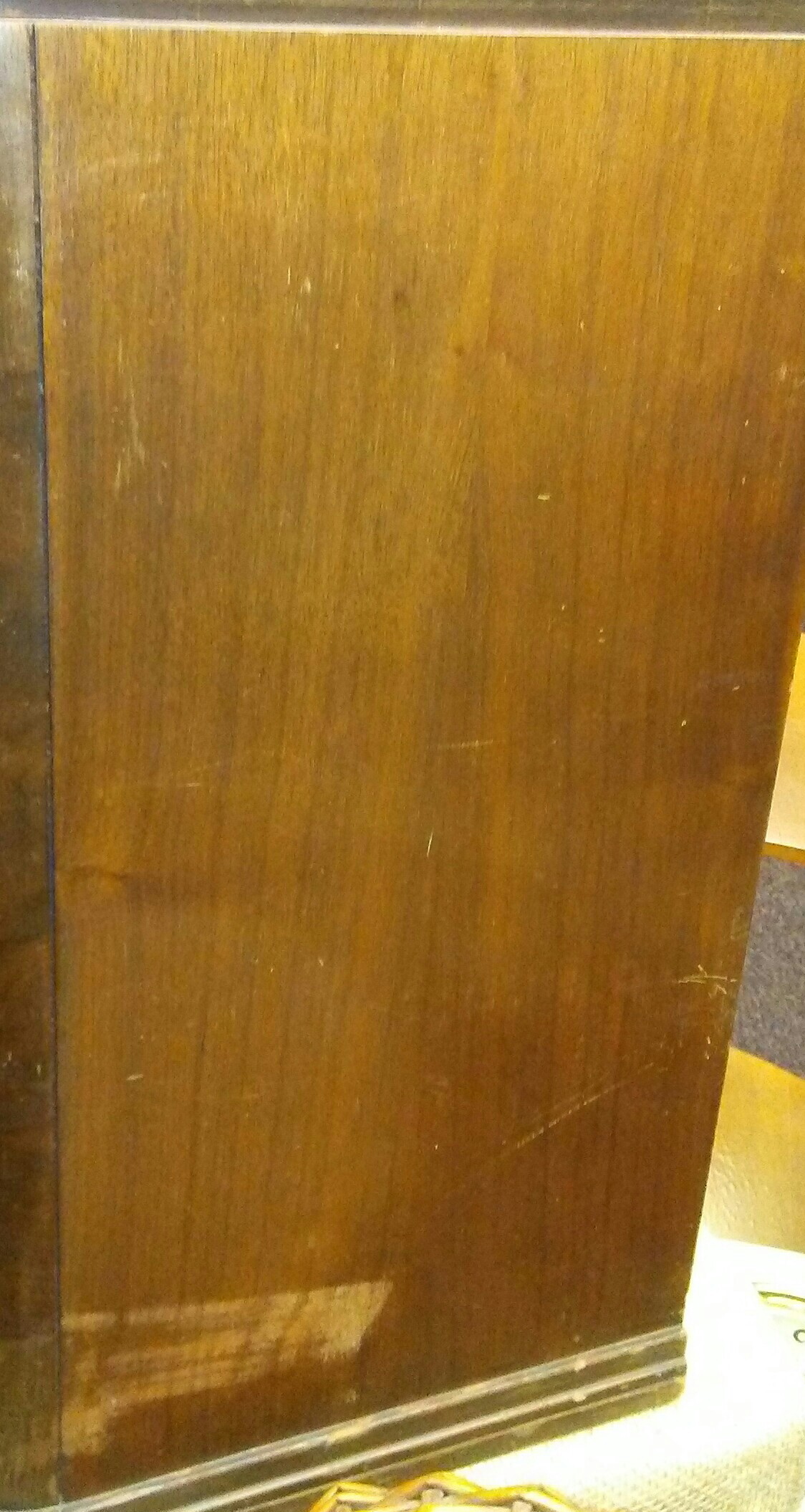

the other side
tried to post this side 3 times now...

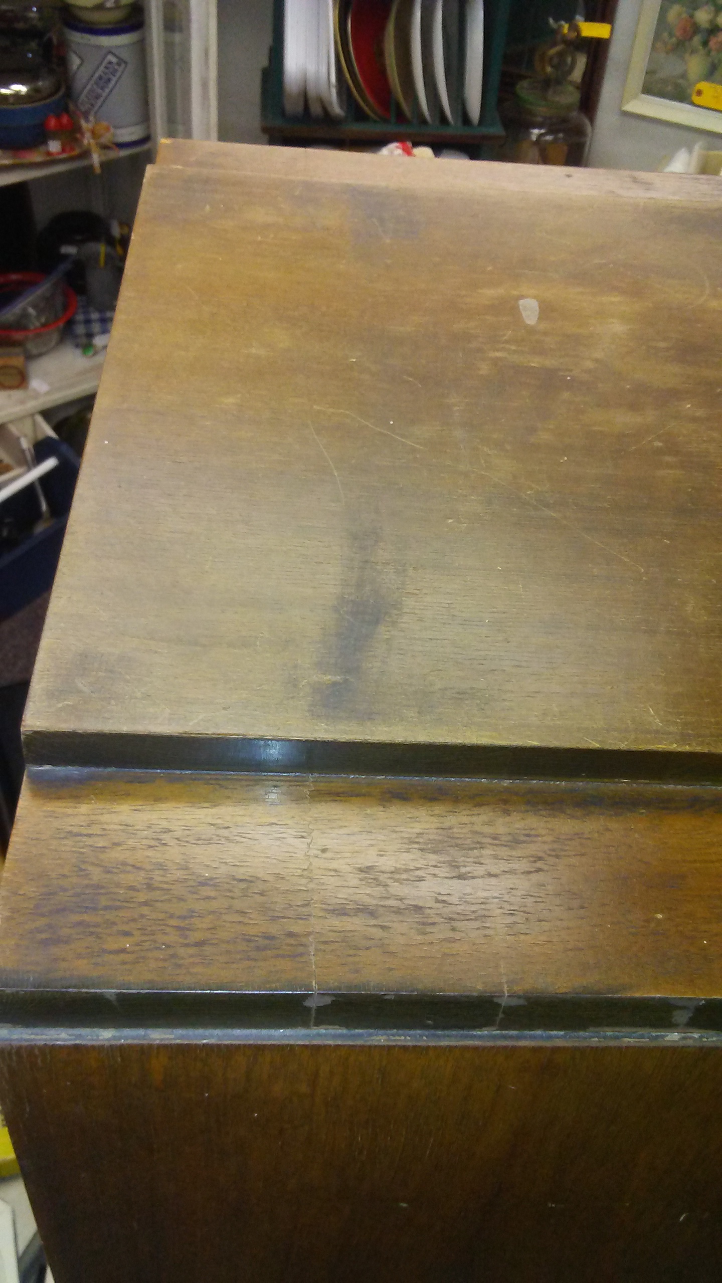

That crack really spoiled it for me
Yeah, veneer alone won't fix that. But it is fixable.

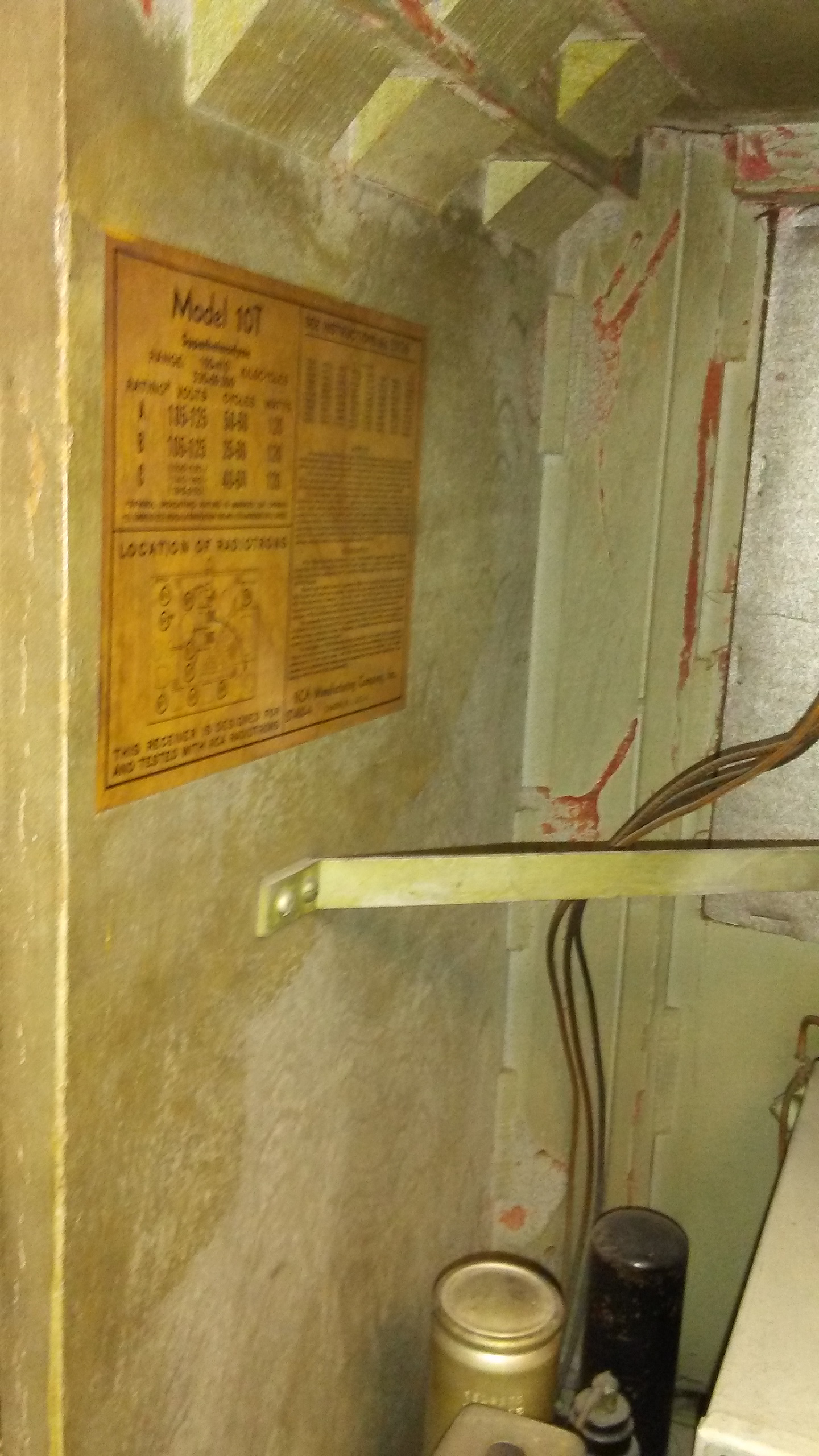

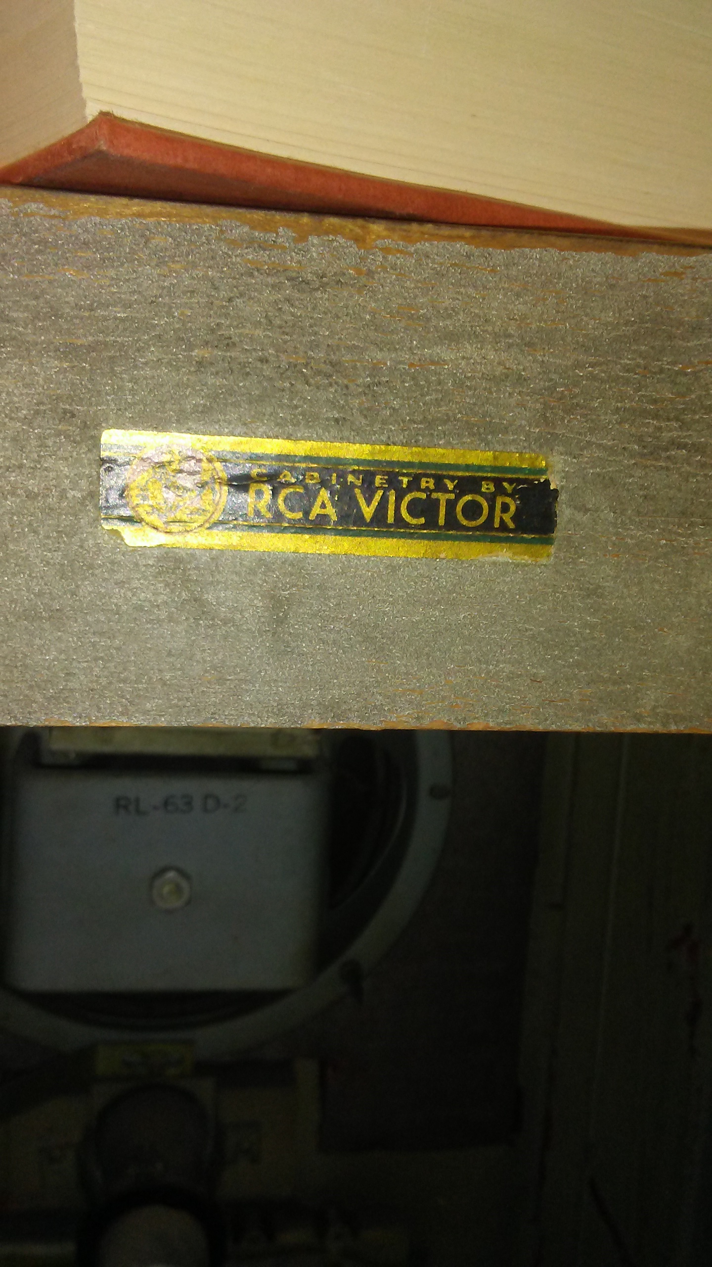

    Stickers for the masses:

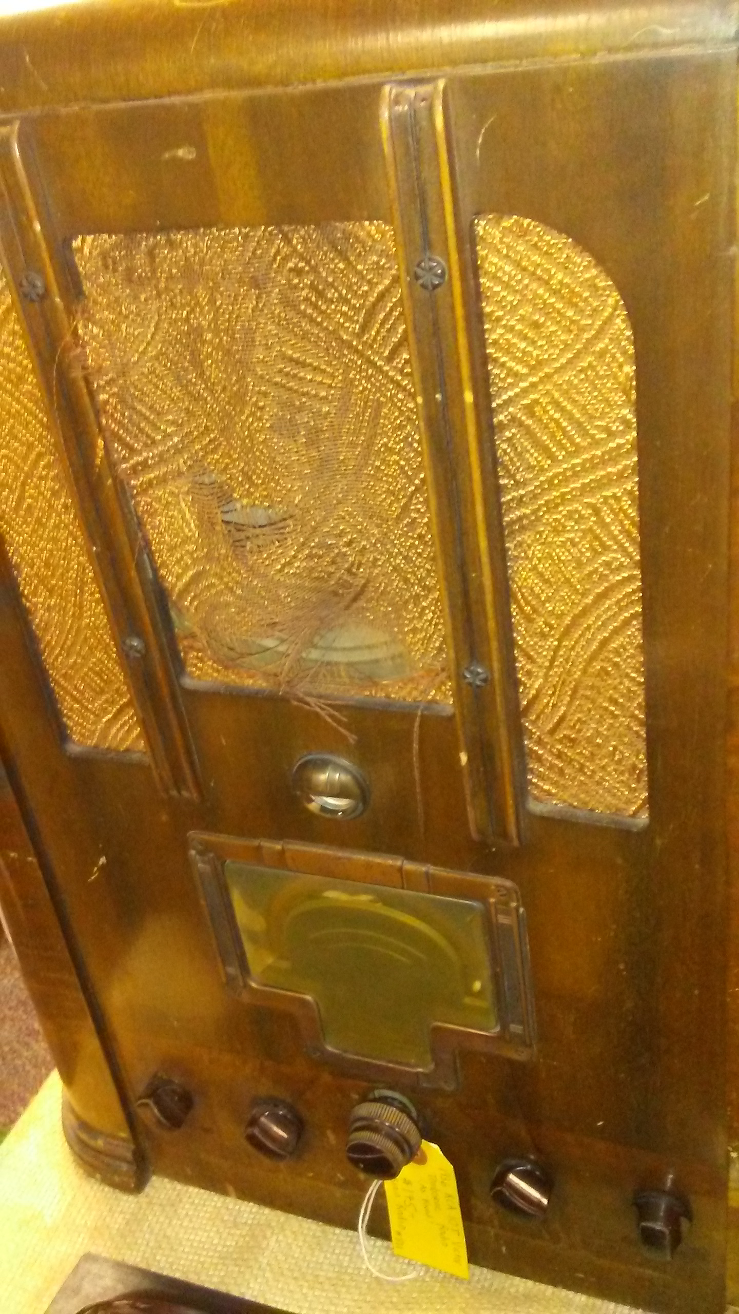

one more for good measure
It is defiantly worth getting, but it will need a complete refinish, speaker recone and the chassis is probably going to need some wire. It has the classic deer t*rd caps and the "Magic Brain" is a little hard to align.

The main issue will probably be the wiring, I'm not convinced that changing out the mica caps is really necessary. In spite of what they claim on the barking dog forum I haven't experienced any more problems with those black, coffin shaped, mica caps then I have with any other type, so unless they are falling apart, or every other more common problem has been ruled out, I leave them alone. So what is the issue with the speaker? I see that the grille cloth is torn a bit but was the cone damaged too? To me it looks like a very restorable set, even that cracked veneer on the shoulder doesn't look too bad, though I wonder why RCA's cabinet makers didn't just use a single board from back to front rather then using laminated stock? I guess it was to use up left over material?
That crack is in the step down section where there is a solid piece of wood and it looks like maybe could be replaced by someone who knew what they're doing in that area (NOT me). Don't know if it's a solid block of wood with veneer over it (that's what I thought it was). Offer up $50 for the set and see what he says???
