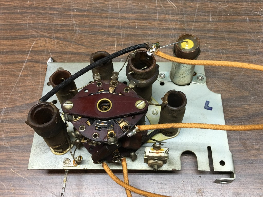

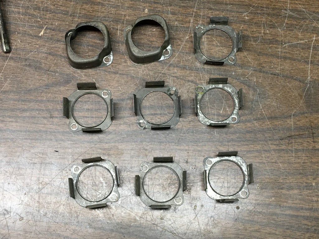

I decided to gather up some replacement tube shield bases to replace those which were missing from the tuner chassis.
I had several, but they all had varying degrees of rust.
Upon Bob Andersen's recommendation of Evapo-Rust back in 2013, I bought a gallon of the stuff last year. Now I had a good reason to try it out.
It worked very well indeed:
[Image: http://www.philcoradio.com/images/phorum...90_052.jpg]
I will be using the 1937 shield bases. This way, any future owner may easily use any type of tube in the sockets - G, GT, or metal.

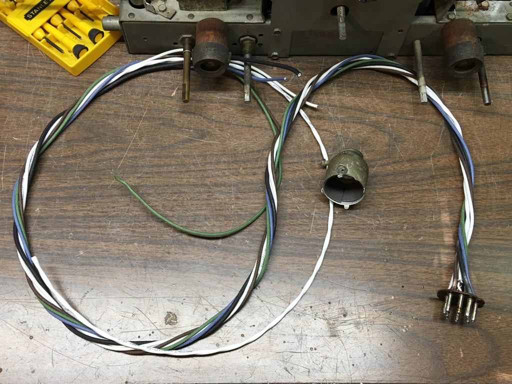

I need to replace the interconnect cables.
Why?
One of them feeds into the chassis with no strain relief...no clamp...no grommet. And the chassis had cut into the wires, leaving bare spots.
The other interconnect cable uses a clamp to hold the cable in place, oddly enough. But the wires of that cable looked to be rather dried out.
So, using a micrometer, about a month previously I had carefully measured the individual wires of the interconnect cable with the 10-pin connector (power leads). The four filament wires (two pair; one red, the other black) were both 14 gauge.
The wires for the power switch were 16 gauge.
The other wires were 20 gauge.
Cloth-covered wire I had on hand already could be used to replace the 20 gauge wires. But I had to purchase 14 and 16 gauge wires for the job.
These were found at a place I had never heard of, which sells cloth-covered wires for the vintage automotive crowd - Tom's Engine Barn.
They filled my order in a reasonable amount of time and soon, I had all of the wires I needed for the 10-conductor cable.
I also had to order a two-conductor cable with shield for the other interconnect cable (the audio cable). This I purchased from Mouser.
[Image: http://www.philcoradio.com/images/phorum...90_067.jpg]
After some twisting of wires...
[Image: http://www.philcoradio.com/images/phorum...90_068.jpg]
[Image: http://www.philcoradio.com/images/phorum...90_069.jpg]
Both cables also received an outer braided covering purchased from Antique Electronic Supply. It's plastic rather than cloth, but it looks good.
Once the cables had been made and slipped into the braided coverings, I attached the individual wires inside the tuner chassis.
For the audio cable, which has no clamp or strain relief (and never did), I put a rubber grommet into the hole before passing the cable through the hole, to help protect the wires from what had happened to the original wires.

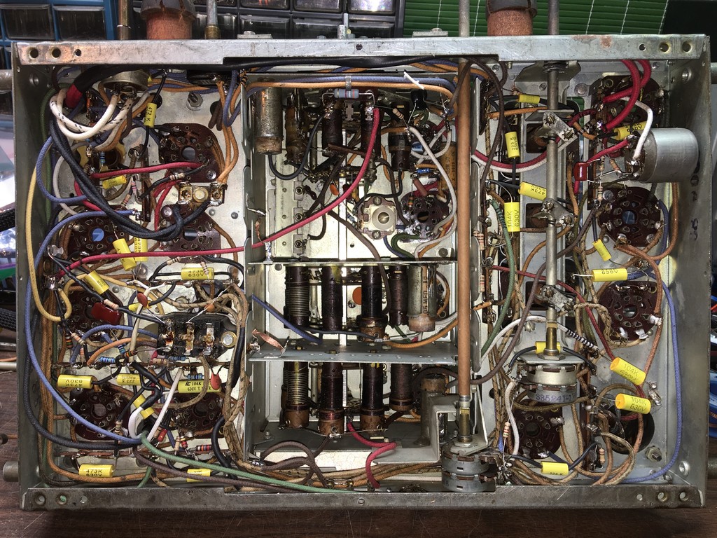

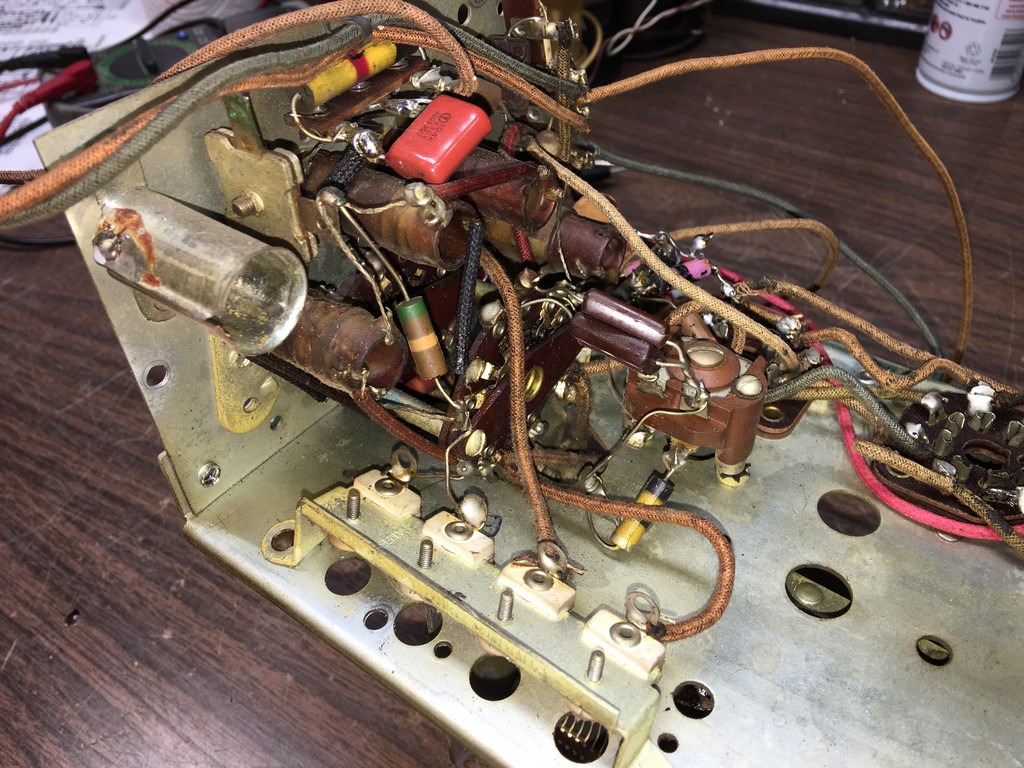

I've finished recapping and recarbing. Under the chassis, things now look like this:
[Image: http://www.philcoradio.com/images/phorum...90_071.jpg]

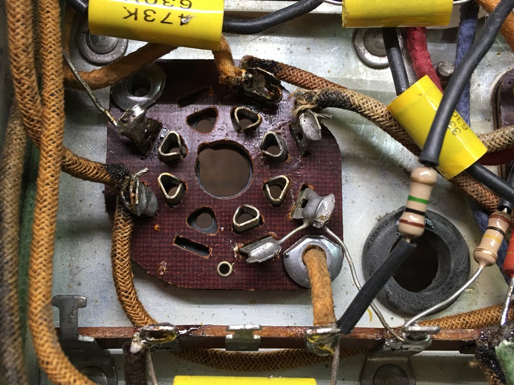

You may recall that I had mentioned earlier that I needed to pass a wire through a rivet hole for the 1st audio (6R7G) tube. With many thanks to Ed Locker for the idea, I used a 3/16" aluminum pop rivet to attach the tube shield base and tube socket to the chassis. I then used a nail to drive the aluminum nail out of one of the pop rivets. A new cloth-covered wire then fit through the rivet perfectly.
[Image: http://www.philcoradio.com/images/phorum...90_070.jpg]

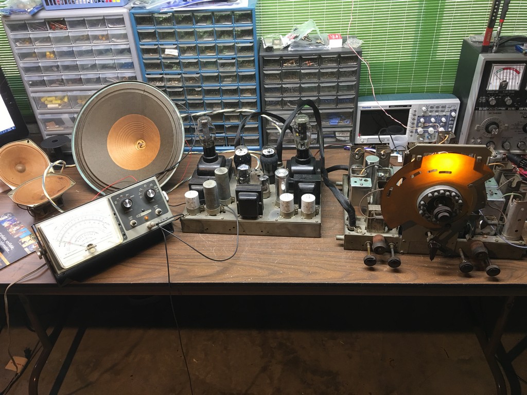

But I had to know...was the fault in the RF unit as I suspected, or somewhere else within the radio?
So...I set the whole thing up (both chassis, woofer, and both tweeters) on the workbench and tried it out.
[Image: http://www.philcoradio.com/images/phorum...90_072.jpg]
With the 690 set to band 1 (AM), I fed a 470 kc IF signal into the grid cap of the mixer tube.
Guess what...the signal came through loud and clear.
While removing the signal generator lead from the grid cap of the mixer tube, I happened to notice that when I touched that grid cap with my finger...I started hearing AM noise!
So I connected a temporary antenna to the mixer grid cap and found that I could easily tune in my home AM transmitter (but nothing else on AM). I was also picking up some faint signals on one of the SW bands - Band 3 or 4, I think.
A-HA! I was right - there was a problem in the RF unit!

So...while I had the thing up and running, I went ahead and aligned the IF strip.

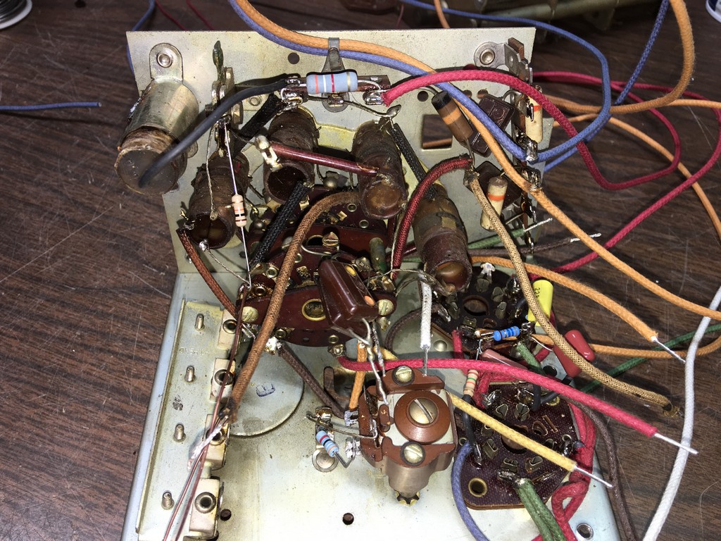

I begin taking apart my third RF unit.
The RF tube socket will need to be replaced to avoid a potential carbon track - part of the Bakelite is broken away on the bottom side.
I will also have to rewire the sub-base as the original wiring doesn't look the best.

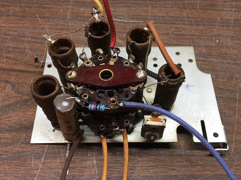

By this evening, I had the antenna unit redone:
[Image: http://www.philcoradio.com/images/phorum...90_073.jpg]
and the RF unit:
[Image: http://www.philcoradio.com/images/phorum...90_074.jpg]
All of the coils in these two units have good continuity...but from prior experience not just with this Philco, but other 1937-38 Philcos as well, I know that that alone does not always equal proper performance from all bands. I'll need to clean the heck out of the band switch contacts, however, to (hopefully) avoid the same issues I had with the second RF unit.

Only the oscillator unit remains, along with the sub-base.

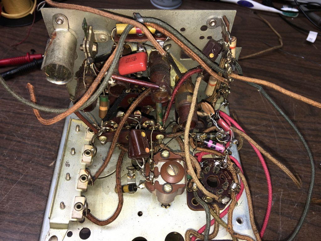

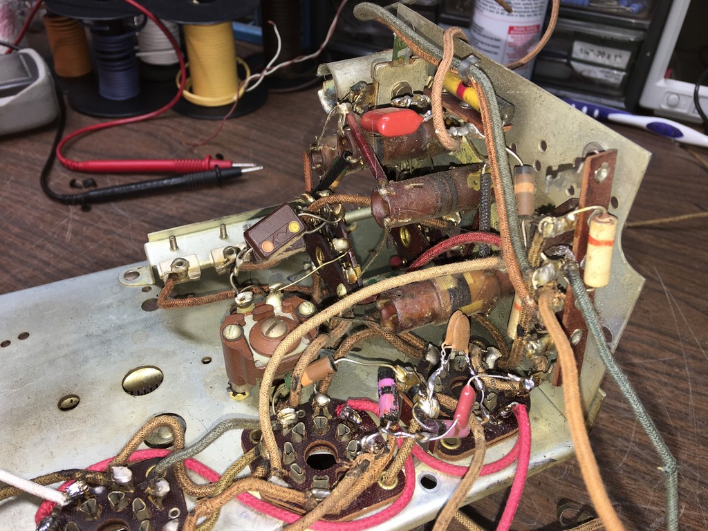

[Image: http://www.philcoradio.com/images/phorum...90_075.jpg]
[Image: http://www.philcoradio.com/images/phorum...90_076.jpg]
[Image: http://www.philcoradio.com/images/phorum...90_077.jpg]
You can tell from these photos why I am replacing the wiring.

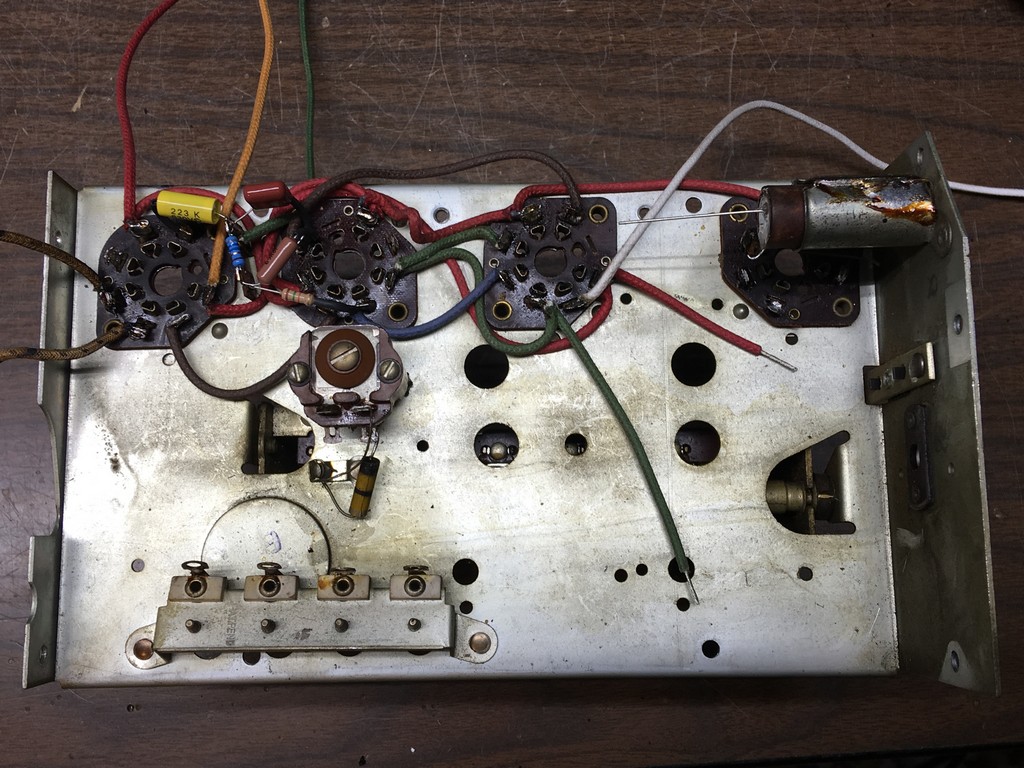

I started the day by finishing up the sub-base:
[Image: http://www.philcoradio.com/images/phorum...90_079.jpg]
I replaced the RF tube socket, wired it up, and replaced resistor (38).
