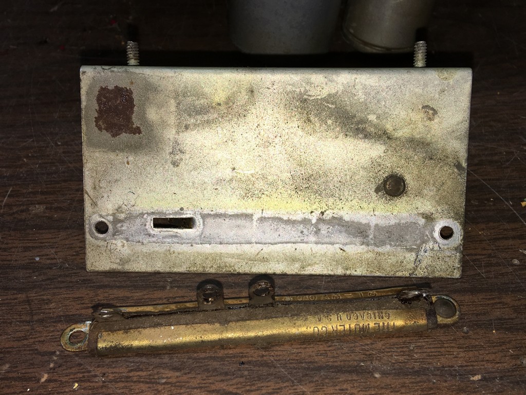

Having decided to replace both Candohms, the first order of business was to replace the one mounted on the piece of metal running front to back under the chassis. This was R16-R17-R18.

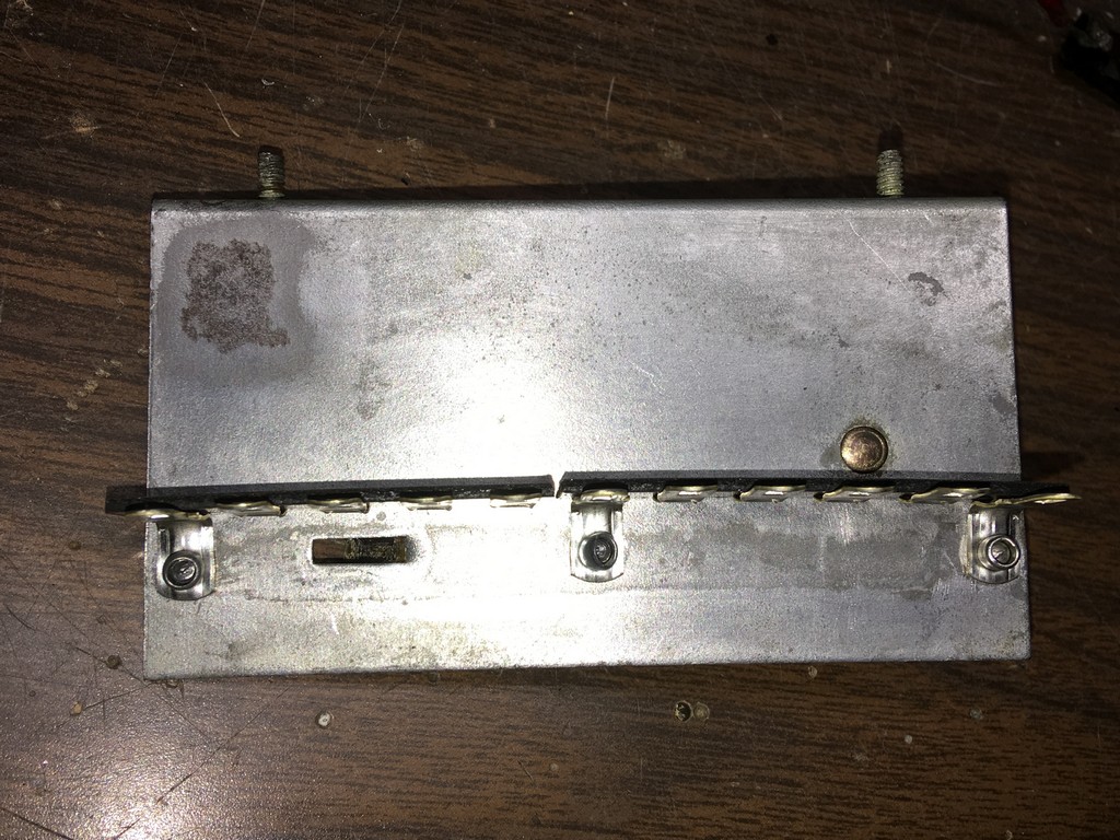

Then, after removal of the old Candohm, I installed two terminal strips in place:
[Image: http://www.philcoradio.com/images/phorum...-5_015.jpg]
After this, the piece of metal was reinstalled in the chassis to see how things looked:
[Image: http://www.philcoradio.com/images/phorum...-5_016.jpg]
Then I removed the metal piece again.
[Image: http://www.philcoradio.com/images/phorum...-5_014.jpg]

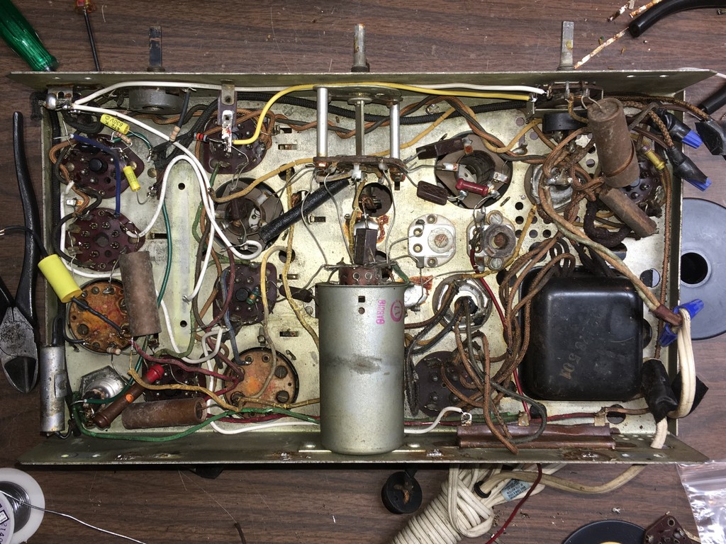

The chassis now looks like this:
[Image: http://www.philcoradio.com/images/phorum...-5_017.jpg]

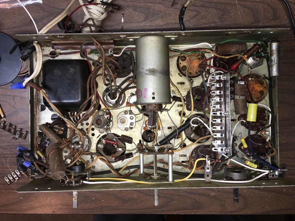

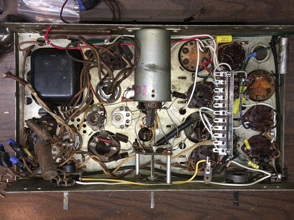

Photos from last night, as promised:

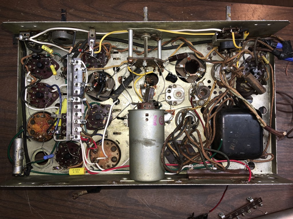

First, here is how the chassis now looks after the work I did last night.
[Image: http://www.philcoradio.com/images/phorum...-5_018.jpg]

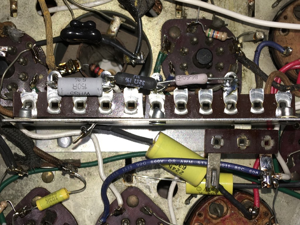

A close-up of the new replacement for the three section Candohm:
[Image: http://www.philcoradio.com/images/phorum...-5_019.jpg]

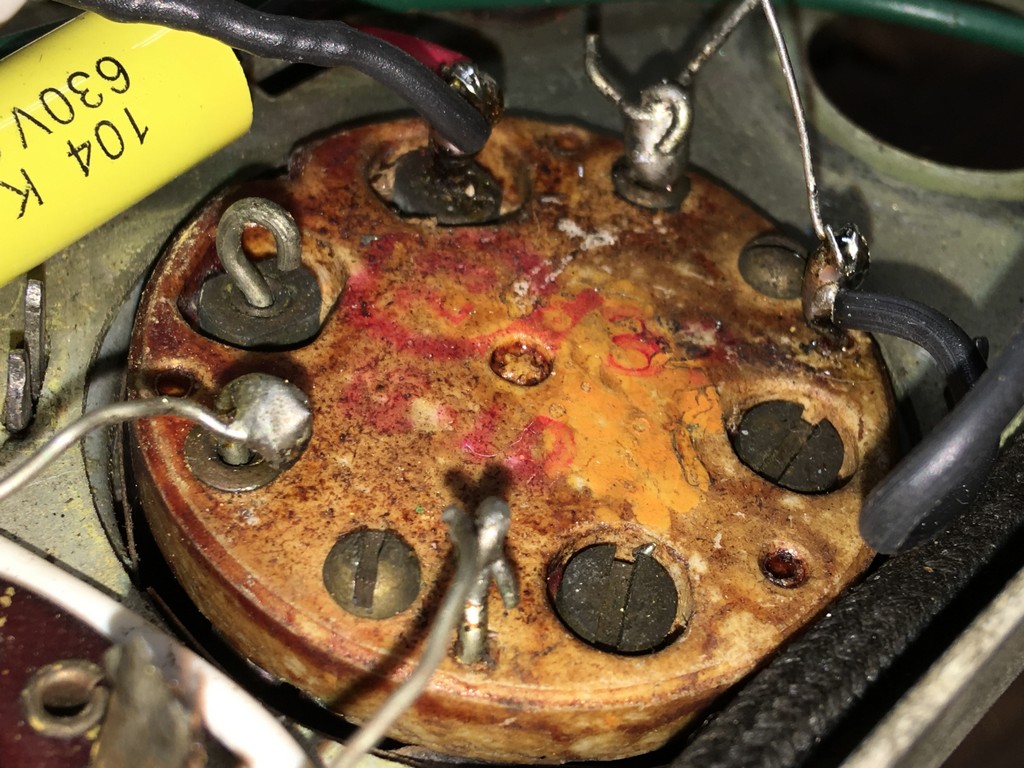

And Arran, I had promised this photo for you back in post #16, top of this page - here is a close-up of the underside of the 2nd IF transformer, showing the J-hook connections:
[Image: http://www.philcoradio.com/images/phorum...-5_020.jpg]
